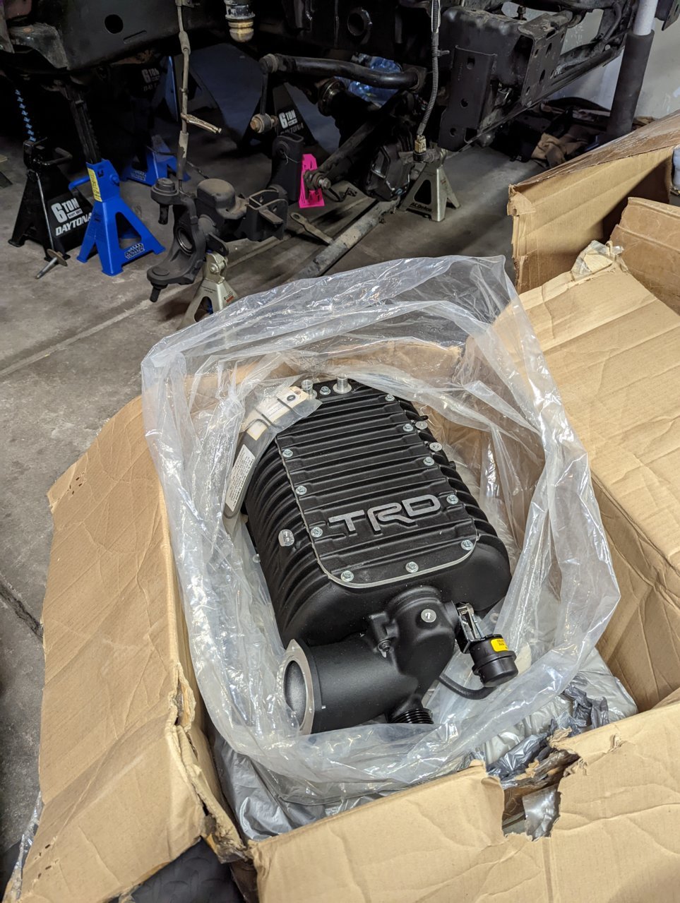

    Delivered! This thing is massive. Now I gotta buy the fit kit. Can't wait!
