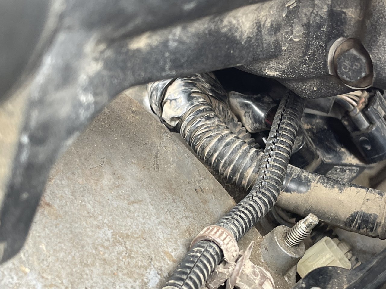

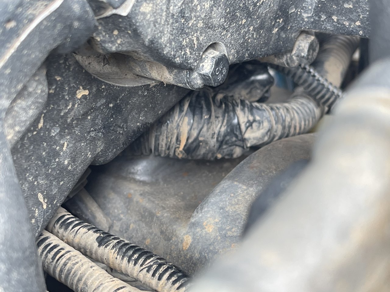

    @12TRDTacoma or others @SUMOTNK and I are trying to get the RIPPs in sans removing to blower but ram into this harness in the front drivers side and it looks like it’s pinched by the blower. Any tips or does it look like we have to remove the blower anyway?

    I just tugged with care on the harness in that section until it came free.

    It wasn’t moving we’re deep into it now. Mind as well do a few more things

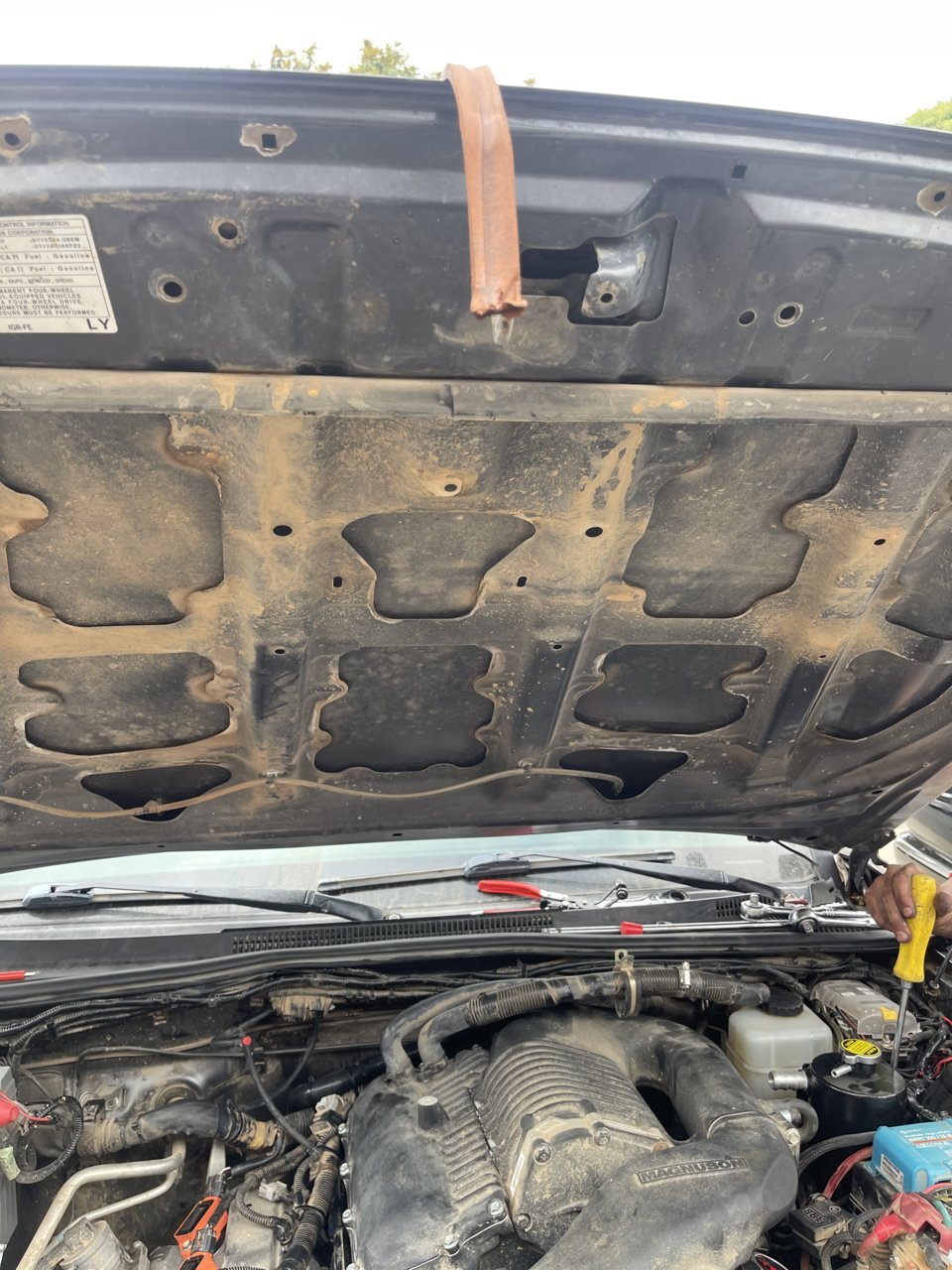

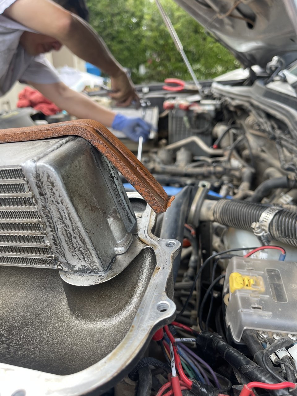

    Yah that was the goal. The seal looks good. What do fold use to seal it back in?

    Do you need to drain coolant to change heater hoses?

    i mean you gonna drain coolant regardless if you do it on purpose or not

    Do you guys really just ditch the vibration seal deal?

    I've never installed mine. It's meant to force air into the intercooler.
