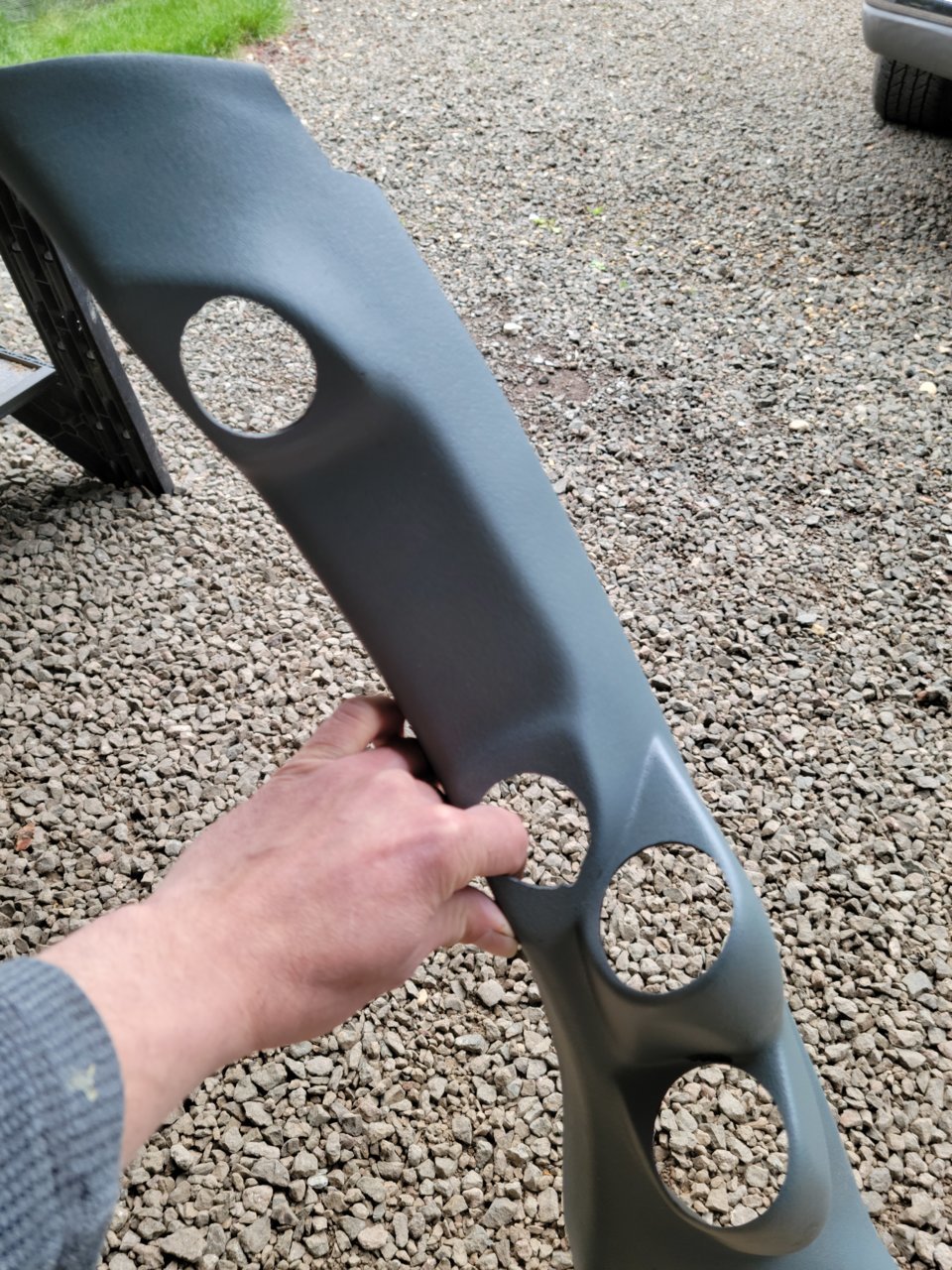

    I'm (mostly) satisfied with my Lotek 2-Pod Full Pillar. The color match is close enough. The biggest issue I had/have was/is fitment, that required a little Dremel work to optimize. IIRC, I had to tweak one of the gauge holes to seat the gauge and both mounting holes for the handle required adjustment. The gauges ended up fitting pretty well, but the handle will never be perfect.
    Looks great! I'd like to do it with my UG. I sent the guy a message, but no response so far. :(

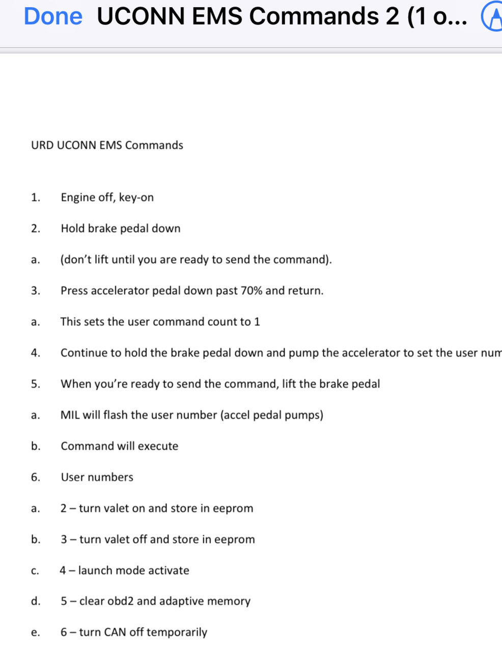

    Don’t you still have UCON? Just turn the ignition to on, puMp the accelerator pedal 5 times and start the car.

    That's cool! I didn't know there was some shortcut/ macro on the UCON. I'm usually cruising in 5th gear and it trips a MAF voltage or o2 sensor so I just complete the reset while driving. I haven't had Scott take a look at it since I was lazy. Been trying to put the short headers and new obd2 sensors on before I have him log on and scan it for further issues.. I also have a weird laggy obd2 response as well. Not sure if that's an URD issue but I haven't been able to run any OBD2 reader/gauges because it is that slow or laggy.

    I didn't have fitment issues with mine, but I do agree that the color is off somewhat. But... it does become a little closer to match after a few weeks baking in the sun. There was a freshly painted smell on mine when I fisrt opened the shipping box, and a few days later when I did the install, so I think maybe the paint has to cure. So far none of my passengers have noticed the difference in color, at least they hadn't said anything to the matter.

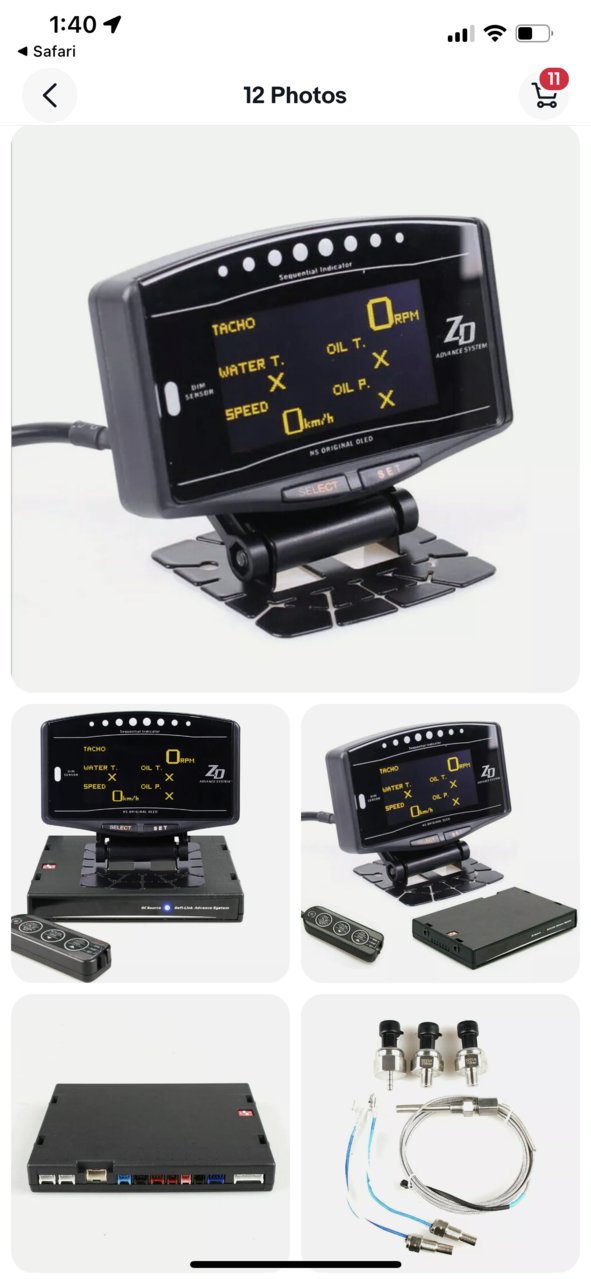

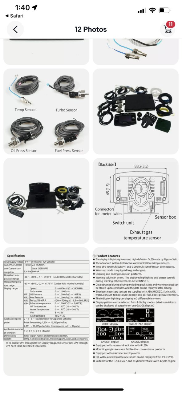

    I think that product is a lot of fluff and not enough blow. Almost a dressed up ultragauge.
    Feels like you'll need to tap for a few of those sensors. If you have to pay for labor, after all is said and done, you'll probably be better off monitoring through HP Tuner or even iDatalink Maestro.
