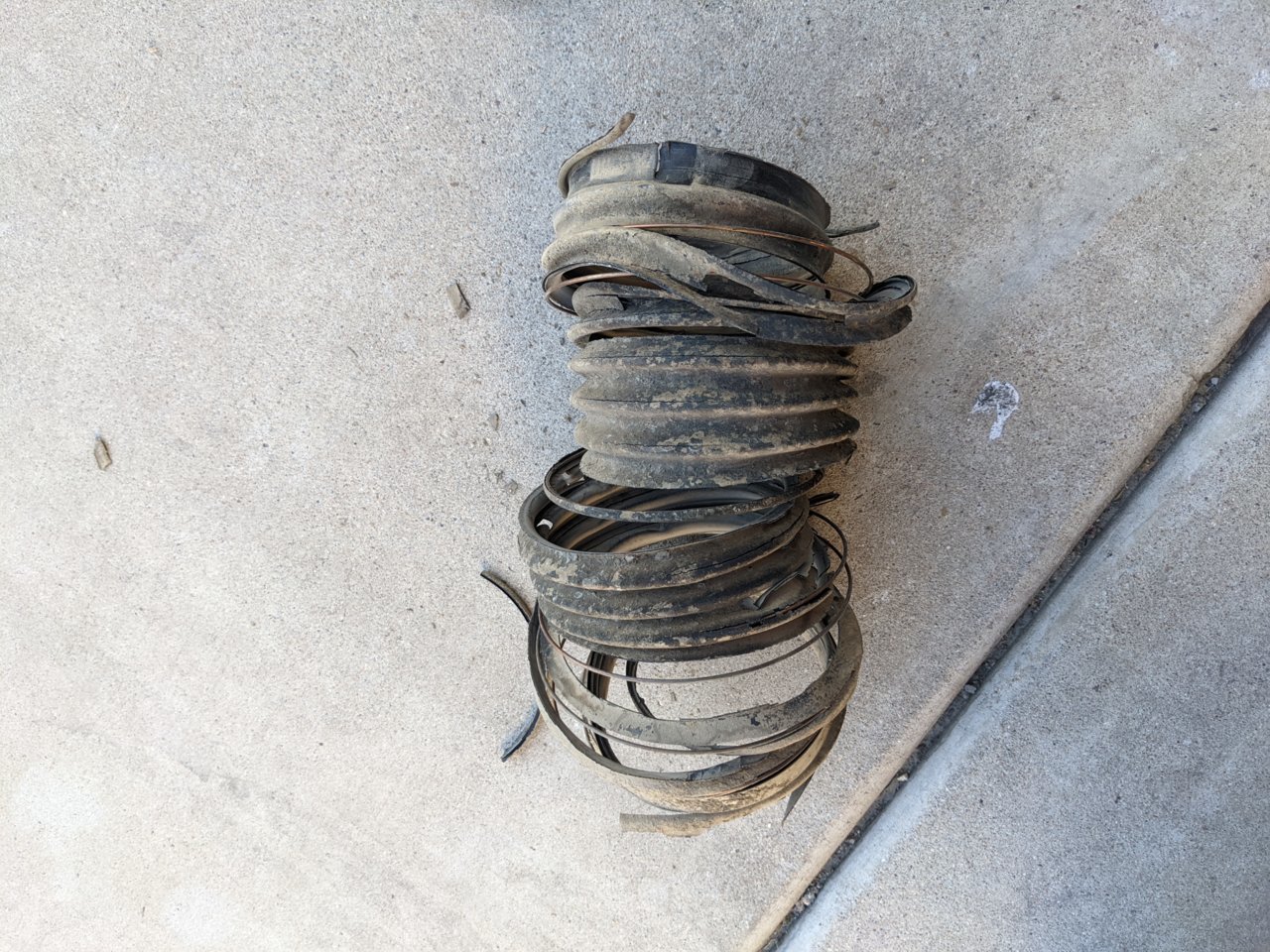

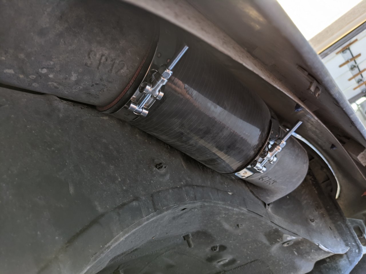

    Truck might be a little happier now.. lol was doing some maintenance and checked the original Airflow snorkel tubing and it cracked as soon as I touched it.. then just started crumbling apart in place.
    Old snorkel tubing.
    New 4" ID silicone coupler

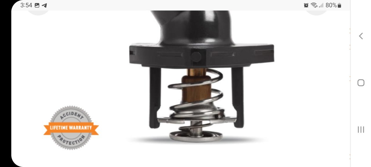

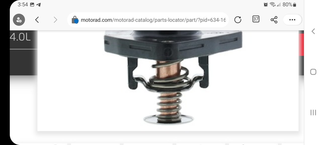

    Got a 160 thermo from rock auto for 42$ shipped. Glad it’s not made in China

    Torspd Custom Turbo kit [] Borg Warner 9180EFR Turbo [] Haltech Elite 2500 [] TiAL Q BOV [] TiAL V44 Wastegate @ 15psi [] CP Pistons [] CP Carrillo Rods [] ARP Head studs [] ARP Main Studs [] ARP Header - Head Studs [] Ported Heads w/ 1mm oversized valves intake/exhaust [] Brian Crower Forged Stroker Crank [] Darton M.I.D. Sleeved Block [] Kelford Camshafts [] Torspd 160* T-stat mod [] APR Large Fuel Rail [] Walbro 460 LPH E85 Fuel Pump [] FueLab FPR [] APR T56 Conversion Kit [] KP RACING Built T56 [] McLeod Racing Custom Twin Disk Clutch [] One Piece Aluminum Driveshaft [] MGW Shifter [] Custom lowering kit [] Ohlins Front Coilovers [] QA1rear shocks [] Custom Ron Davis Radiator [] Dual SPAL Electric Fans []
    I wonder how this one does compared to the Mishimoto.
    Keep us posted on what your coolant temps are, and what your ambient temps are please.
    Slight differences.
    Mishimoto
    Motorad
    Norton and 12TRDTacoma[OP] like this.

    Definitely a different in the springs being used.

    I may try that Motorad. The price is appealing. About $25 cheaper than the Mishimoto that I have.
