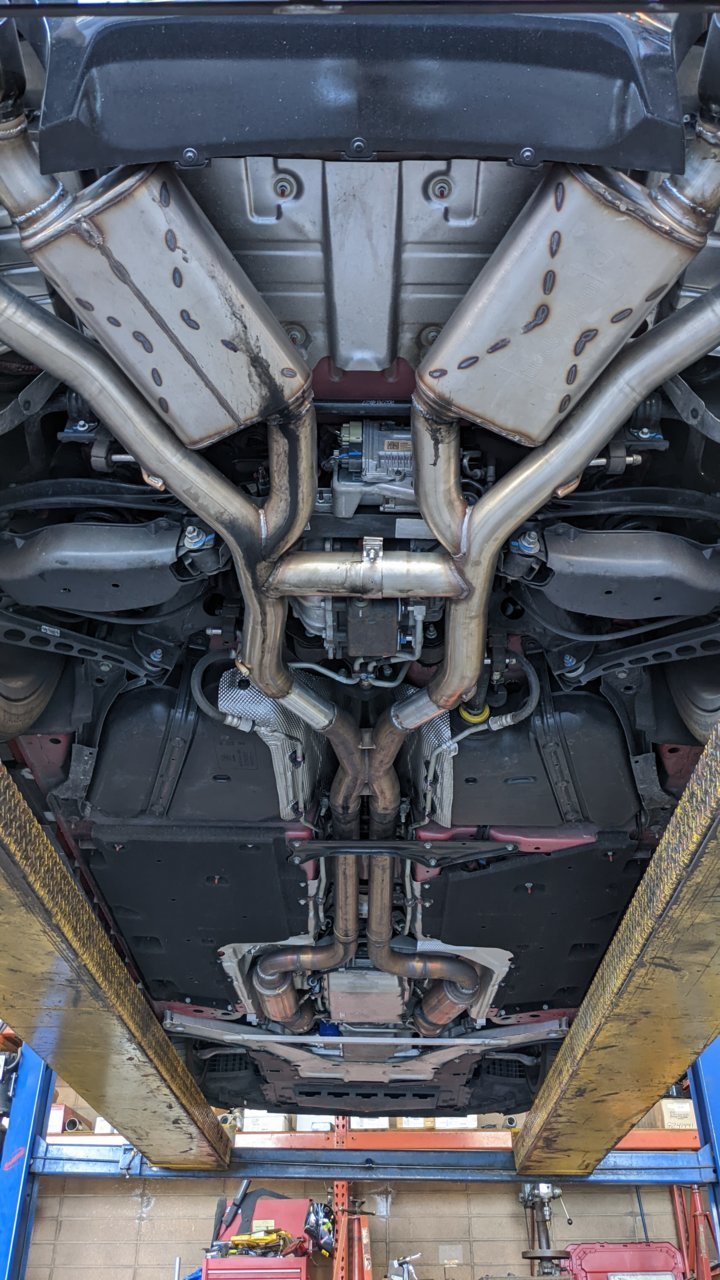

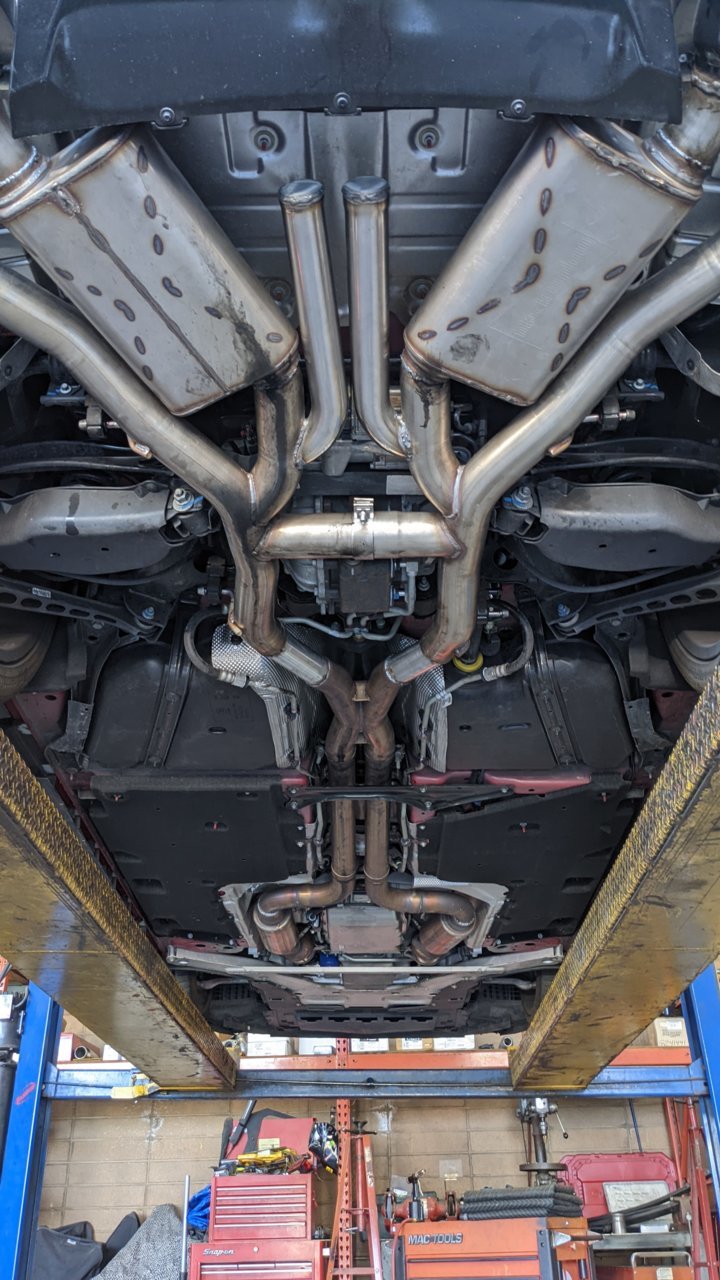

    Getting some J pipes done on her today to defeat this last bit of drone that remains.
    Ignore the dirtiness. It was leaking for a week while I was getting the rest of the system sent to me. It's been sealed. :D
    EDIT: All done and drone is about 98% gone now after adding in some sound deadener in select hollow locations of the trunk and backseat. I'm very happy with the outcome! :)

    I've been seeing these J pipes on the more popular exhausts for the Tundra too. What exactly do they do to help with drone? I've never seen them before a few months ago.

    This is a Helmholtz of sorts. @scootter82 it helps cut down drone if any exists if a user is otherwise happy with their sound setup by allowing a portion of the gasses passing through to go in the pipe, travel all the way up it, then back down and out it's original path without disturbing airflow as a whole.
    Apparently A LOT of the Camaro aftermarket exhaust setups minus Borla and Corsa induce drone. If you go with any other type of mufflers there is a high chance you will. A lot of it has to with the fact that the metal that they use in the trunk and the backseat area is very hollow and not insulated in any way, shape, or form from the factory.

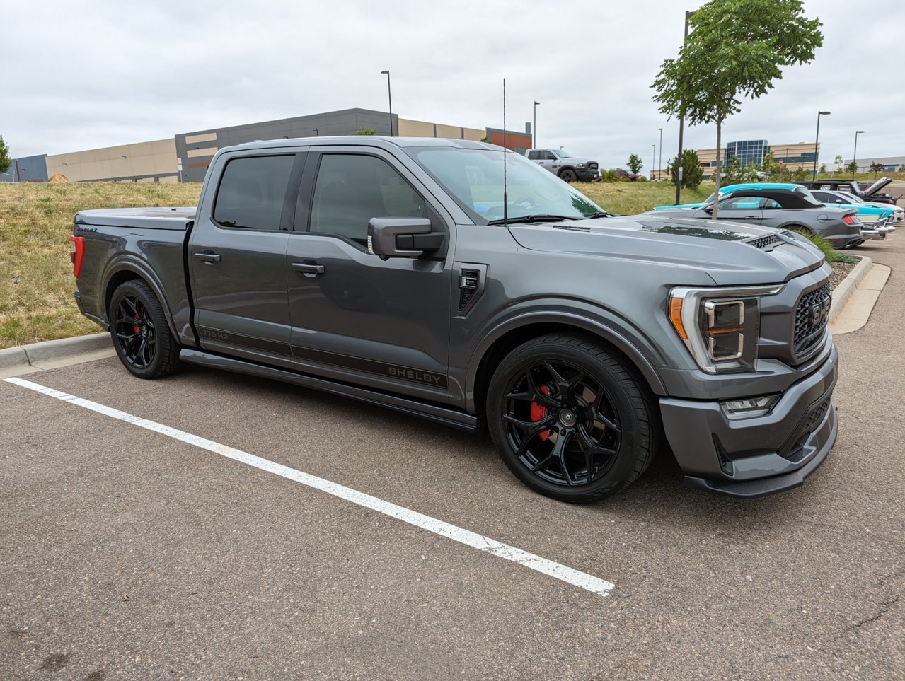

    Any of y'all know if the Shelby F150 is 775hp at the CRANK or the WHEEL? As far as I can tell from articles it says "engine delivers 775hp" So I'm assuming crank...I just want to make sure my Tundra will be a Shelby killer lol. Dyno numbers on the built s/C's put it around 500+ so crank should be around 700(?)
    Saw at espresso & exhaust this morning

    It might be capable of some 680 but you gotta factor in how heavy it looks and based on how pig-ish it looks I'm going to say it indeed IS a pig.
