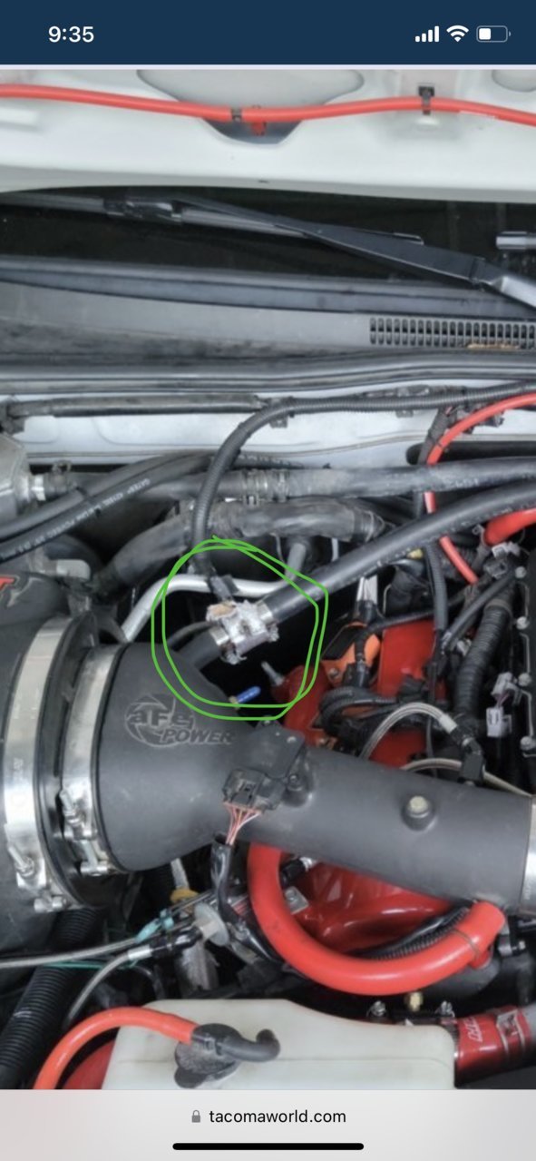

    That a temp sensor?

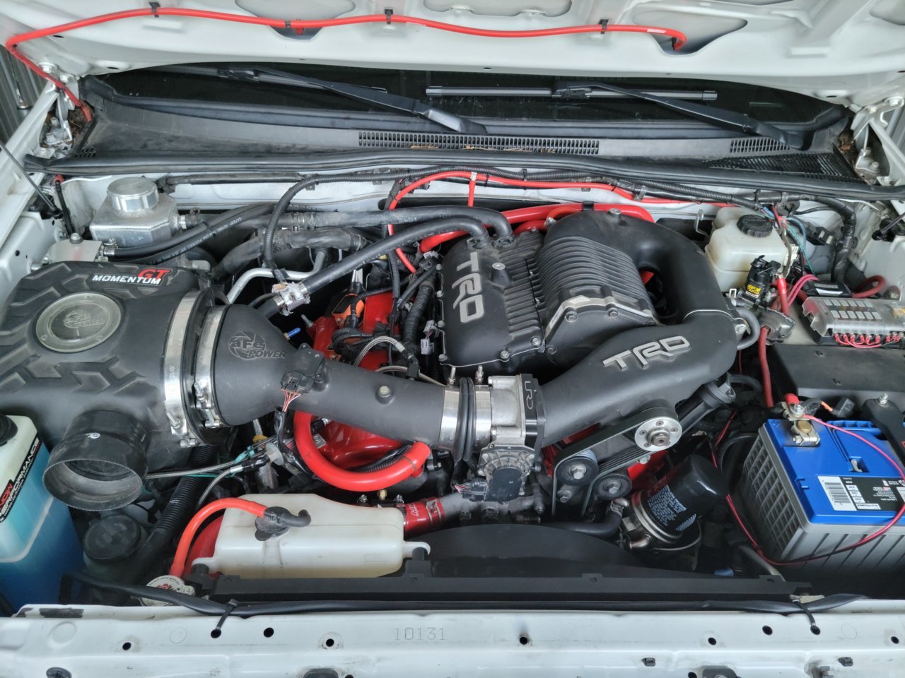

    good eye. yes. i wanted to monitor my s/c coolant temp. typical is 14* above ambient post heat exchanger. iirc the fitting is a brass unit from autometer with an aem temp gauge.

    i was curious how effective the heat exchanger was with weather change. it really does well. wanted a starting point for data leading other ideas.

    That’s cool! Really well, as in stable though weather changes? How long have you been monitoring it?

    quite a while. i did see a change in cooling ability with straight distilled water and redline water wetter. glycol is my thing in winter but for hot months i change. noticeable difference. 15-20% better/lower intake water.

    basically the heat exchanger magnuson made for this truck works fine....where i live. i cant be certain about other areas of the country.

    Nice I’ve been thinking about adding one to see how much it cools. I always wonder how the S/c is cooling

    ive done both in and out of the intercooler. incoming is a much more stable # to follow.

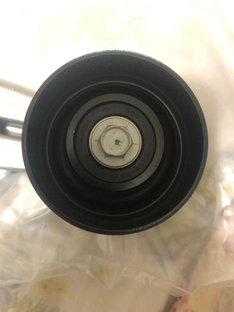

    I just bought the rousch tensioner. Do you remove the bolt from the pullie like the serpentine belt tensioner? reverse?
