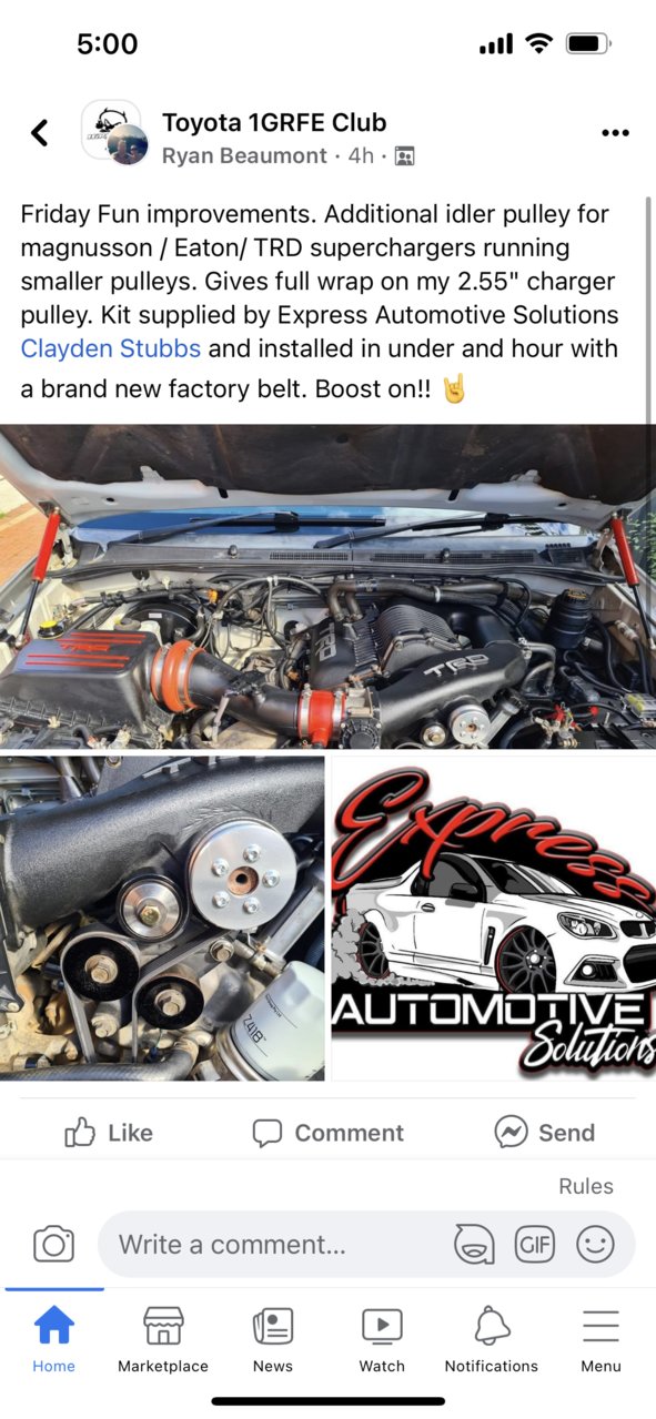

    Saw this posted online. The guy wants $150 plus shipping for the idler. Seems like a lot. Wish we could find one to

    looks like one ive seen here. my first question is pics of the mounting assembly. that design produces a lot of stress and new angles. is it strong enough? recc. belt size? im just leary of asking that of a five rib belt. after cams i think i hear, my belt burning. my spit shot reservations.

    That might be in Aussi dollars. So but be decent after shipping costs

    I had a couple up for sale were you looking for the pulley rap mod? I used a couple washers to spread the load and the highest rating bolt the industrial hardware store had, grade 8.8, possibly 10. I never went that small so I kept a 2.7 with roush tensioner and stock belt.
