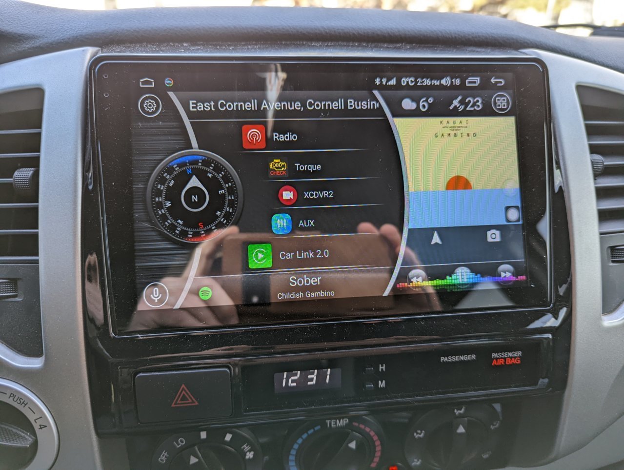

    Selling the 9" joying hu for 2012-2015 Tacoma w/jbl $500 shipped. Completely plug n play. Comes with backup cam adapter, gps adapter, USB adapter, extra camera, dash cam that plugs into hu
