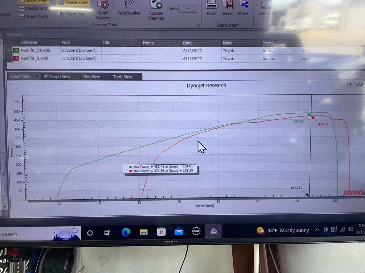

    Harrop Tundra on Premium out of TX.
    Red - Other Tune
    Green - Overland Tailor Tuning
    Not a whole lot of fat to trim, but we found some.

    That chart seems weird with the x-axis. Isn't it usually in RPMs not MPH? So what I see is that in "daily driving" not "in Mexico", you're about 375hp at highway speeds to drop a gear and pass on a mountain pass, not the 487hp peak.

    This was done at a independent shop. We were not running the dyno, or the truck. Simply provided the calibration. The shop did not take the time to setup the inductive pickup to measure RPM on the baseline run. So to do an overlay we had to do it via speed.
    Our run is a ~2500-6000RPM WOT pull in 4th gear. Just has a speed axis instead of RPM. You can configure whatever your axes in WinPep however you'd like.
    You'd need a load bearing dyno to measure the actual force to the wheels in steady state at a cruise RPM. This was a simple inertia dyno that's only able to (consistently) measure output by measuring the rate of change of a fixed mass (the drum)
