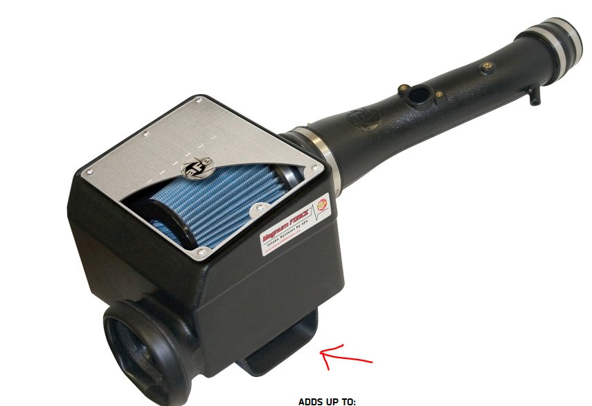

    I am wondering if an auxiliary intake is available for the older intake?
    Magnum FORCE Stage-2 Si Cold Air Intake System w/Pro 5R Filter Media
    Or is it just a port to pull in engine bay heat and dust? Washer fluid reservoir blocks half of it. Would need to fab something to match that opening.

    Nothing currently on the market mates up to that opening. aFe does provide a plug for that "port" with the intake FWIW.

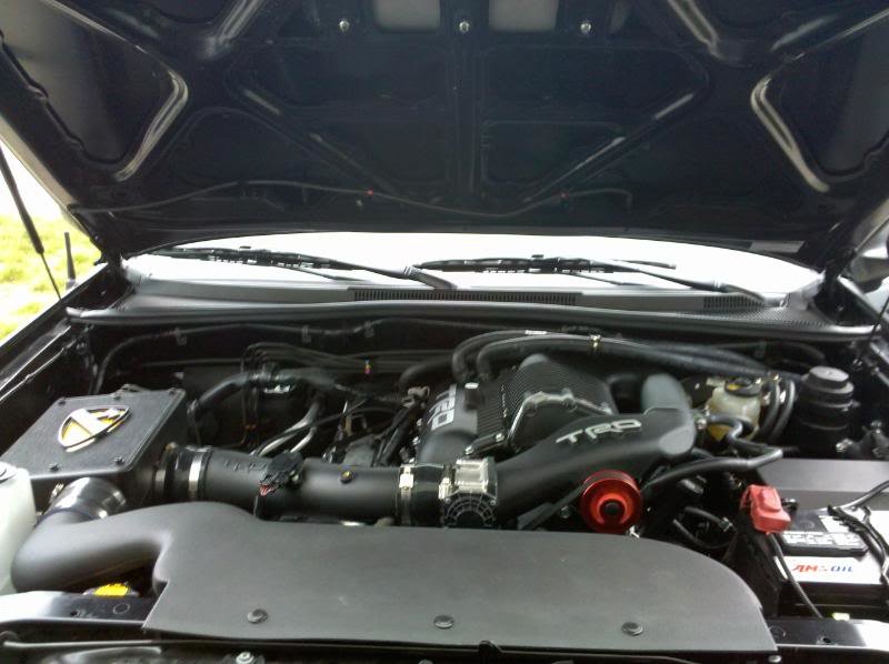

    Is that the one with the “ram air” behind the grille? @scootter82 did you sell yours?

    That's the Momentum GT that has the scoop.

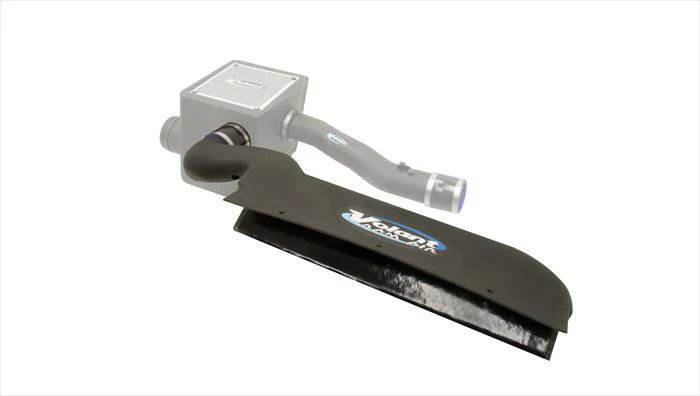

    I have both intakes. The older one (non momentum) is much louder. You can cut a hole and run a duct to use the current scoop for the momentum. I am curious which performs better. Sounds like a fun future test.

    I have the “ram air scoop” from my Volant intake if you want to pay shipping.
    Has the silicone coupler and clamps too.
    Might be able to make it work for your AFE.

    example of the afe intake with volant scoop.

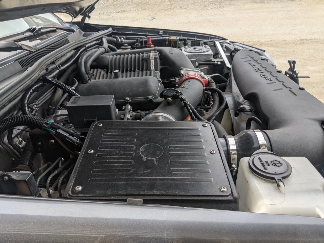

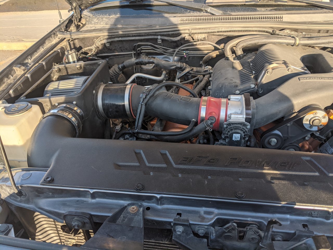

    I did this about a year ago. Can't remember what gains were made, if any.
