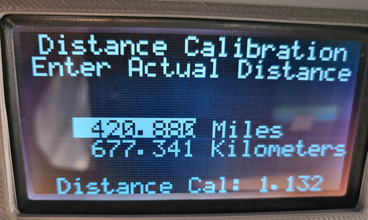

    Anyone here running 35s + uses an Ultragauge?
    I'm curious what you guys have inputted for "Distance Calibrated" value.
    UG Menu -->Vehicle Setup --> Calibration--> Calibrate Distance -->
    This value is tweaked to make the UG data more accurate. I think its one of the value that most of its calibration relies on and is suggested that you sync the UG with a DOT mileage marker. Without a hypertech or dakota correction device, the odometer is inaccurate which affects computing mpg, distance, etc. With a accurate dist. cal and fuel consumed value(s), I can rely on the UG for more precise mpg, speedo, etc readings.
    I know rolling circumference varies between 35s etc..
    My distance cal value is 1.132. I was only able to calibrate it against a 18 mile sample of a milage marker. But I think it makes sense because my tire circumference is roughly 13% larger than stock-ish.

    Hmm haven’t though
    of it. I had my other setup configured to match. I tweak it based on GPS speed and adjust speed until they are similar. I’ll have to look into it on ultra gauge
