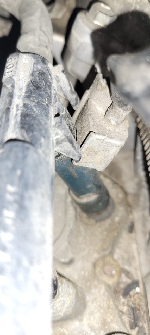

    I was able to read a part number on one and it was a stock injector. I couldn't get a picture though. Is it possible that they were reflowed?
    It seems to run well at wot and have good power. Afr guage reads 10 to 11. Is it possible for the stock injectors to supply that much fuel?

    Definitely wrong injectors

    So assuming it has the trd flash what injectors should I get?
    I have had a hard time finding the orange trd injectors for a decent price. Would the fic 445cc injectors work? Looks like they are a very similar flow to the trd injectors. Are there any other companies that make an injector that would work with the trd tune?

    I just sold a set of TRD injectors for $150. Darn..
    The FIC's may have a similar flow rate, but their response times vs. voltage will be quite a bit different. You'd find the fueling would still be off even if they have the same peak flow rate. You'd really want to have the proper injector calibration data in the ECU for the injectors you run.

    The orange ones came with the trd install kit, so those are the ones you ultimately need. However, if you bought FIC’s. I’d get the ones that do indeed match what the orange trd densos put out. They probably aren’t identical so you could then get retuned with hptuners and have OTT set you up.
