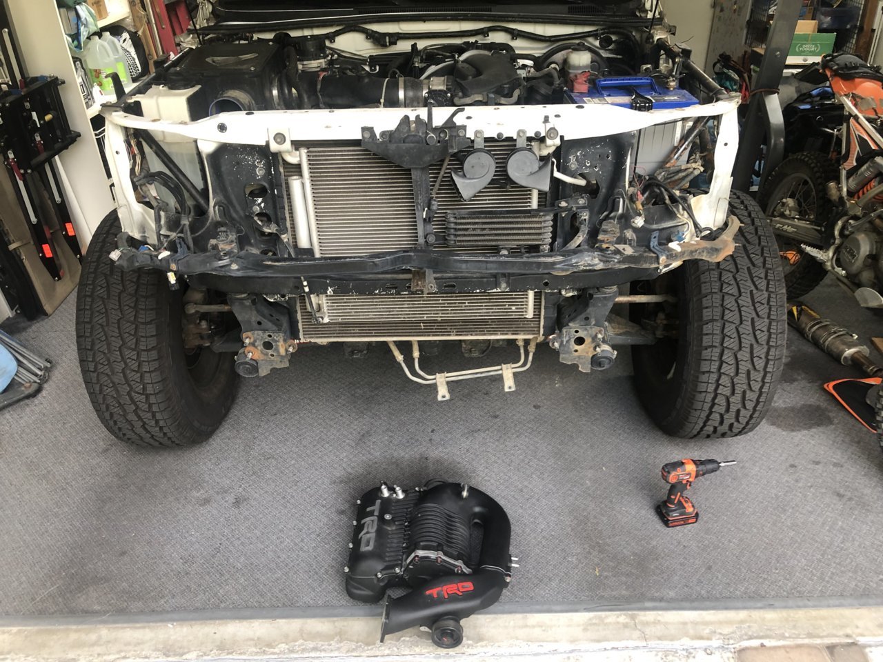

    finally got a day to put there TRD on the truck !

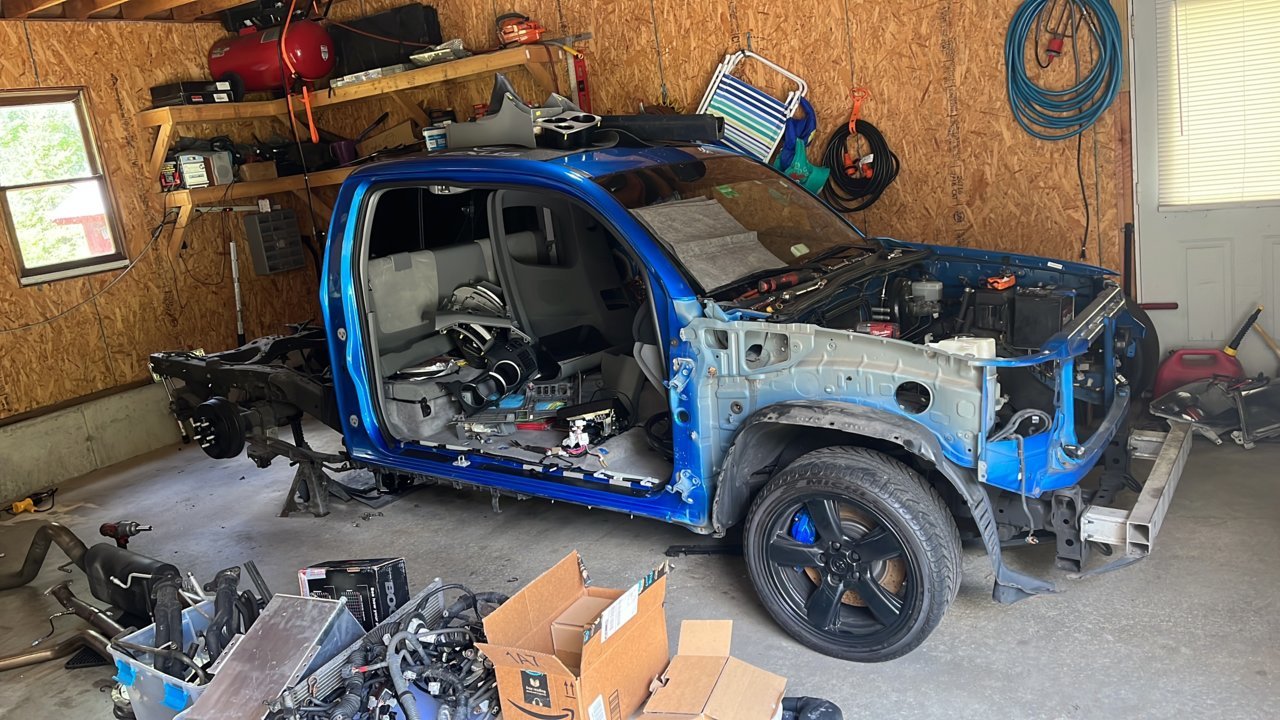

    It’s sad to see it like this. But it’s all
    Working out so far. Hopefully get a is500 In the spring. Anyone need any interior parts or weird stuff let me no. I’m gonna end up selling the frame and cab to a local guy for
    Cheap.

    I'm just curious, how does it work out with insurance payouts and you keeping the truck to part it out yourself? Like do they give you the totalled value, then charge an amount to keep the truck or something?

    Second Q… im trying to get the crank pulley bolt off.
    This sucker is tight.
    I’ve tried a heavy impact. Other ideas ?

    Breaker bar on the frame and bump the starter.

    Ok, so I put the breaker bar over the frame on the driver side frame rail yes ?

    Yes. Just find a good spot. I would pull the fuel pump fuse for added measure. One bump should do ya.

    They give u a price on what they will pay u. Mine was $12,000. And they there’s a buy back amount. Usually what the junk yard will give them for a price. Mine was $3500. So I ended up with $8500 and the truck. Not bad.
