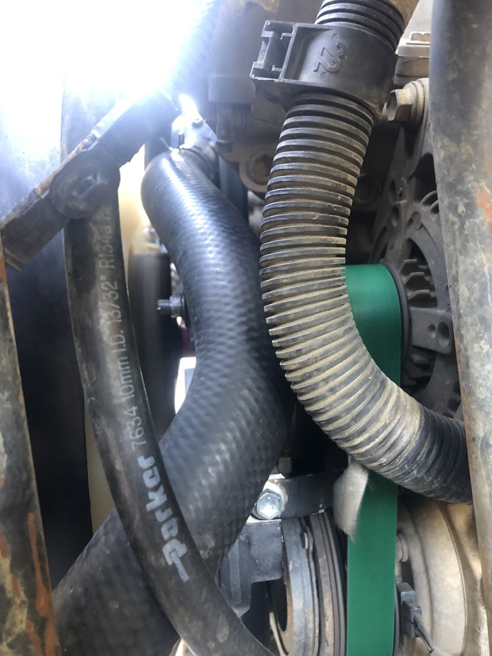

    Sucker runs. The part I was most intimidated by was re-syncing the new @JustDSM flashed ecu. Electronic stuff is my weakest skill for sure lol.
    Kind of an odd noise coming from the blower at idle, could just be the rattle described in the OP from the solid coupler?… I’ll post a video in the AM.

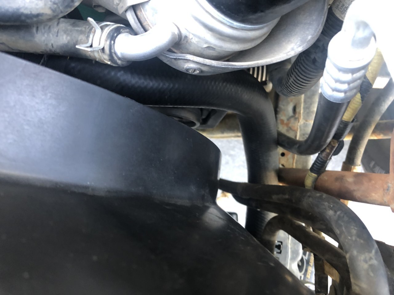

    Also have a question about how the lower radiator hose is sitting, it’s definitely pushed up against the far driver side edge of the s/c belt tensioner bracket. Normal? I’ll post a picture in the AM as well for y’all to take a look.

    It’s definitely close, did you trim the original like the instructions show?

    I didn’t - as everything I had was used. It looked like the hose was trimmed before. But I may trim another 1” or 1.5” off the lower end where it connects to the radiator.
    side angle looking from driver wheel well:
    Top down view:
