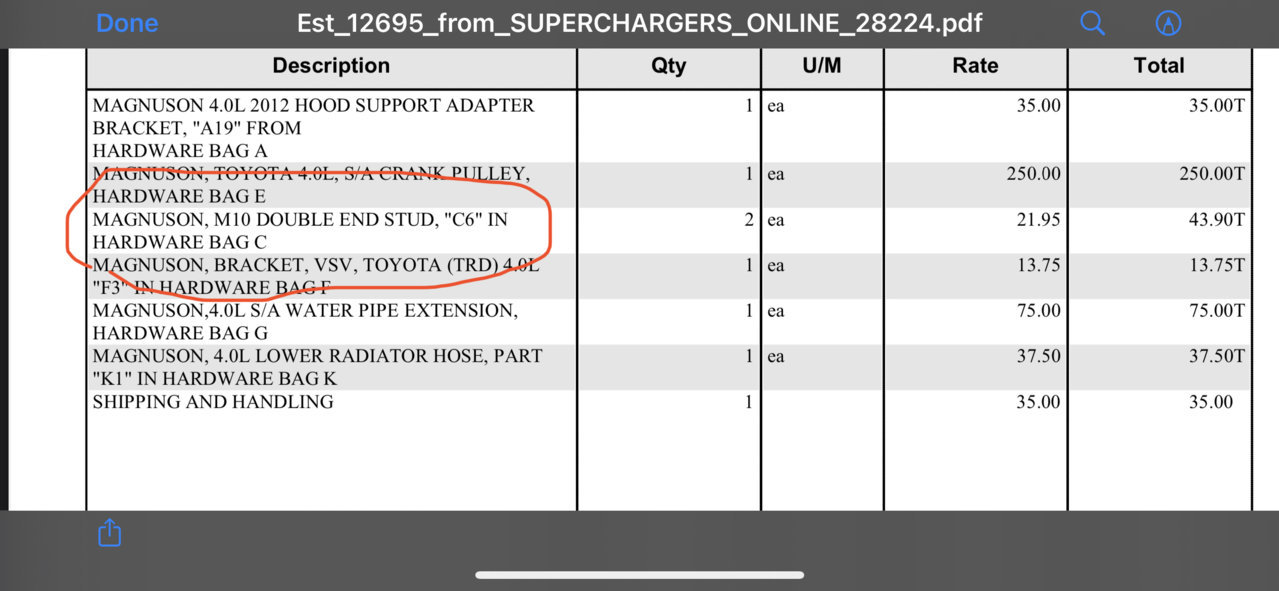

    Call or email superchargersonline, that is who magnuson will direct you to. You need this part circled in red. Just make sure you inform them it’s for a 05-15 tacoma supercharger.

    There's been a lot of inquiry this year alone regarding the part number for the pulley retention studs. Because of that I have added a quick reference to it on page 1 right after the tensioner section.
    I hope this helps!

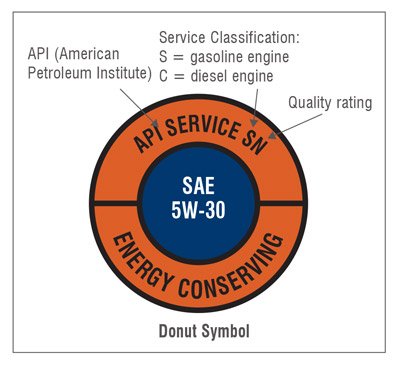

    It is have a SI or CI on the back in the API seal. As long as it has the SI (spark ignition) you're good.
    Fyi CI (compression ignition)

    Sorry, SN or CN
    The S and C are spark and compressionthe N is grade quality.
    The more you know.

    so if its rated for diesel use yet it has a spark fire blessing its fine? then im good.

    It will be rate for one , the other or both. As long as it has a rating for gasoline engine in it, I would say feel comfortable to use it.
    Most likely the diesel engine oils will have more pink and phosphorus based on the way that the flat tap designs of the camshafts are and reduced emissions standards then gasoline engines.
    Maybe I just misread your statement.
