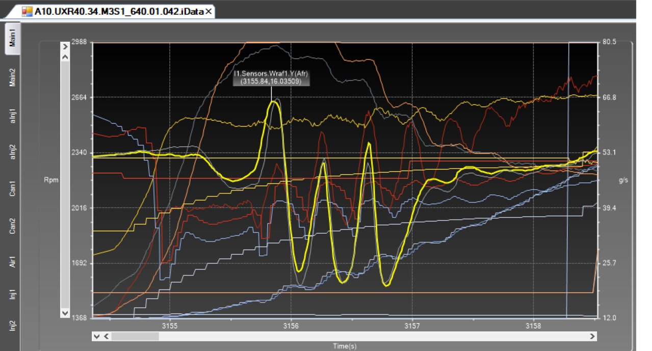

    Ok..
    Collected data, got ‘lucky’ when I went from mellow to full throttle (or nearly full floor mat limiter ) the truck jerked hard three times before some meh acceleration. Rest of the dataset was just normal driving.
    looks like lean spike on tip in that it has a hard time recovering from, just no clue why. Unless someone wants to test my vacuum system knowledge, I have a hole in my air surge plenum, or that stupid mystery valve on the back of the plenum has been screwing me this whole time, I should be EXCELLENT in terms of gaskets/hoses (including exhaust to head and coupling and sensor junction points) (also including all EVAP hoses/containers).
    my fuel injectors all seem very clean, I have fresh o-rings between the injectors and the rail, along with rail to intake manifold that were all greased with a bit of gear oil for installation lube. All contact points were cleaned.
    my tubing is mated in the straightest designed path possible to not cause turbulence before the MAF sensor (URD MKIII)..
    the spark seems to be reacting to the AFR, and this is where I leave it to the pros in here with access to UTune to check my data log out. Attaching a couple pics to show the air surge plenum mystery valve and the gnargnar oscillation in AFR and RPMS this dataset collected.
    Open world link via google drive of u-time data collect this snapshot was from:
    https://drive.google.com/drive/folders/1hg4xBFDYOqCdPWZIl81QQ7FYh2zF851F
    I’d like to think that spark angle reduction is a reaction to the lean spike.. it also seems like this lean spike is seen on both banks (ruling out an exhaust leak — unless someone totally screwed me over by jabbing holes in both headers…. Lol
    Hoping someone with magical powers can get eyes on. Also sent to Scott and will share what he says here in hopes to help someone else at some point. THANKS!

  16. Sep 13, 2022 at 11:10 AM

    Looks like the guardian kicked in to protect the engine since it was lean (this is the womp womp womp power cut you're getting). Did the 61lb injectors come with your URD kit? When i tried running those on my UCON with the TRD blower, it did gave me lots of issues after retuning for them. Swapped back to 455s and it was smooth sailing after that. I personally think this is UCON related if everything on the truck is in good working order. Are there any other issues at idle or codes being thrown or is it mainly under half to WOT conditions?
    If it was me, i'd probably buy a spare ecu and have @JustDSM build you a tune for your URD blower. This would allow you to isolate the problem and determine if it's the UCON causing you issues. This is how i determined the circuit boards on my UCON were bad.
