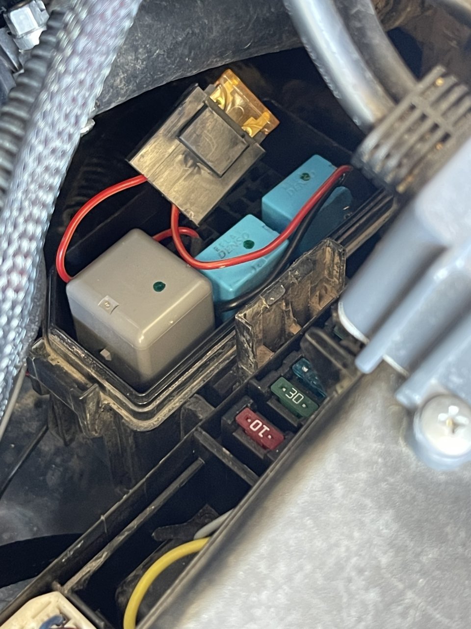

    Hasn’t killed my battery yet, but it’s real annoying when it is cycling on and off every ~47 minutes at night when camping.

    I can’t remember which circuit it is off the top of my head, but I ended up running the power to the same ignition switched circuit that the fog-light-anytime mod uses. No more random emissions power cycle going on when the truck is off

    The only problem with the kill switch is you can't be forgetting to make sure it's on when running.
    I did the ignition controlled relay and don't regret it. Easy enough to do and beats having the SAI randomly turning the pump on whenever it wants.

    i think this may be the same circuit I tapped into… I remember it tapping into a relay

    So just add a relay triggered by ignition like @TodayWasTHeDaY said and good to go.

    Which ignition controlled circuit are you guys tapping into? My worry with the toggle is if it fails( they arent exactly high quality these days)& driving around with the coolant pump off . By the time it started overheating the engine would it already be too late for the supercharger?

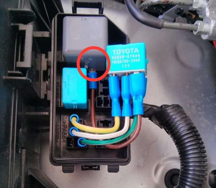

    This is where I have mine tapped into
    You can get a better idea of where the power is coming from from @nd4spdbh picture, where I circled
    That’s what I’ve used reliably with no issues and no random cycling when truck is off.
    Here’s @nd4spdbh original thread with some more detail about what’s what
