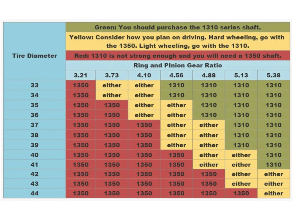

    2,043
    Aurora, CO
    What I used to order the driveshafts for my JK
