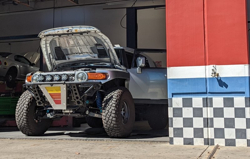

    Do you guys get flack for your catch can? "Modified PCV".. First smog shop I went, different shop than I normally go to, wouldn't take my car. Finally found the original one that smogged here in Mission Viejo, CA. In and out in 10.

    You are technically messing with stock emissions by adding the can... Even though common sense should step in and identify that it is a closed loop. You are actually improving your emissions by removing that oil in a solid state vs re-burning it and sending it down the tail pipe. But California. It makes sense if you don't think about it. Leave that hard thinking and reasoning to the much smarter, better looking, higher educated politicians.

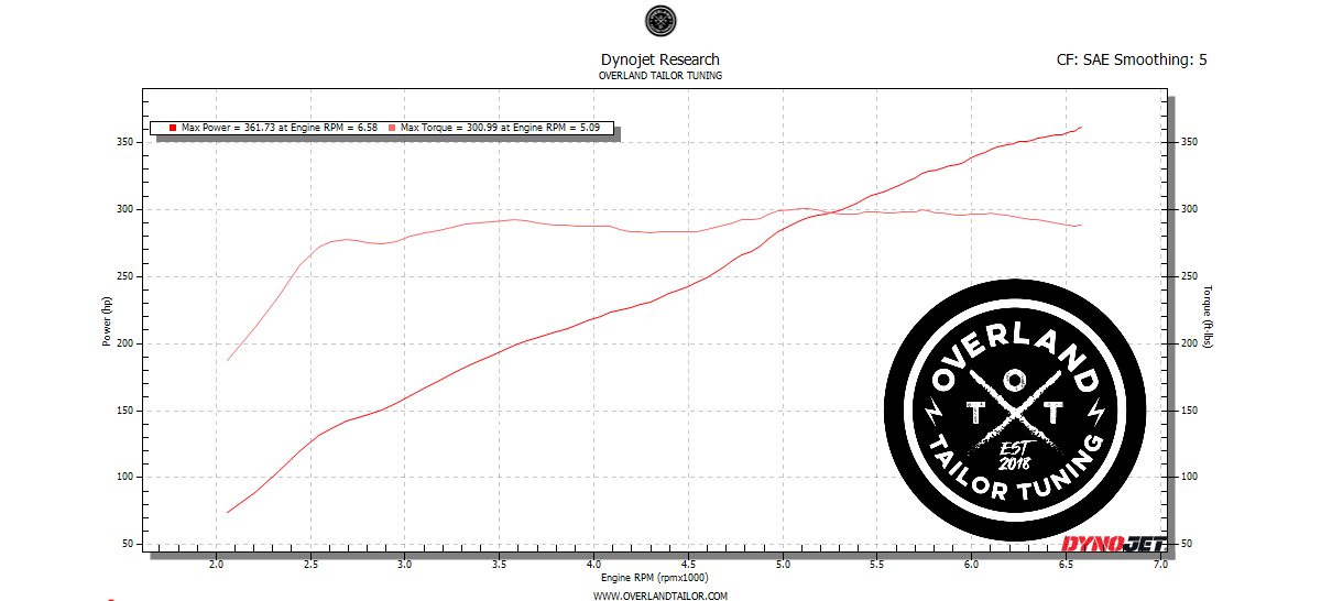

    3G Maggy on a (otherwise) 100% stock truck. 1600miles on the ODO...

    Didn’t know you’re in south OC!
    I used to be in Fullerton but am now in RSM. Have to keep an eye out for you

    I live in Anaheim but have worked in MV for the past 10 years. I used to give the sup to people but FJs usually owned by old ladies and Tacos don't acknowledge me cuz I'm not a "truck".
    You're/he's in the right. I didn't put up much of an argument. He didn't seem interested in entertaining the smog. The 2nd shop passed me exactly how I am.

    Peak rwhp is very impressive for a custom tune on all stock SC parts. Curious why the torque curve dips some ~2800? Usually these TVS blowers hit top of torque curve well before that rpm. Was this a fourth gear manual pull? I’m sure a couple aftermarket mods would remedy that. I say headers and a smaller pulley to experiment :D

    Pump fuel limitations/VE obstacles. I could smooth it out at the expense of torque before and after that point.
    3rd Gear pull in a auto using a Gear Lock tune enabling us to run it like a manual.
    Full exhaust was already on hand before the truck was even delivered :) Just had to get "stock" numbers first.. Pulleys to come.

    f-that not showing a howdy for a sweet rig. i often compliment others' rigs if they have effort and style. its what modding can be about too.
