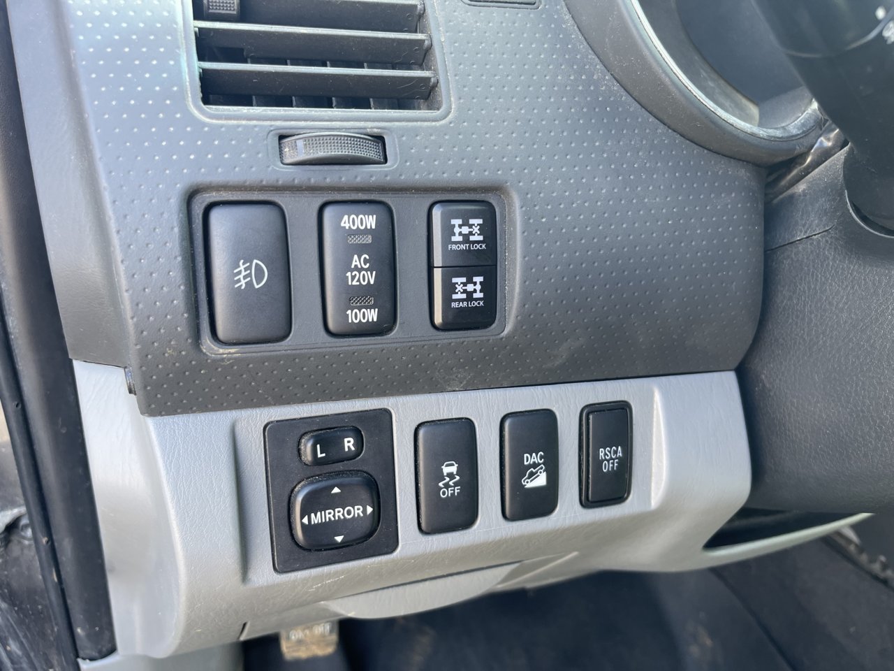

    Yes
    Adds a nice little touch doesn’t it ;)
    Here’s the link: https://www.ch4x4.com/product/ch4x4-dual-push-switch-for-toyota-front-rear-lock-symbol/

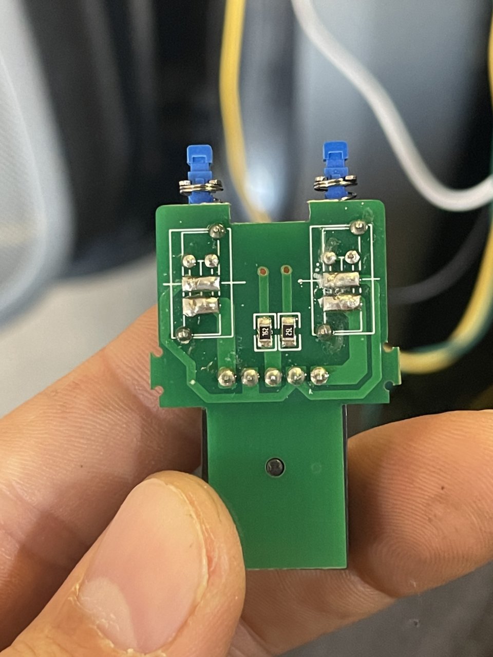

    FYI, if he ends up getting it, let me know. They have a manufacturing issue with their boards that had me chasing an electrical issue for HOURS. Essentially the ignition 12v and illumination (headlights) 12v are on the same trace on the board. This resulted in my locker engaging when I would turn my lights on… absolutely no bueno
    I ended up just not tying the switch into the illumination circuit so the buttons stay lit up all the time (which I could care less about).
    good ole cheap Chinese products but only one that I could find that would keep it looking OEM as possible
    you can see pins 2 & 4 are tied into the same trace which was causing the issue

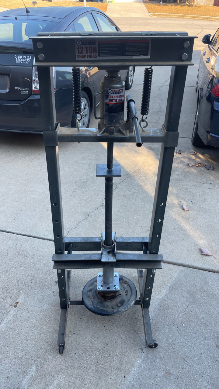

    Have you always had that press?

    Yes
    i have
