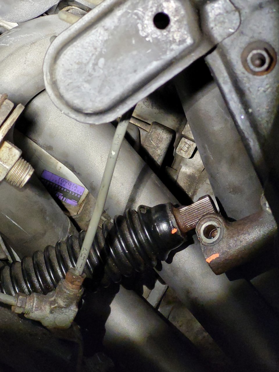

    Alright guys I'm back for some help. How in the heck do I get the steering shaft back together? I had to pry it apart and I can't get either side to "collapse" so I can mate them back up.

    Loosen both bolts on the coupler and slid it up as far as you can and that should give you the space needed to connect it. It will be a huge pain in the ass.

    Pure brute strength gets it in there. The same way you had to do it to get it out is the same way it goes back on. If you spray some WD40 or silicone lubricant on it, it should help you slide it on a little easier, but either way it sucks and is a craptastic design. But hey, we need it, so..

    looks like a good bit of rust. I would take the whole coupler off, clean the splines and then put some lube for assembly. Lube is key! Always :)

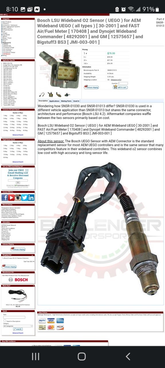

    I finally got it! Good grief this install sucks! I also had to drill out one hole on the driver side header to y-pipe flange the supplied bolt wouldn't fit. Now my y-pipe to cat-back connection is crooked and I can't shove catback around cause tail pipe hits spare tire. I guess imma have to go back through and loosen everything up including the headers and see if I can get it to line up. Oh and I need a extension harness for my wide band now too...I can't find one of those either. I'm about to sell this thing lol anyone want a 09 with 57k.
    Looking for extension harness for one of these if anyone knows.

    Where's your wideband sensor connected? Min seemed to have enough to get past the collector on the y with slack. But I have an Aem wideband although the sensor is Bosch I believe so maybe mine has a longer sensor wire.

    Mine is on the passenger side collector. If I could find the same sensor with a longer lead would be nice but I figured the extension would be cheaper.

    Yeah so autometer doesn't make a simple extension harnesses, instead they make that whole new harness from gauge to sensor. So instead of the 8ft one you get with the gauge they will sell you one that's 25ft long. So I'm going to try and move my sensor and harness to driver side collector.

    Just get a Denso sensor. You can literally buy it in tons of different lengths that will more than reach the passenger side. Plus it'll be cheaper than some extension harness.
    Also it won't die after 4 engine turn ons and go giving you an error code or overly rich/ lean condition which doesn't actually exist on your gauge because you went with Bosch.
