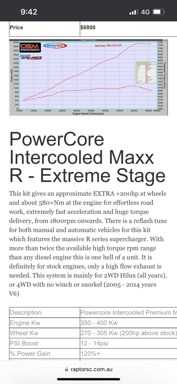

    Here is a little bit of very interesting information you fellas might like to read. This is a place in Australia that supply and install chargers for the 1grfe engine. They have stated that their kits are designed to go straight on a stock engine apart from an exhaust upgrade and they can push to 14psi. I did also speak with them over the phone of my smaller pulley idea and they said with the right tune I’ll have no issues even if it went past 14psi, the engine can handle it. All that is left to do now is… send it! Lol. Fuck it may as well.

    Can versus should push 14psi… It would be real interesting if your Australian 1GR is different enough from our North American ones... we may be buying front clips and doing swaps over here...

    Here is their information on the charger

    The only thing I say to this is that boost isn't everything, but flow is.

    The issue is that type of blower, centrifugal, has a gradual boost curve vs roots which is near immediate. That is different loading on the bearings, piston, etc boost really isn't the gauge you'd want to look at but volumetric efficiency. The readings from the maf would be a good resource.

    Well... I still am pushing 15psi and things are running fine. Don't get me wrong though, I always have that plan on the backburner for me to buy a short block...
