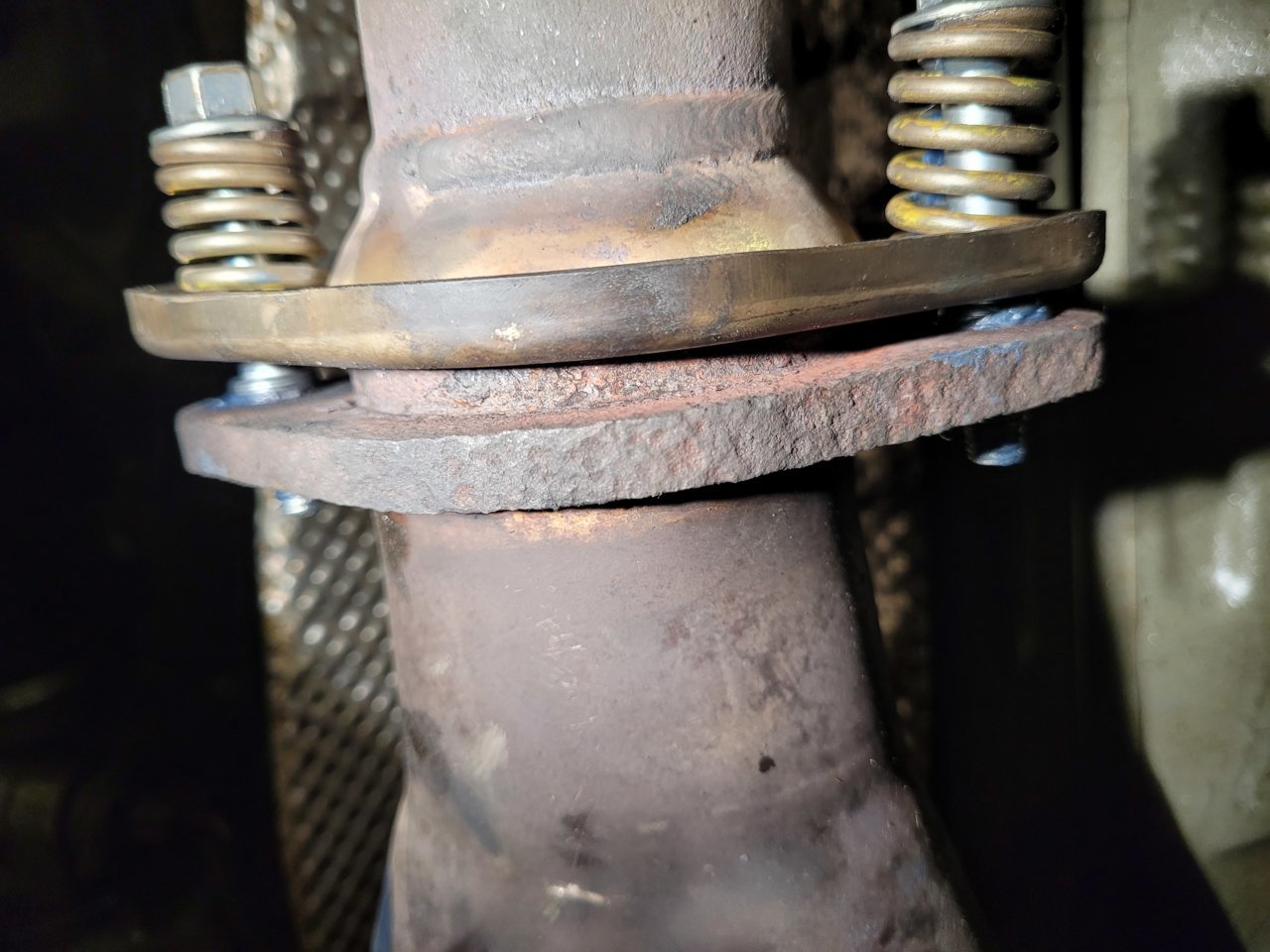

    Urd Headers install almost complete...I rerouted the harness for wideband in the engine bay so it will plug in to my wideband. Went to hook up urd y pipe to my cat back and they don't line up I can bolt it together but will not seal. I need the y pipe to go 1/4" towards the passenger frame. Now my question is can I get a 1/4" of lateral movement if I loosen all the bolts including the headers? I really don't want to tackle those things again once was torture enough lol. Picture is looking up at the connection from the ground

    @novanut21 imo you could probably loosen the y pipes and slowly get that 1/4" lateral by tightening the catback side first. And having a second person give a little oomph to the catback for a little angle. The saving grace is that exhaust gasket is curved and most likely will still seal. If it were me I wouldn't touch the headers. Maintaining a better contact from exhaust manifold to the head is more important and more difficult to fix if you decide to loosen the whole system.
