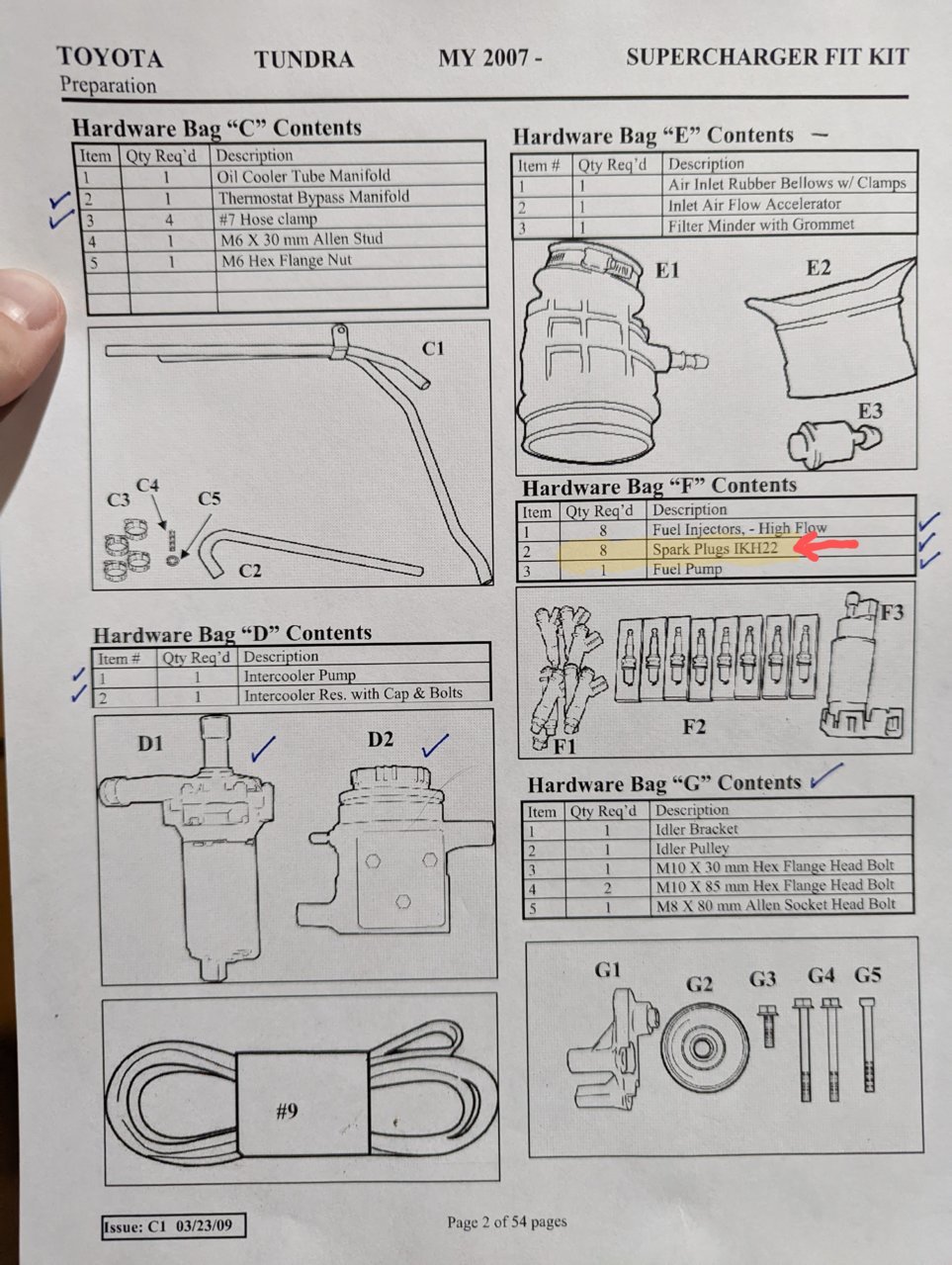

    Regarding Ruths. I noticed that the Tundra s/c uses the same spark plugs that the Tacoma uses. When I looked up the part numbers and comparison, it shows that the Ruths are one step warmer Iridiums. One of the Tundra forum members called them up and they said that Ruth wouldn't work for the Tundra app."NGK told me that P/N wouldn’t work for my truck. He said something about something being hollow shell I think. There’s another part number that they have that matches the tundra but it’s for heat range 6 on their site and he told me that plug would be too hot."
    Thoughts? I've already bought the Ruths for the Tundra build and still plan on using them

    I don't know anything about the Tundra. I would need to know it's base Iridium PN, determine it's heat range and then cross compare specifications from the Iridium's they use and see if there is a Ruth available for the Tundy. That's how I did it for the Taco and that's how I did it for my Camaro.

    As far as I can tell, both the Tundra and the Tacoma use the same Toyota part number for the TRD spark plugs. So I can just assume the same would be true for the Tundra with Ruths. Just want to ask everywhere I can before I blow up my truck lol

    The Tundy's use IKH-22's normally on their boosted application? If so then the Rutheniums listed here will work.

    I was surprised too, but ya.

    Full send my dude. Without worry.

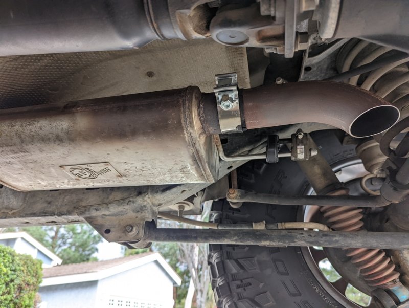

    3" pipe was fun because it sounded fast. But you were right, mostly at WOT. The rest would just sound loud. It would drown out the engine and s/c. 2.5 sounds much better and kept boosty noises up. Went back to 2.5 today and made it a turndown
