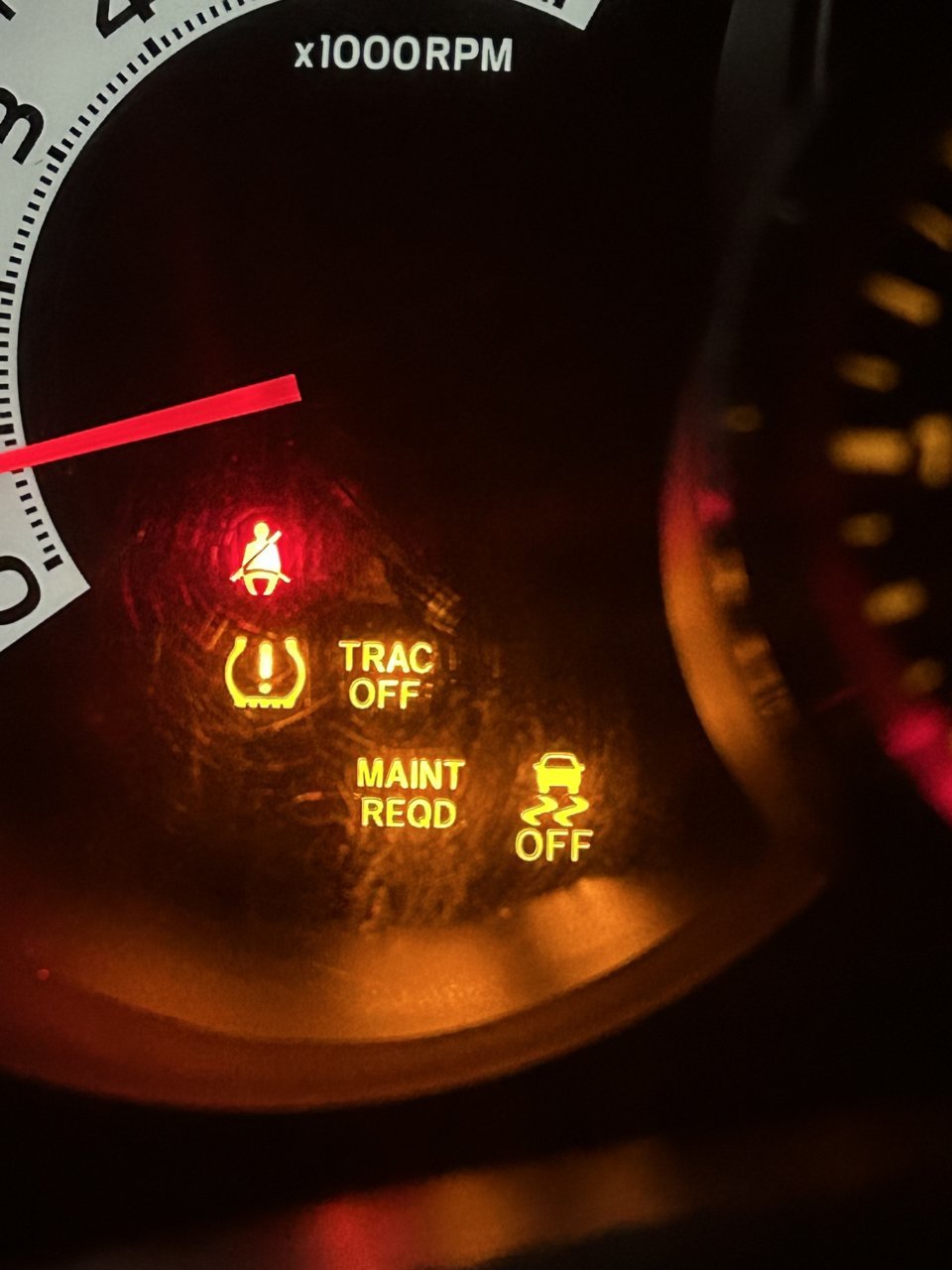

    TMPS light flashing then solid usually means that a sensor has broke or run out of battery (not responding).
    I wouldn’t think it should have an impact to any other system.
    One of my TPMS sensor is broken and does the same thing on the dash.

    I would at least check tire pressures, including spare. It simple and easy.

    no spare. ha! just curious why flashing every start instead of solid on AND imparing any fun times.

    thanks for that idea. im betting its a front sensor from an alignment tech. anyone have a part # or advice on this topic?

    but does it limit you from breaking traction?mine does. keeps it boring.

    Is it your traction control kicking in? Are you getting the squiggly tire marks flashing icon when it happens?
    Because the traction control cuts engine power and/or applies brakes to the tires that it thinks are losing traction.

    Unlikely an alignment tech damaged a tpms sensor because those things are inside your tire. It’s probably just a sensor battery slowly going out. It’s that time if they’re original.

    Pull #2 abs fuse under the hood to disable all traction nannies

    I don’t think so.
    I have put in a switch that breaks the wheel speed sensor signal so I can cut all trac/vsc/abs - but then I can obviously do so.
    Ordinarily, trac will limit wheel spin or kick in abs if I give it throttle around a corner.
    If I push my trac button for 3 seconds to disable trac these lights appear and I can still spin tires as much as I can with 35’s and stock gears. (Ignore the seat belt and maintenance light)
