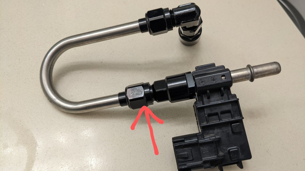

    This is an off topic thing, but I just need to put out there that I DESPISE AN fitting junk. I went and installed a new AN fuel line from a manufacturer, and the line was pretightened, ready to install onto my rail and everything and the stupid thing is slowly weeping fuel, which explains why I continue to smell fuel through my vents.
    What do you boys recommend I use to stop the leak, teflon tape?

    I could be wrong but I’m pretty sure it’s normally advised not to use teflon tape with AN lines… how ever if it’s leaking already then maybe it’s worth a shot?
    I would contact the manufacturer for a replacement or buy a new fitting if it was me.

    Weeping or permeating? Is the line angle an issue? Maybe switch to crimped line instead of one that tightens?

    It's definitely not permeating. It's active leakage and it's weeping in between the "conical seal" portion of this threaded nut and the connector that reads DSX.
    Like I've said before. I despise AN crap for this reason precisely.

    You will NEVER catch me going with AN fittings because of this hogshit right here. It never fails either. Oil, gas, coolant, every single time I've had a system the POS setup always leaks.
    I only got this setup for visual purposes to give it a clean appearance come inspection time. I got it direct from a builder so I let them assemble it for me and call it good. Here we are. Post install and big freaking surprise, I have leaks.

    I've used a ton of AN fittings over the years for everything from high pressure air to fuel to oil to n2o, never had a leak at a fitting that wasn't my fault or debris in the sealing surface. I have had the stainless braided hose degrade internally and leak straight through the hose. I have had tube nuts leak around the flare of the stainless tubing, which might be what you have going on, if the flare wasn't done correctly - and never had another problem after getting a "good" flare tool that burnishes the sealing surface. But that isn't the fault of the tube nut or sleeve or male adapter. I've never had a 37 degree flare leak or fail at the flare, especially when the male and female side of the flare are both aluminum. I'll take flare fittings any day over barbs or other hose clamps, which I have had leak lots of times.
