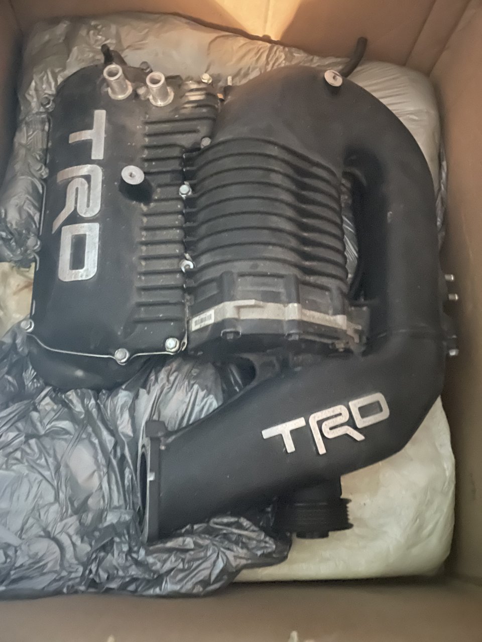

    i just did exactly this. Bought a used TRD s/c and tripple checked I had all the parts, etc…
    Mine spun free and smooth by hand, but I ended up having to send mine in and it needed the full rebuild.
    this is what mine sounded like with trashed rotor packs and bearings:
    https://youtube.com/shorts/gIVzUCI0lZQ?feature=share
    I found walking step by step of the magnuson install manual and checking each part/ bolt was there, was super helpful. I bought all new plugs and soft seals

    Buy once and cry once, @Dawglb44. You'll save yourself a LOT of posterior pain if you spring for the rebuild up-front, rather than finding out its needed when you've finished the install.

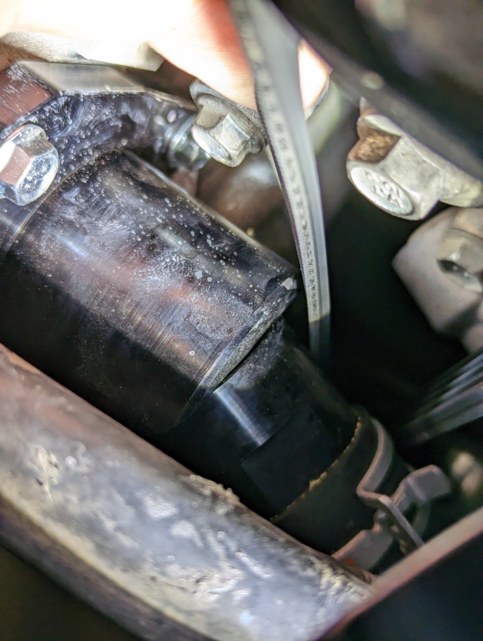

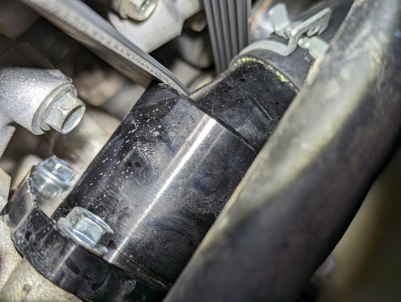

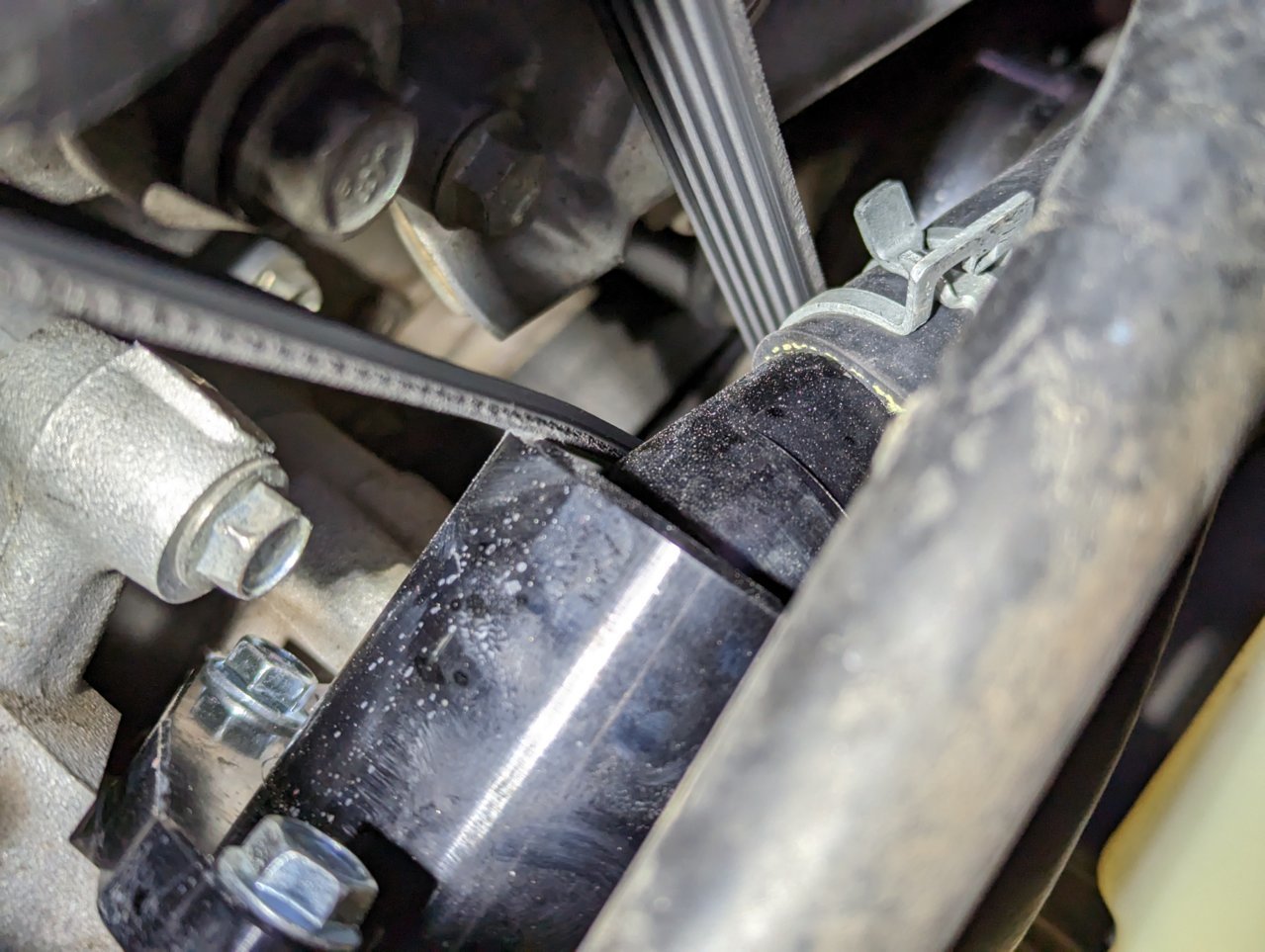

    i have two. read engine banks seperately.

    that sucks. ugh. 150$ for a part i cant use.

    Someone NA will likely want to bling out their stock truck. Hopefully the maker gives a partial refund or even does a take back/swap for the updated one that works.

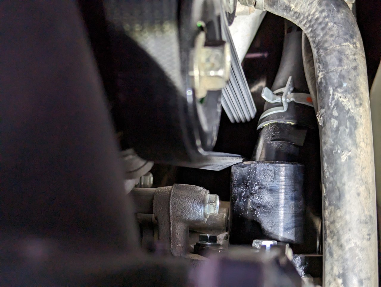

    I have a apr t stat on my 4runner that I could swap over if I stay superchargered on the Tacoma. It has a notch for belt clearance and is cast aluminum

    he's working on it. Give it some time. I'm hoping to try a revised part and give it a go again.

    I’m having a hard time believing from that video those rotor packs and bearings were actually “trash.” That blower sounded perfectly normal especially if there was a solid coupler installed. There is no way you could turn that SC pulley by hand smoothly yet have bad rotor packs. Plus if those rotor packs were trash it would have destroyed the soft aluminum casing. Anybody that’s taken out the rotor packs know how stout and heavy they are.
    I guess peace of mind for lack of knowledge is king. I’m guilty of it too on certain subjects but not this one.
    So I really hope SC online is being honest about their assessment and I’m wrong. Otherwise they are just laughing it up on this thread.

    When they sent it back, it was 90% quieter.
    it still has a “growl” and idle, but I can’t hear it unless I’m in the engine bay.
    Before, the growl could be heard while driving and on no throttle coasting. I expected some noise but that seemed too much.
    Like you said, idk what I should have been hearing and a lack of knowledge on the specifics as well as any service history on my blower before I bought it, I’d rather have the peace of mind it won’t detonate and destroy the whole 1GR.

    I’m glad to hear I’m not the only one who went down this path lol. Did you get everything that you needed thru SC online?
    Normally I’m right there with you. But the cost of the rebuild is enough to give me pause on this one. The more I think about it, the more that what y’all sayin is resonating with me. Maybe at tax refund time lol.
    i usually error on the side of piece of mind, especially when I don’t have the expertise to make a dead nuts accurate assessment. The cost is a big enough factor on this to give pause. It does spin freely by hand, don’t feel a ton of play in it, so I’m considering sending it lol.
