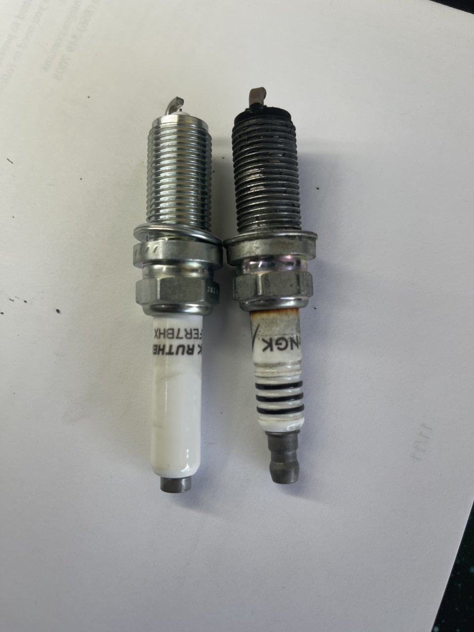

    Hey guys. Does this ruthenium plug look right?
    I noticed the top of the spark plugs are different on the lead that connects to the coil pack. 6BA4D867-CE7C-4E12-875B-BE12AE9B1C4D.jpg

    That’s exactly how mine looked, they worked just fine for me.

    Yeah you're all good. They look like that because they are actually made to fit VW. It just so happens that they use the same specs in their cylinder heads as we do as far as spark plug requirements goes.

    I was more worried about the leads not making up right inside the coil pack, but in they go !

    Oh yeah, the flat tops are a little off-putting at first. You get used to it after you change them out a few times. Lol.

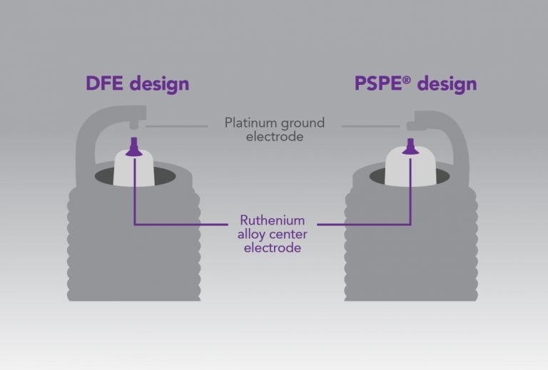

    Ya, that's the forced induction specific spark plug with an extra tang or whatever that protrusion on the end is called
    https://ngksparkplugs.com/en/products/ignition-parts/spark-plugs/ruthenium-spark-plugs
    PSPE® (projected square platinum electrode) provides the best ignitability and service life for high-heat engines. This NGK-patented design is recommended for turbo and supercharged engines.

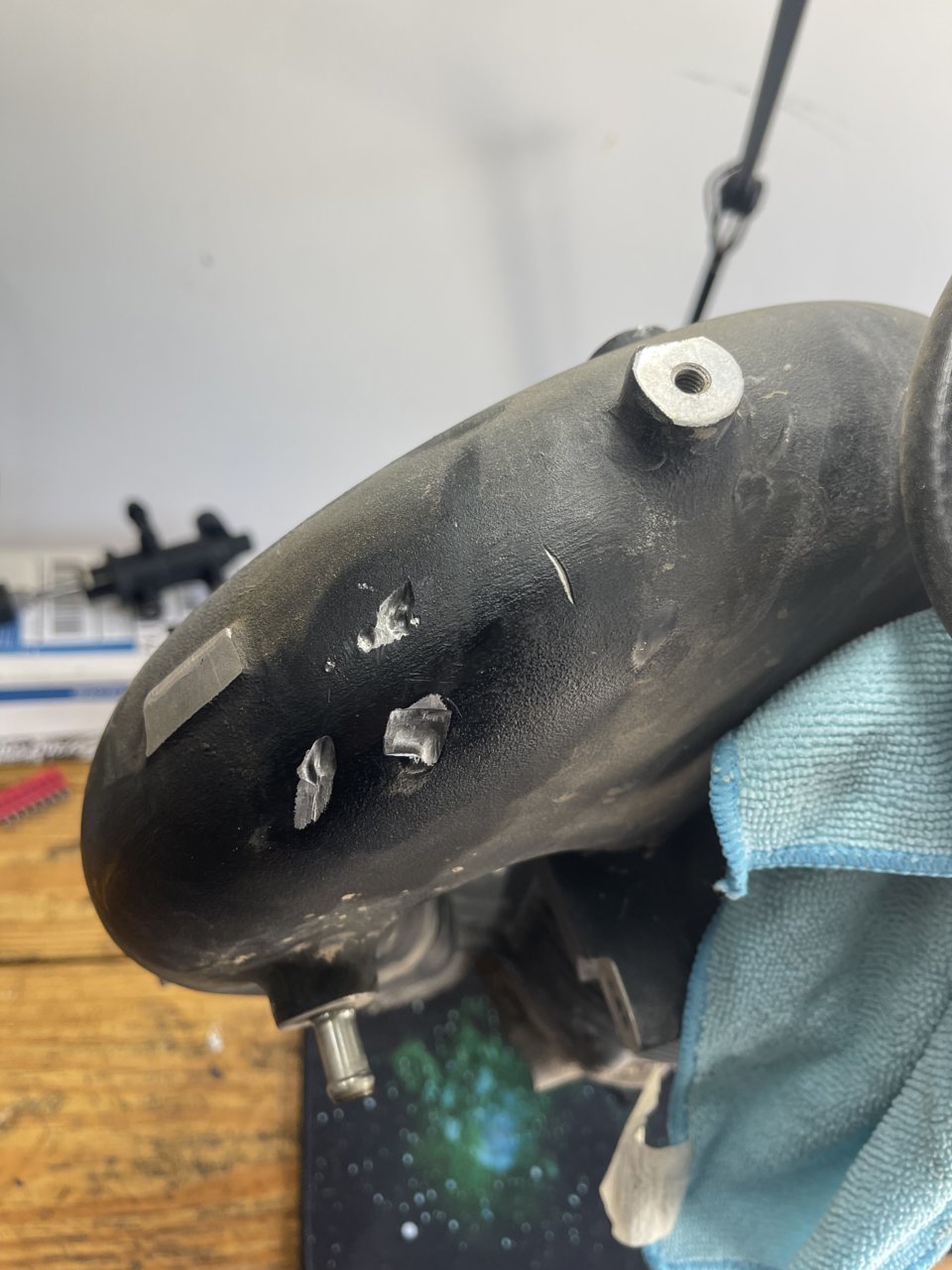

    Another victim of the clamp rubbing issue. Good think I caught it before it rubbed all the way thru.

    His concern was the non traditional style recessed circular tops of it though, not the electrodes at the bottom.
