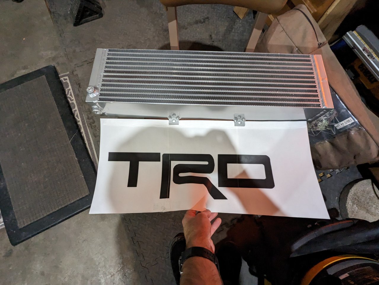

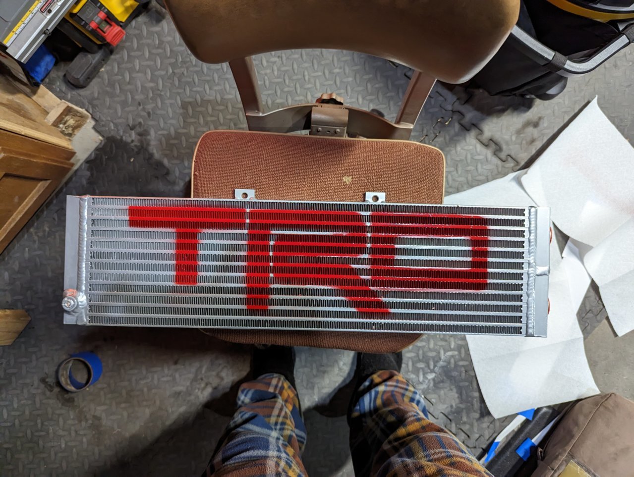

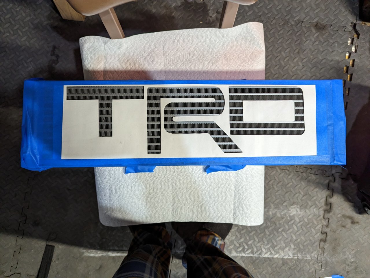

    I don't know how you managed to get that stencil but I DIG it! :thumbsup:

    I just grabbed a TRD logo off the net, blew it up to 265%, printed it out over three pages, taped together, cut out, and spray painted!

    looks very nice. +2 for red color and trd logo.

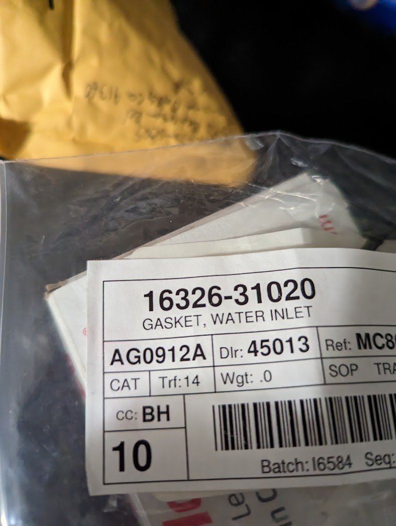

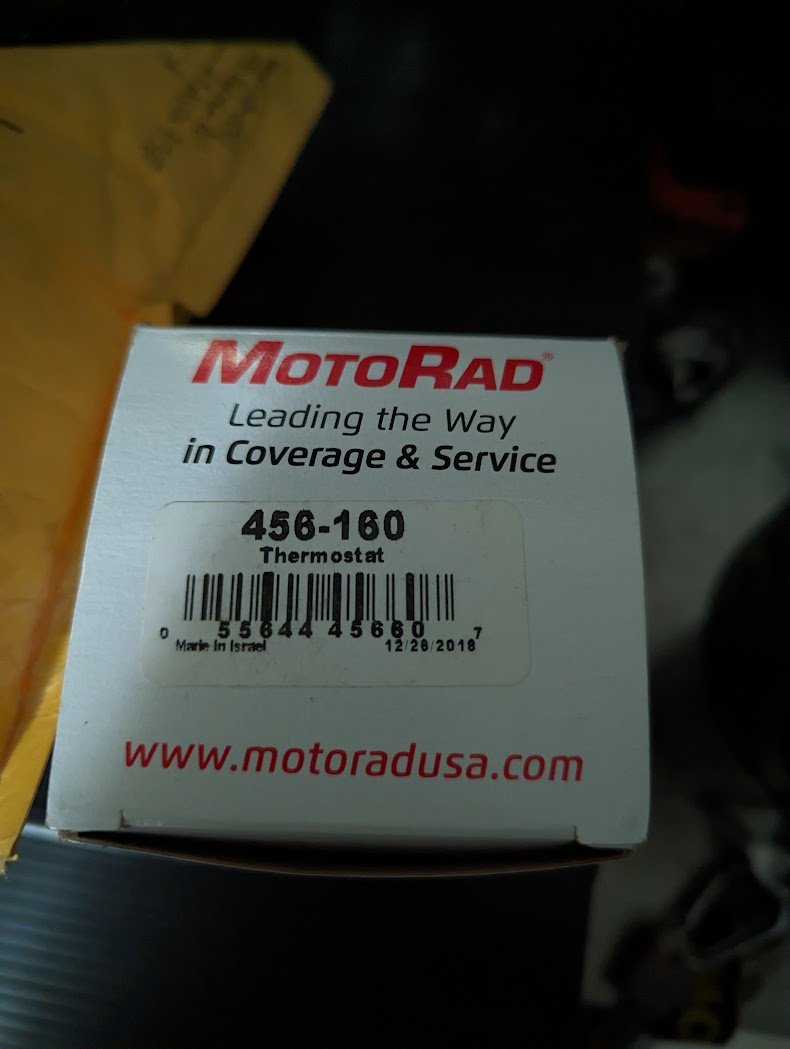

    Shoutout to @racebug68 for meeting up last night and getting me hooked up with replacement parts I needed for my old URD t-stat setup. He had an extra Thermostat Housing Gasket, and a fresh 160 Motorad T-Stat. Helps me get the truck back up and going temporarily for the holidays until the billet housings get sorted.
