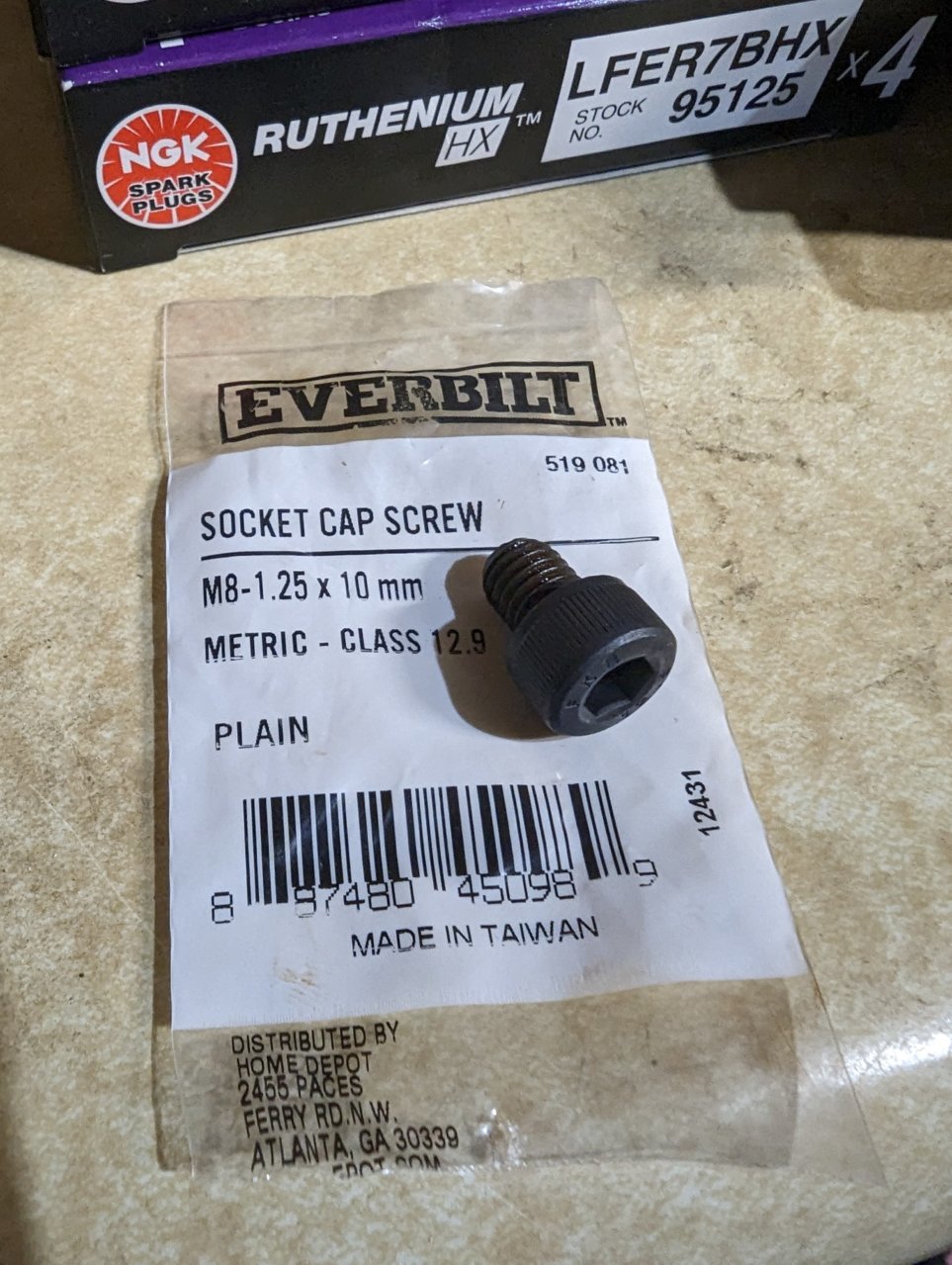

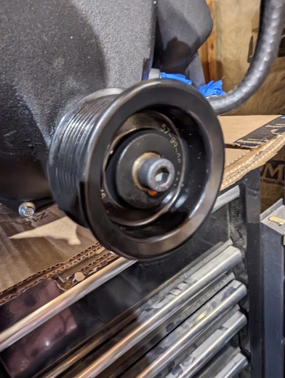

    To get the pulley off without damaging the threads
    $1.25 at home Depot, M8 x 1.25 x 10m

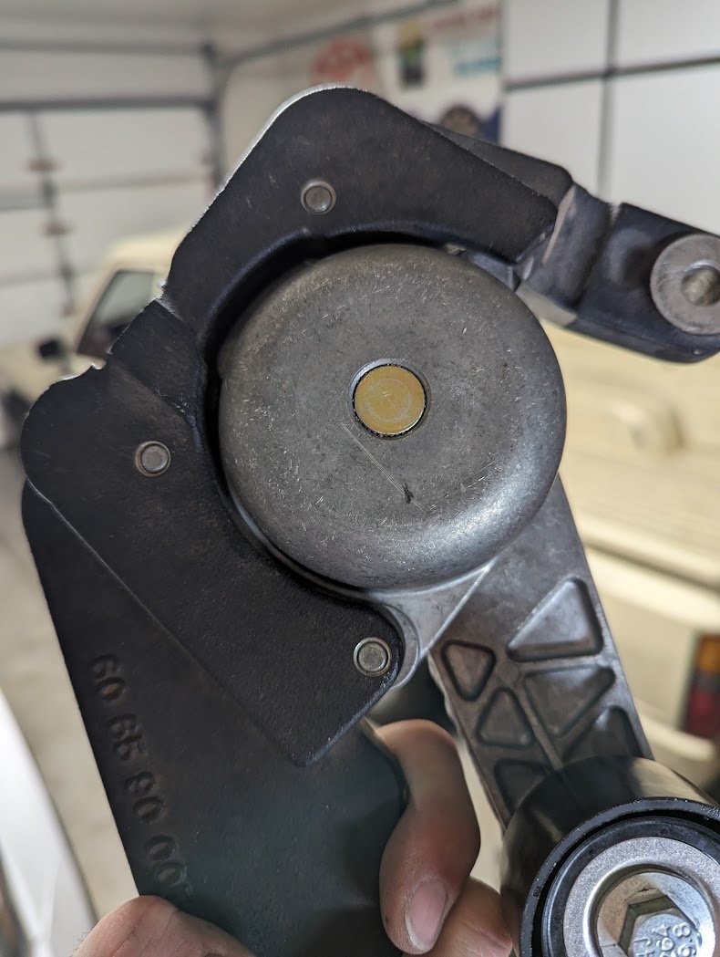

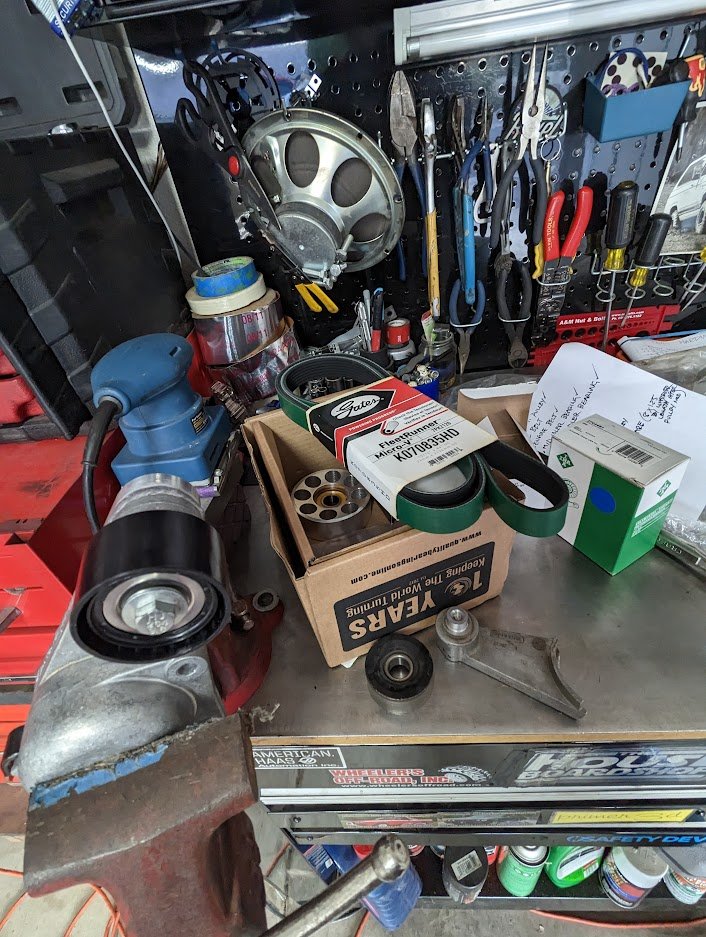

    Everything has shown up besides the blower belt.. that should be here tomorrow at Napa.
    I'm working on modifying the Steeda tensioner to clear the Tacoma bracket now.. I cut the spring down, but the cast body is slightly different. @zscott I'm wondering what your solution was for that small portion? Looking back through this thread I see he is running the Steeda.. but little info on what the solution was. I will most likely grind down the cast on the tensioner just enough to clear the Tacoma bracket. I'll get more pics and update..

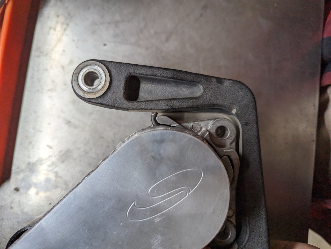

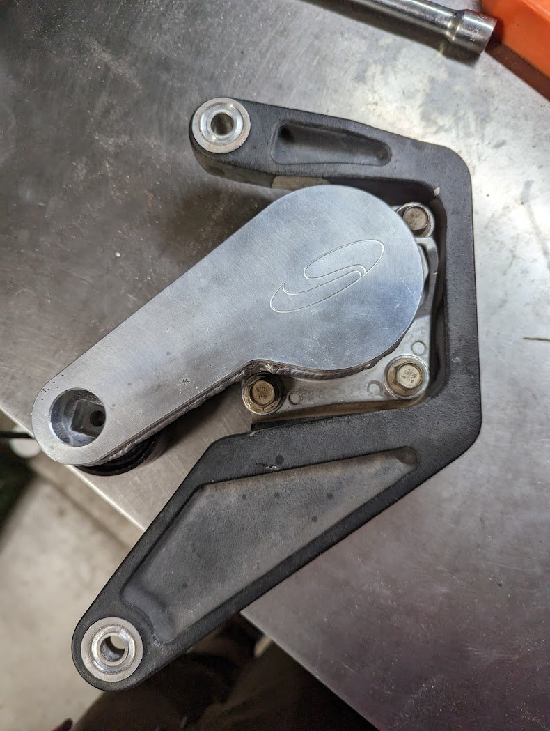

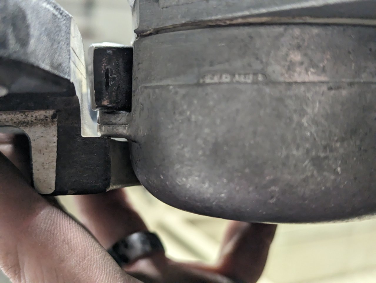

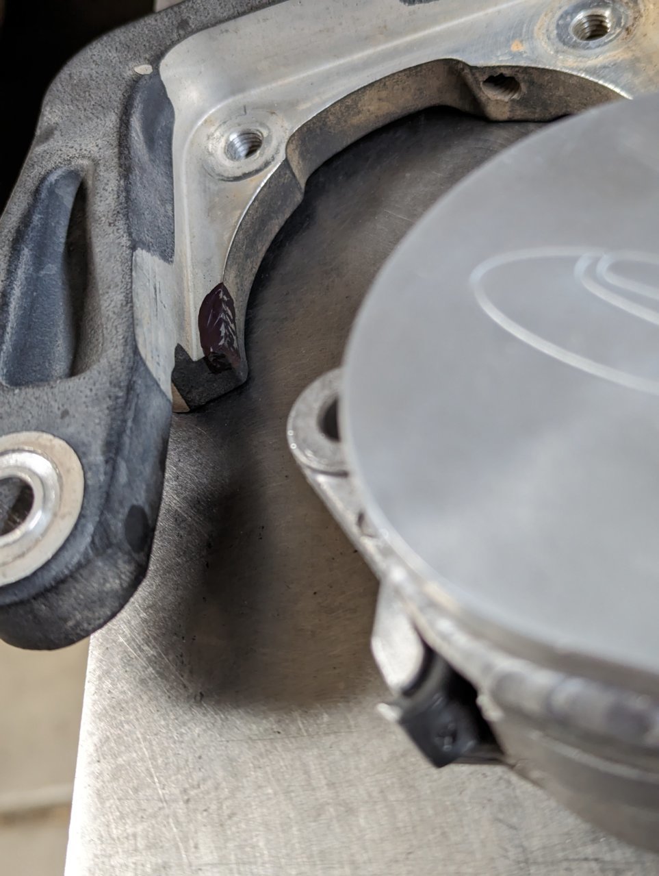

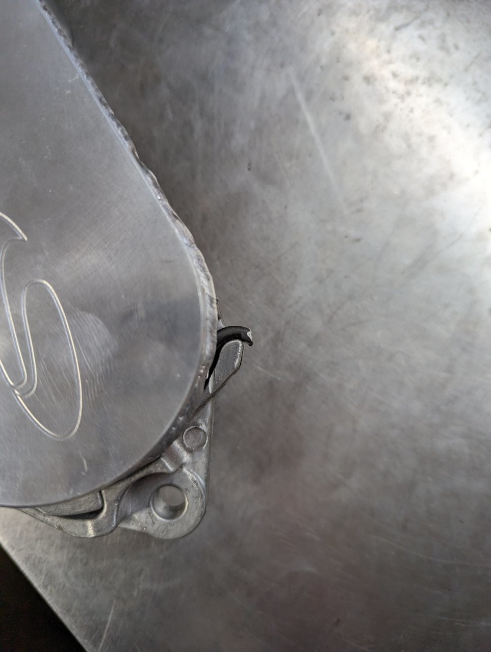

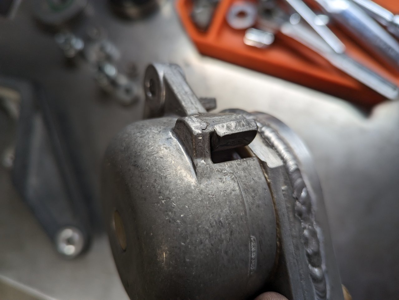

    After the spring was trimmed
    Clears the Tacoma bracket
    Holes line up
    This is the next interference
    This nub in the cast makes the Steeda not sit flat/flush into the Tacoma bracket. Grinding it down to the spring should allow it to clear.

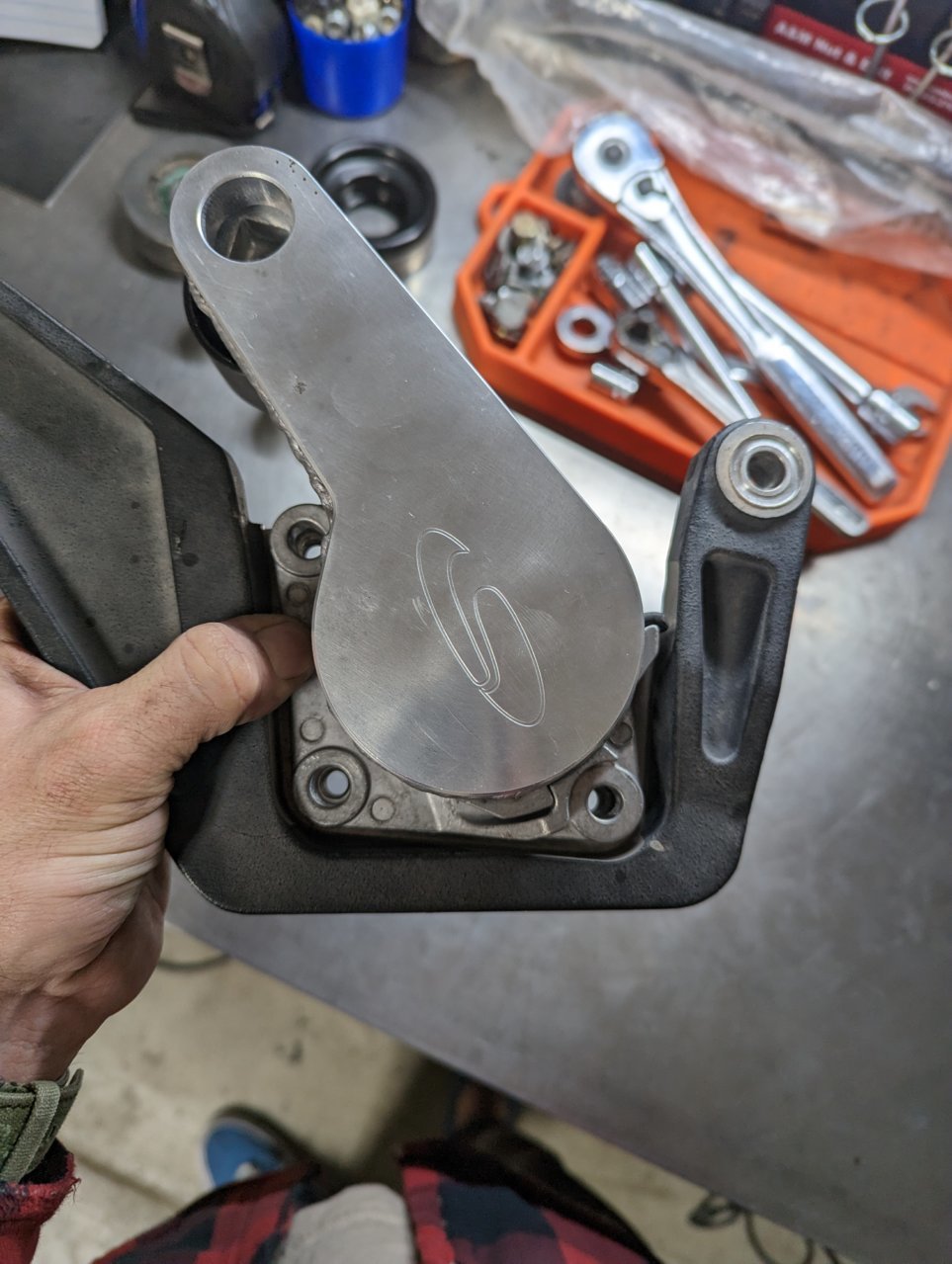

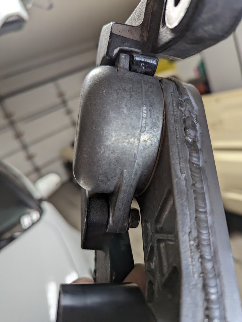

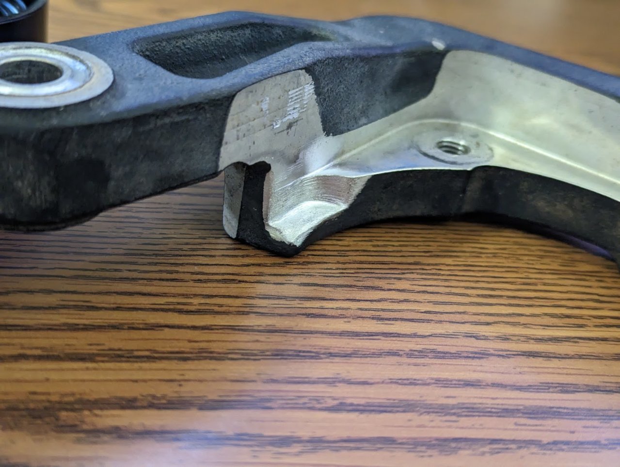

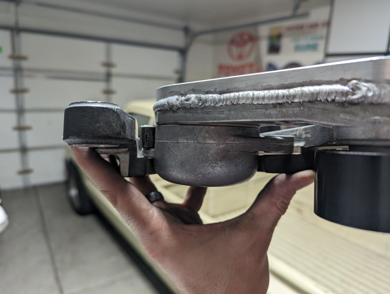

    Ok, I think I'm going to grind the Tacoma bracket instead actually..
    12TRDTacoma[OP] and jamesepoop like this.
  17. Jan 12, 2023 at 6:31 AM
    XPOTRPR
    XPOTRPR CNC Programmer/Machinist
    May 29, 2011
    #57449
    31,177
    Josh
    Chandler, AZ
    > BUILD LINKS >
    Here's the bracket after grinding down for clearance.
    tgNQlESF_KjTDpdppSTrsT8Nlj8cgk7EQCXpycSg_39dc41a1de0fb53575fbdd994c4fa954fc4c90e0.jpg
    EDwoZfofq1NL8sElEnFK1cOXAwUwgCVgRmIvUiXM_0f9bb7ce5a28475ef48086ee7d1d38d6407df6aa.jpg
    and the fit
    PiLFicQo4NxAACDUSijWzI8Wz0iwfxFi7nFONjZ1_ef61ba9d57709a062855b01284481a20494c791f.jpg
    mwjGZrgs5zQRLVrQH8-Re3-Yvg3Zls8gr6Q1ZOeQ_537b9c76fa3ec47ec6153ae834ea044c90ebcf42.jpg
    VPPED4odNj9eeiQyGsJxTT5gp3-fIhbZTlwmdZ-P_374814c2bff9f8394cdbf5410c9186154213389f.jpg
    egUmpUCHvbCgfyOQpR8nEV_dTKiuPusM4Uw8sZBe_8750e834fc22ed77dbf275386c3fcbb7a10723bc.jpg
