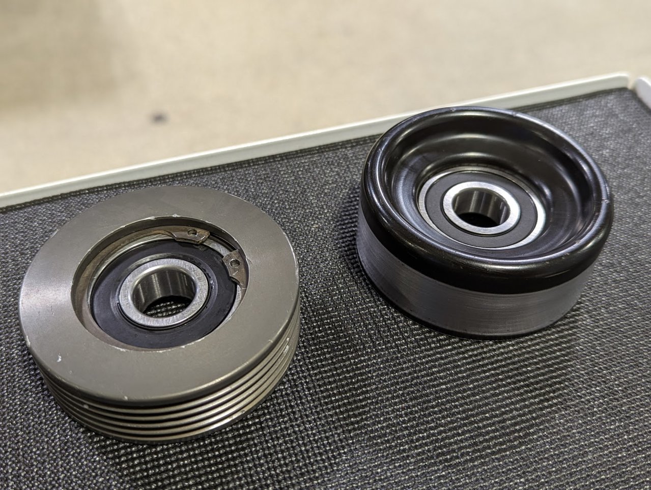

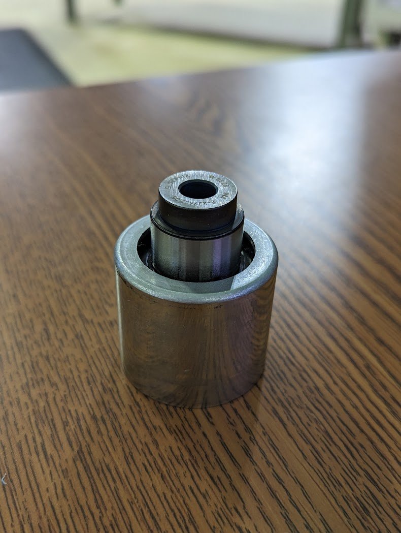

    Did you need a press to pull the old bearings out ?

    The first one I did (smooth/mid pulley) I used my vise at home, it wasnt terrible.. but I knew it wouldnt work for the lower pulley or for pressing back in. I brought everything into work and used the press to pop out the old lower bearing and then press both new bearings in. Definitely made it easier..

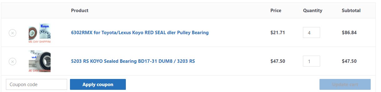

    Replacing all the bearings on the engine side as well, including the tensioner. From my research here on TW.. I gathered these part numbers and quantities. Anybody have any other recommendations or input before I order these? Thanks.

    I did all of the bearings (2 upper, 2 lower, and the tensioner) just with a vise at home. Freeze the bearings the night before helps a bit.

    You froze them? Geez, that's taking things a step too far considering every time I have done them I just whack out the old ones with a hammer and socket and press in the new ones with a socket and a vice and it all goes without a hitch.

    ive just done the socket and hammer deal. freeze the bearings, heat the receiving area, dab o grease no problem.
