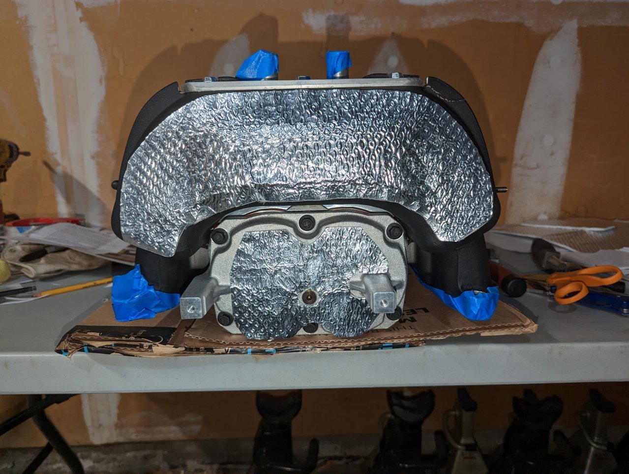

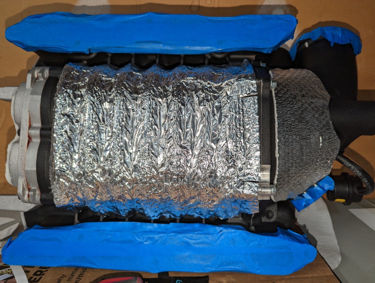

    Working on the Tundra over the next week. Bought some universal intake manifold heat shield to put around the supercharger

    question- if it has liquid cooling like our mp90 shouldnt it be just fine with no additional insulating help?

    when the belt goes its a very likely piece to get hammered. i understand the 1st ones sold dont fit.

    Yes, but the IAT still gets hot enough that people sometimes add an additional intercooler and wrap the lines. I've had a lot of downtime with the s/c and figured why not. Also I'm kinda going balls to the wall with this build. Everything is basically getting maxed from the get go.
    Tiniest pulley, largest injectors, and fuel pump, custom fuel lines ect

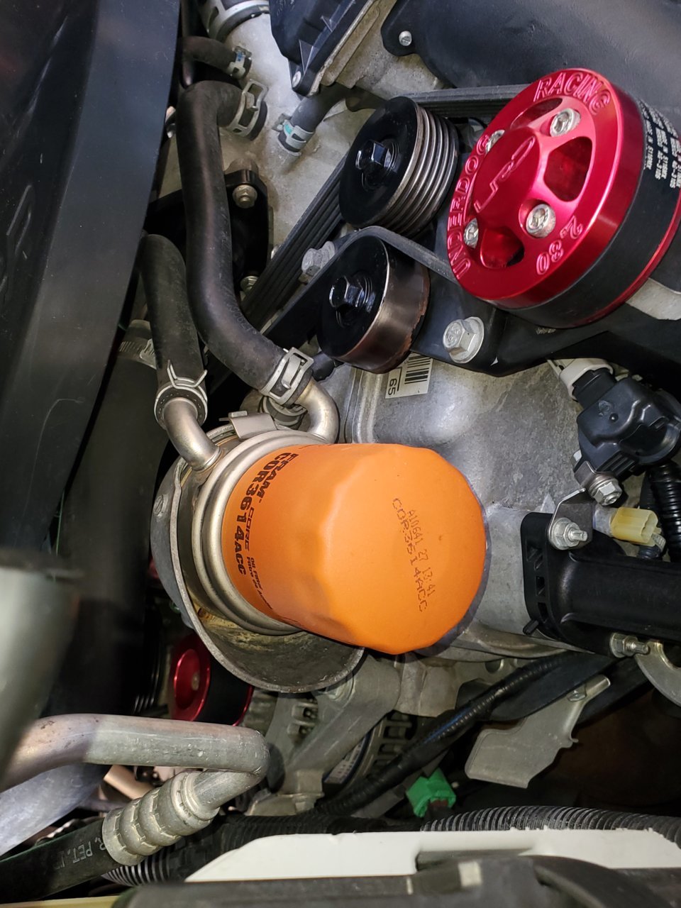

    100% percent red except the supercharger crank pulley that I ordered red and NST sent it black telling me red was on back order.
