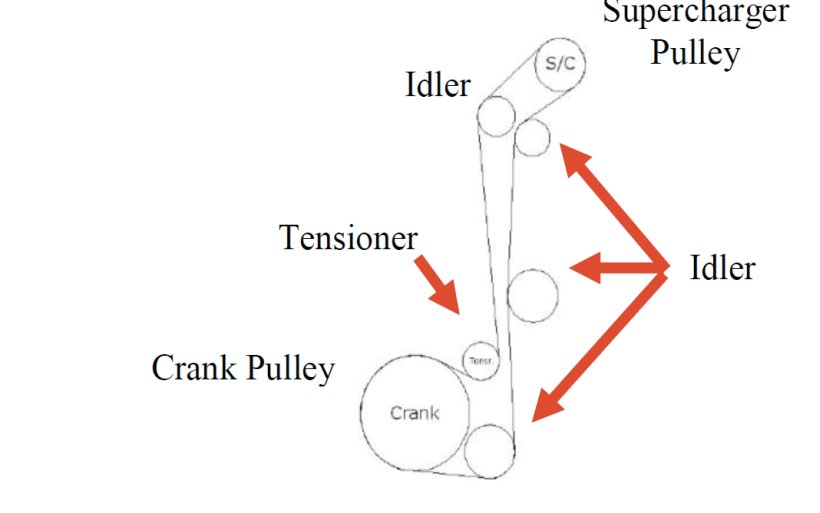

    Here is one I didn't know existed boys. SCOL makes two idlers which are double bearing, ribbed and smooth for the upper idler pulleys and you can also use the smooth one for the tensioner apparently, as it is the same size as OE... I just installed my two uppers today. Thanks for promptly shipping them over @jamesepoop !! What I did not know is that they make the lowest 3" pulley which rides right next to the supercharger crank driven pulley. That is the most critical one as it sees the most speed and wind up from the supercharger crank pulley itself.
    We now have three viable replacement solutions if anyone ever needs replacements for the lower idler:
    - OE 3" (C4) gray colored pulley
    - Dayco 2.8" pulley (the one on Page 1 I have posted about before and run on my own)
    - SCOL 3" (C4 direct replacement alternative) double bearing pulley
    A link for those who either want to take a look at it or pick one up from them:
    https://superchargersonline.com/pro...-or-magnuson-supercharger-replaces-c4-pulley/
    Just do me a favor and save one for me for when I pull off the tensioner assembly again please. :)

    Correct me if I am wrong but in this case then, we should be able to swap all the pulleys to a double roller with the exception of one?superchargerbeltandpulley.jpg
    Basically all of them with the exception of that middle idler?
    TodayWasTHeDaY likes this.

    That is 100% correct! :headbang:
    This might be our magic bullet to dealing with yearly idler bearing replacements!
    4/5 pulleys replaced with well built units for the intended purposes we use them for?! Imagine that!
