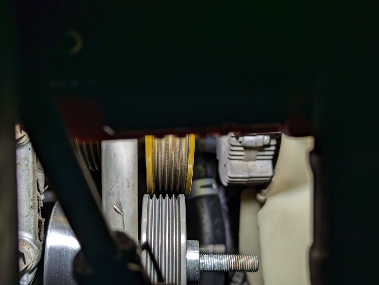

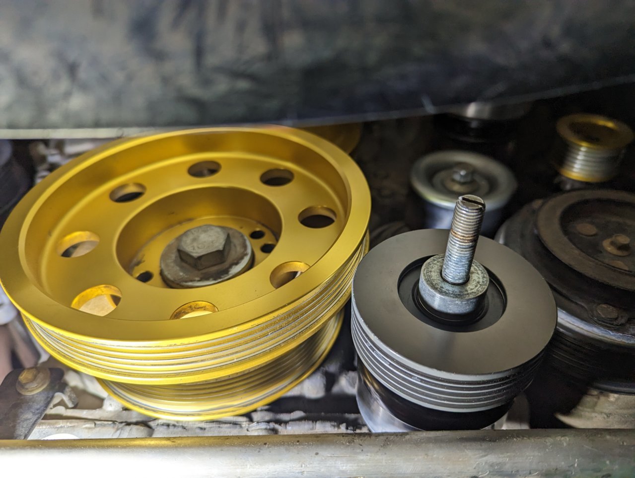

    For you guys that have swapped bearings in the idlers.. I just want to confirm that these replacement 6302 bearings (x2) will work for this double bearing setup in the lower idler. The OEM bearing inner sleeve is proud on both sides of the bearings and I'm wondering if the spacing it creates when bolted up is critical. If I'll need a spacer if some sort. Etc

    Correct. That's my Idler #1. I'm going to need to get some washers/spacers to get the stack up correct. As of now, it's causing my s/c idler that mounts on that same stud to be out of position.

    Easy fix

    Lots of moving pieces (part numbers and revisions) for the bearings and stuff. Glad this is all that I need to mess with out of everything.
