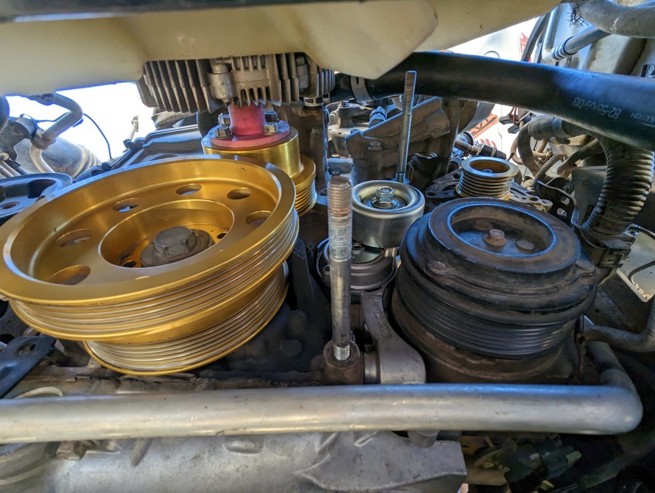

    Got the truck back together. New Engine tensioner was definitely a pita and tedious to get swapped in. But I was a little lazy and worked around things. Unbolted and move the Alternator and AC Compressor out of the way. Just held out of the way with wire. Pulley wrap mod seems to be working well.. thanks @BillDaCat8 All belts went on no problem. The new Steeda tensioner does take up some more room and gets close to the fan clutch, but seems to be just fine. Getting a 1/2” ratchet into the Steeda requires an extension, which then put the ratchet too close to the fan clutch to get out after the tensioner and belt were in place. Had to loosen the 4 bolts for the fan to get enough room to get the ratchet out. A different ratchet combo/setup would probably work without having to do that. Engine runs much smoother and quieter with all the new bearings now obviously. Got some trips planned very soon so we'll see how it does.
