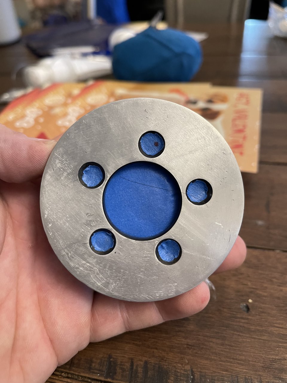

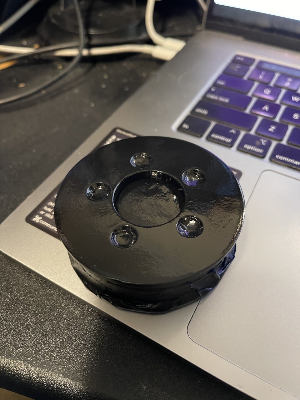

    Operation no more pulley boys. I have a spot I may get it engraved but for now it’s cleaned and some black engine paint. Once it’s cured for a few days I’m going to smooth it out with some high grit.
    forgot to snap a photo so here is an old one when I was installing it ( eventually pushed on farther. )
    0263D7EE-53CF-41C6-AD7B-C826A5272B47.png 63AEDF53-6055-4FB5-A541-7873A8B81F31.jpg B3F4E4B4-B108-482D-9C71-FB90113EF06C.jpg

    Toss it in the oven for 15 minutes at a time to speed up the curing process and also to help the paint set in a little harder than it otherwise would be able to.
    200 degrees for 15 min. oughta do it. Do it 2 or 3 times after giving the pulley plenty of time to cool down. I do it to all the stuff I paint. You can cut up an old brass clothes hanger wire and use it to hang the pulley in the air off one of the oven racks.

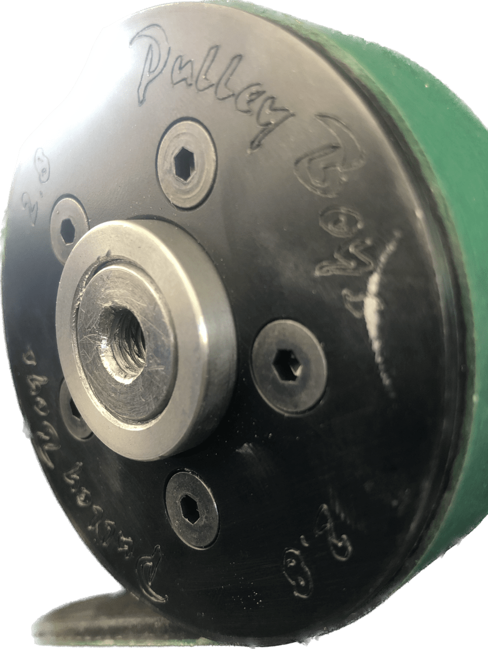

    the dullish marks on the edges are normal. The scratches look like some shit went through there.

    good call I was thinking if i had some hardener to help speed this up it would be great. Ill run that a few times. After 3 or so times should be good to buff out and clean up? Id rather not wait several days to do it so this is a nice tip.
