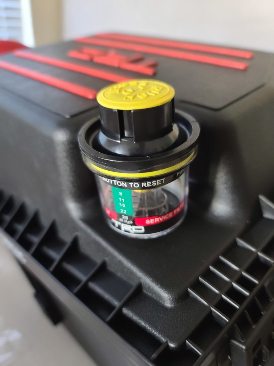

    Dumb question but does this "service filter" thing actually do anything? I push the button on top and nothing really happens?

    It looks like a visual vacuum indicator. When it is installed on the truck and the truck is RUNNING (probably at idle), it would create a vacuum that would pull that down. If it were sticking at all, that is how pressing down on it would reset it. I’m guessing there is a spring inside of it as well, which puts it back to zero making you think it isn’t doing anything.
    And why would this matter? If the filter was dirty, it wouldn’t allow as much air through as a clean/new filter, so the vacuum of the engine gasping for air would be greater- indicating visually that you need to clean or replace the filter.

    Gotcha. That makes sense I suppose :) I'm OCD so I'll be cleaning it frequently as it is lol

    If it’s clean, nothing happens. When it’s dirty, the diaphgram goes down and tell you when to wash or change the filter. Pops up then if you press the button.
