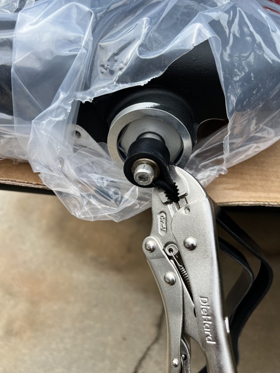

    I got my stock pulley off, but how the hell do I get the allen bolt out of the shaft now. The puller tool tightened the bolt pretty snug :annoyed:

    I got it now, just had to think for a minute which isn’t my strong suit :rofl:. The head got a little deformed so I had to hammer the key in and use my impact while twisting the belt with the vise grips.

    I’m swapping the 2.7 pulley on now before I install, figured it would be easier to just go ahead and do it. Already installed an AEM 320 lph fuel pump and got my ECU back from JustDSM yesterday with the TRD calibration. This thread has been a huge help, I have been lurking for a long time.

    Well that sucks. I‘m not sure I got it on far enough, sticking out about 1/16”. I heated it to 350° for an hour and worked as fast as I could, but it was really tight.

    Yeah it needs to be atleast be flush, I think.
    And u should have gotten the quick change pulleys.

    That's frustrating. What install tool were you using?

    The URD tool
