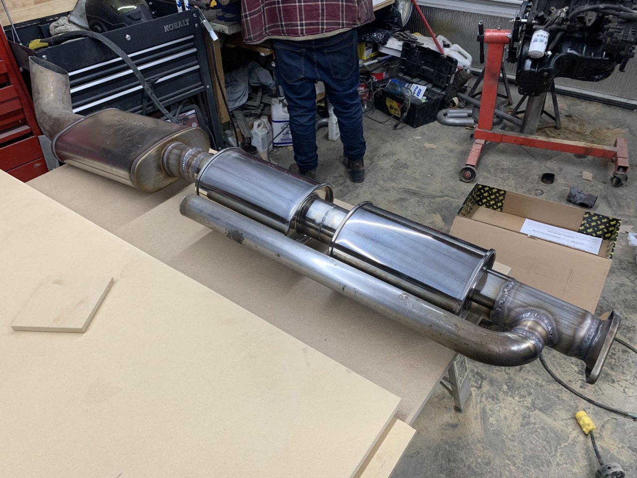

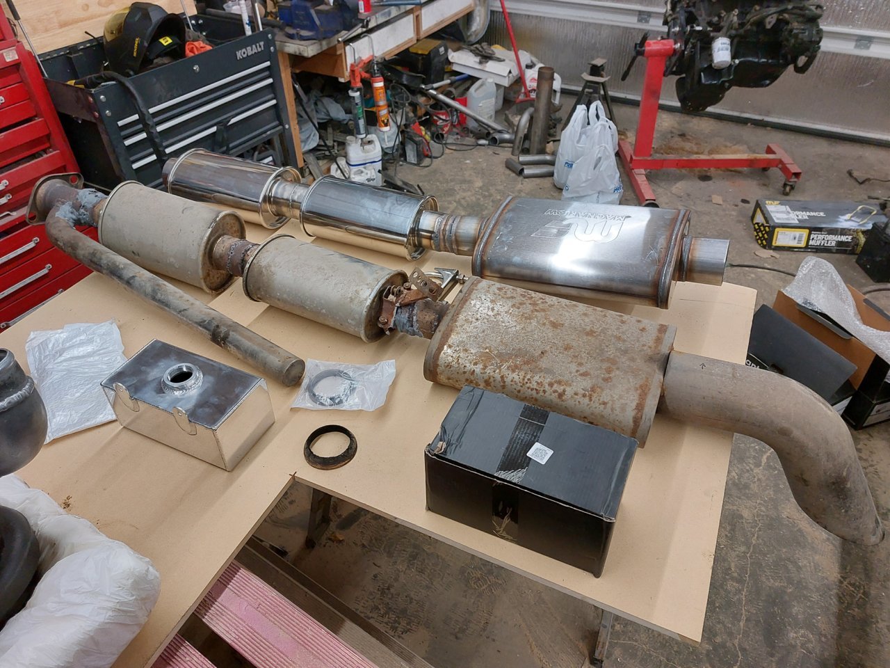

    I finally replaced my 2.5" exhaust with a 3". It's a nice note, I will be sending sound clips soon.
    This is surprising to me: in the winter I lose a couple of pounds of boost - didn't think much of it, kind of makes sense with the denser air, etc. But after I put this on I picked back up those couple of pounds! Not sure how that all would work thermodynamically, but that's a cool story if I does say so myself.

    How do you like that helmholtz resonator?

    Do you find your Helmholtz resonator chamber effective?

    Minorly. It has resonant frequency ranges at various points in the band - e.g. for about 400rpm centered on the 2200rpm range and again further up. Unfortunately it's pretty droney at the speed limit on highways (I always drive the speed limit because I'm an old man who wants to save his money and demerit points), so I am thinking of making it adjustable so I can tune it to the right frequency.
    Question then for you guys actually, would a longer or shorter one be better for 2500-ish RPM?
