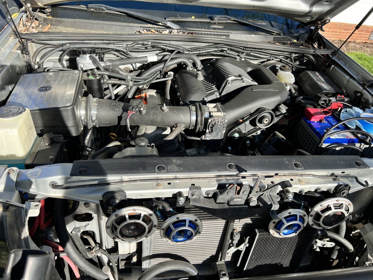

    I’m winding down on my install. I’m going to wire the coolant pump next. I believe the instructions call for it to connect to the fuel pump circuit. Does anyone recall a better fuse slot so that it won’t kick on when the fuel pump cycles while parked?

    Must be getting old. Those charge pipes are an eye sore in polished

    I don't think there's one under the hood but I could be wrong. I did a fuse tap into an ignition controlled fuse in the cab and used that to trigger the relay.

    Na, not just you. Imo it's not how I would route it but not my project.

    On the Tundra, and it's the exact same pump, instructions have us wire it to the IGN fuse, and is only on when truck is on.

    I wired to fog light relay in fuse box iirc to avoid that problem.
    I’ll have to double check and get back to you but like 98% positive that’s what I ended up doing
