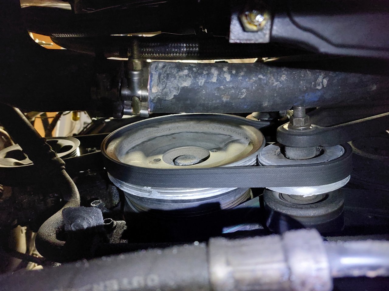

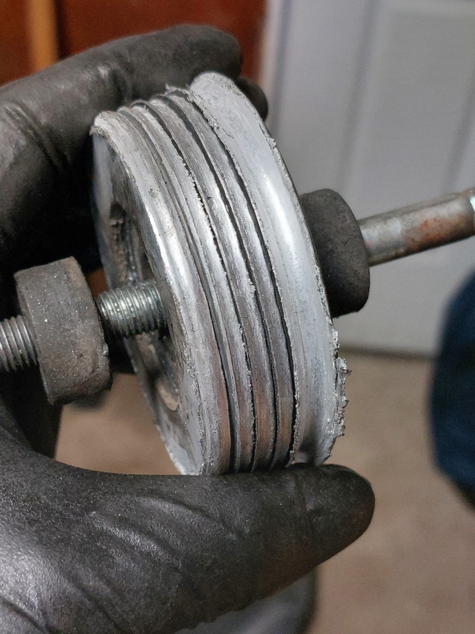

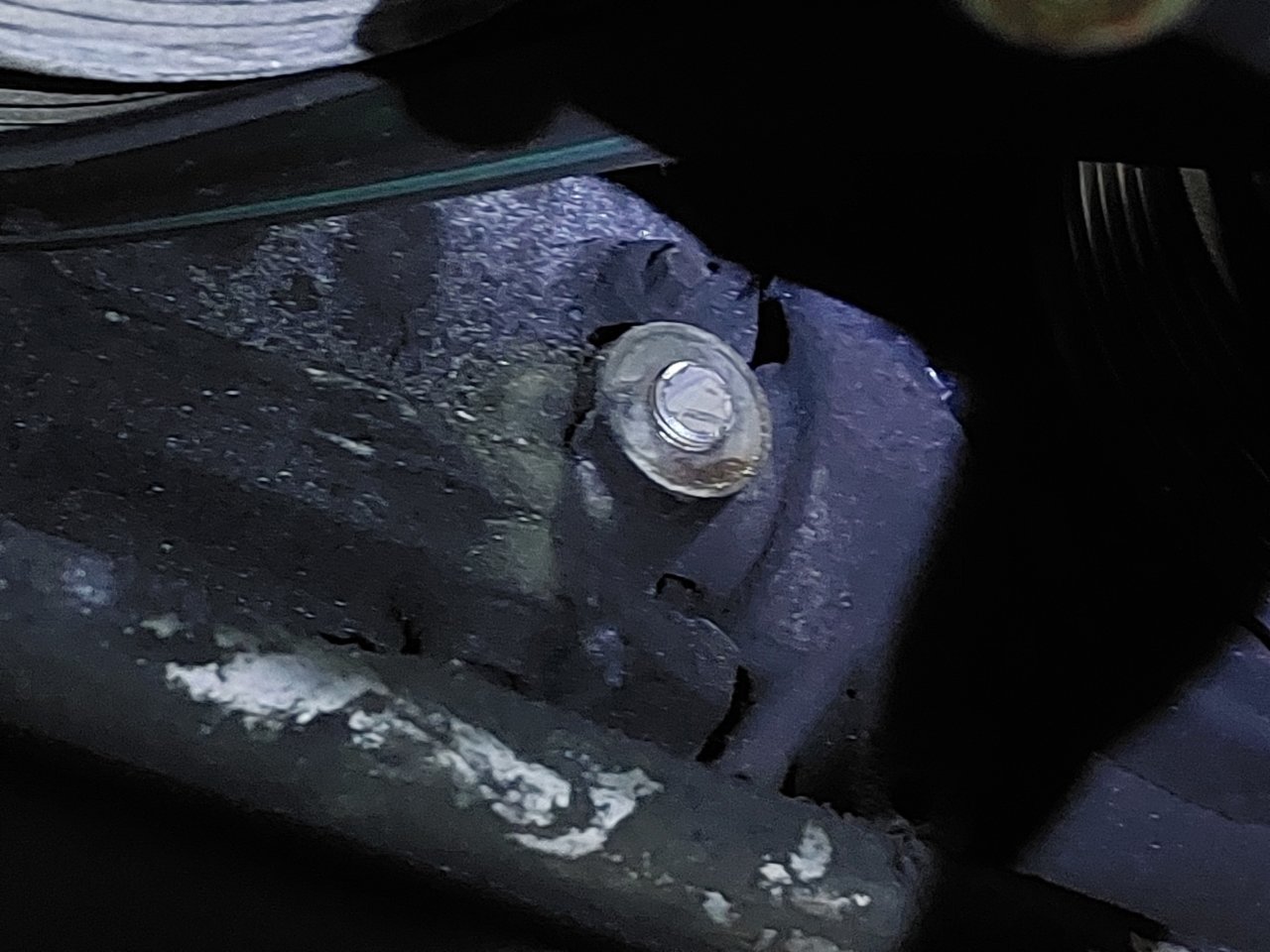

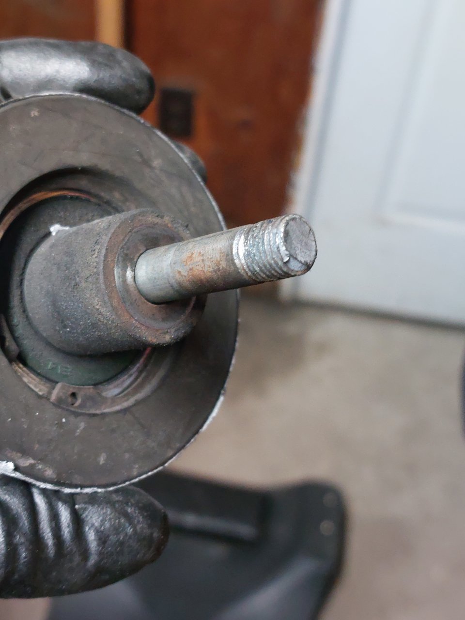

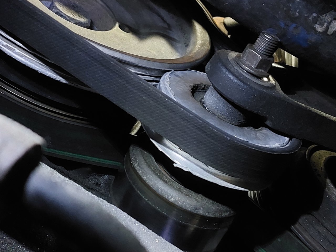

    I never thought it would happen to me!
    First time I've ever had to get towed since I bought it in 2010. NGL I'm a little miffed that the streak is over. Thankful it didn't happen on the road trip I'd returned from literally 15 minutes earlier - hadn't even gotten home yet.

    :eek: yuck. Is this the same threaded shaft that has snapped on a few other guys?
    Athlaos likes this.

    Yes as far as I understand it!
    Also, @12TRDTacoma I am looking at the SC Online website - I can't see these stud replacements for sale (part number M-71-76-10-134 per Page 1). Does you or anyone have another source for these?

    Booo.. I was one of the few that just went through this. I'll dig up what I found/ordered...
    EDIT: I contacted them about ordering just the S/C idler studs.. and they got back to me with part numbers and price for just those. I would email them and just ask. I ended up replacing the entire tensioner assembly when mine snapped, and that came with a new bolt.

    What was damaged when yours snapped? The crank pulley supported the idler so things didn't completely come apart - and somehow miraculously my belts didn't snap. But I need a new crank pulley and idler. I ordered NST for the crank pulley so that's exciting.
