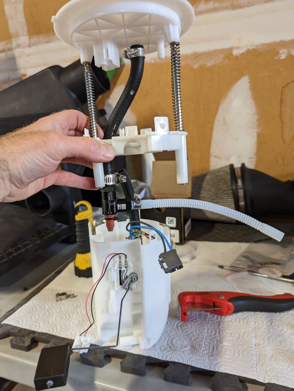

    Going with the AEM 320 pump which should be plenty for my needs ... unless you guys throw up some red flag about it ?

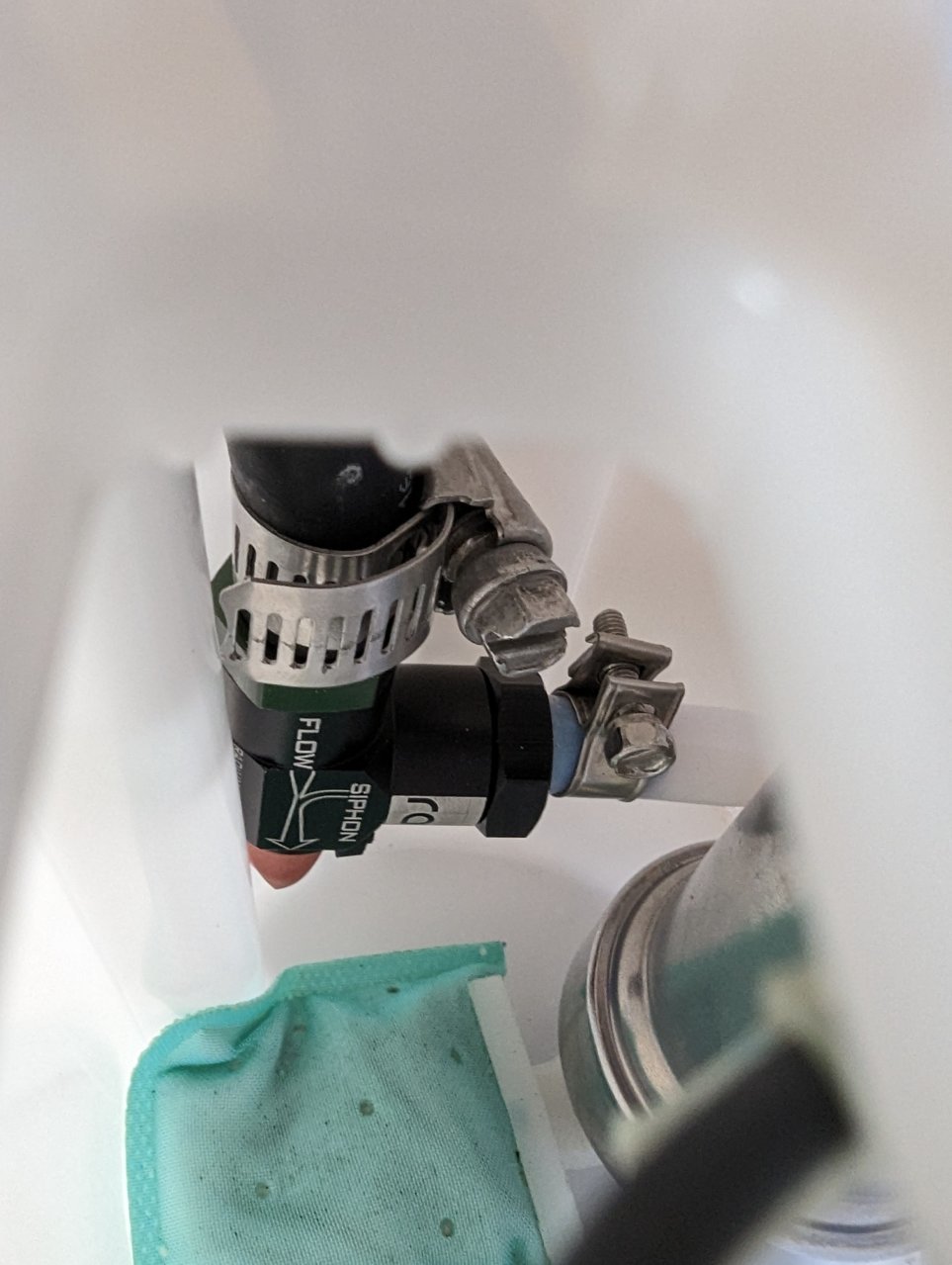

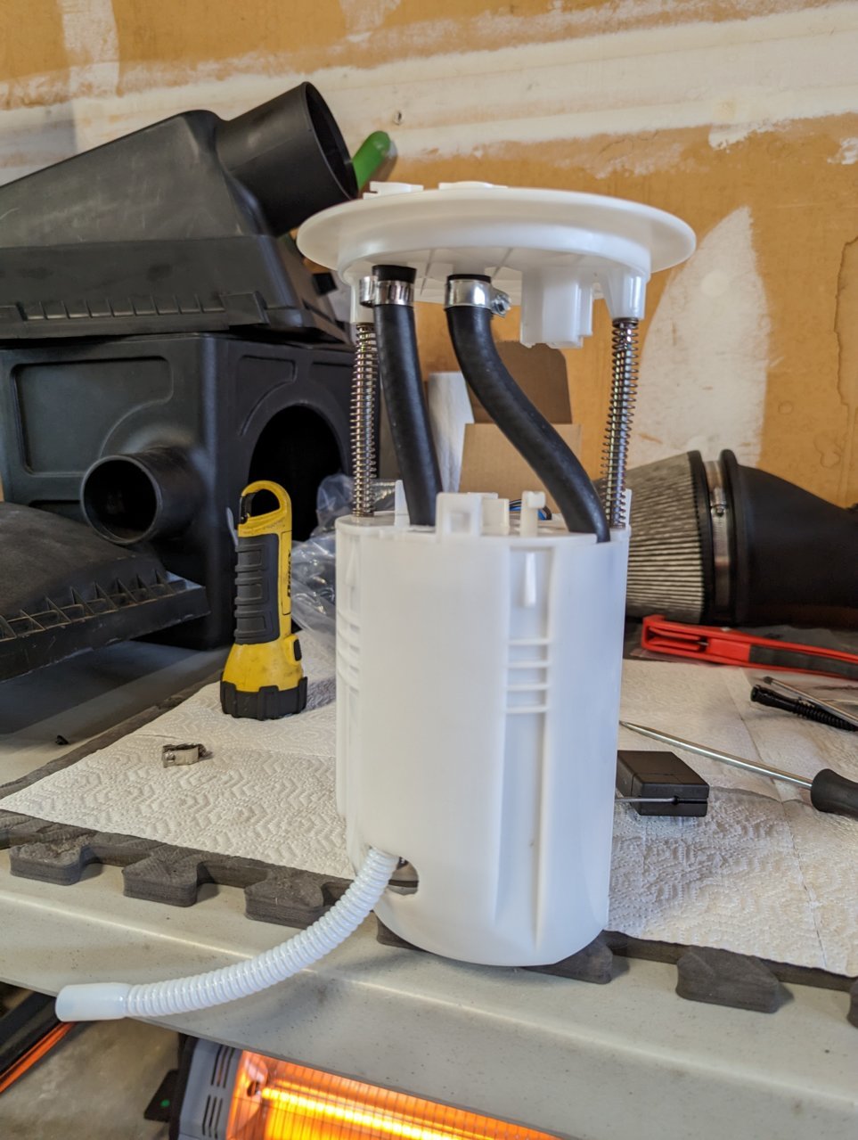

    Can I suggest the Radium Venturi pump to be added with it! When doing these pump upgrades, you make the factory jet pump essentially useless. Very simple install. I just did it to the Tundra. It creates a syphon effect to pull in fuel from outside the pump basket to inside it.
    http://www.radiumauto.com/Venturi-Jet-Pump-Kit-P760.aspx

    8 years later and lord knows how many thousands of miles on the AEM 320. I am INCREDIBLY satisfied with it's longevity and build quality. You have my blessing to run it for sure.

    Aem 320 is a good pump. I'm switching to a walbro 525 in the Tacoma and reinstalling the aem to my 4runner

    It especially helps if you're doing WOT pulls with lower levels of gas

    I think this can be attached to the holley hydromat to increase its effectiveness. In theory anyway.

    Kinda depends on the tank and how the bottom is shaped. Not sure I could fit one in the Tundra tank. Definitely on flat aftermarket tanks

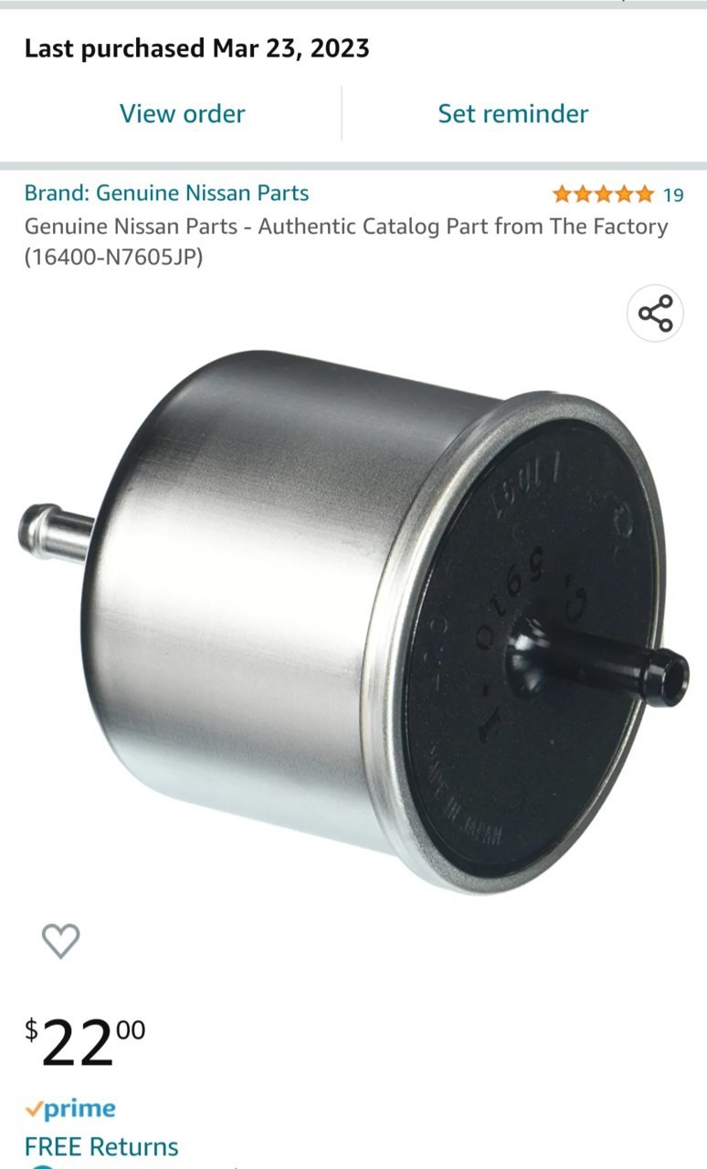

    I knew about the urd upgraded fittings thread. Didnt know if there was an upgraded filter thread.
    https://www.tacomaworld.com/threads/urd-fuel-pump-upgrade-fittings.506526/
    I'm due to replace the urd fuel filter. Going to look into that nissan part. Thx @Athlaos
    (Just purchased. Amazon prime $22 shipped)

    Should be.. :notsure:
    Canadian Amazon must be too busy listing hockey sticks and pucks. :p:D
