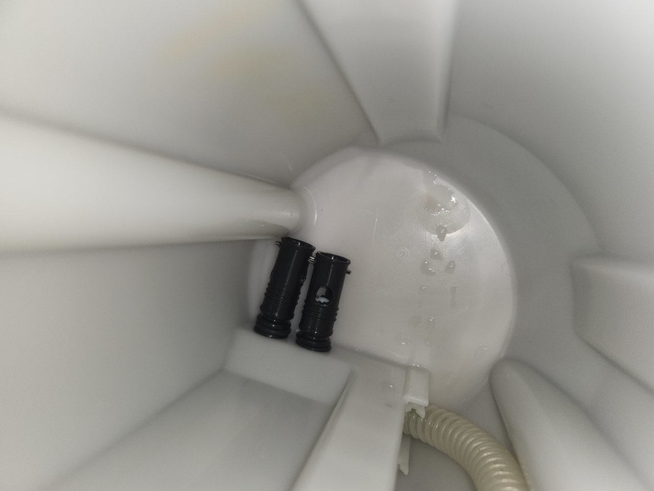

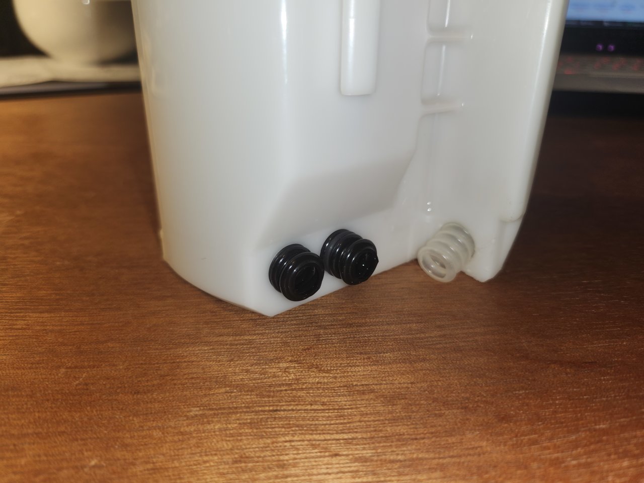

    With a long enough PTFE tube on the siphon side, absolutely! This thing works great at keeping the basket full, I enlarged my stock inlet hole and snaked it through that. I also made a couple of ball check valves to allow more fuel in and try to prevent fuel leakage out of the basket.

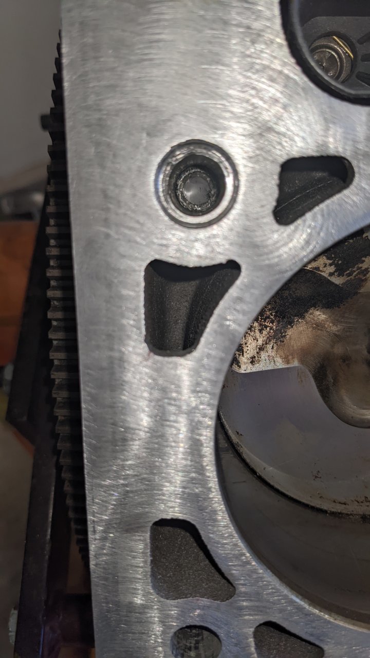

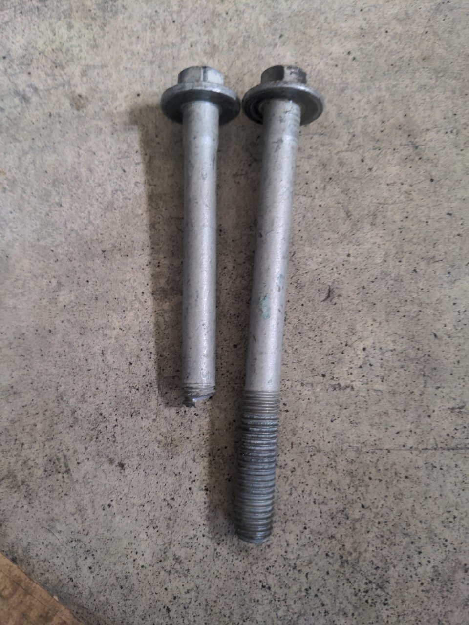

    Alright boys. Back on my broken bolt crusade. As usual I seem to always get the bad luck, as this time I'm dealing with a broken head bolt inside of my GM LT block assembly. Local machine shops are a no go and this lady who a lot of places use is probably a no go as well because she is super flaky, so that leaves me to my own devices.
    I got about 2" worth of depth to deal with before I touch the broken bolt itself and 1.5" worth of bolt that is stuck up in there. Here are some photos of the damage.
    Anyone got any ideas on what the heck I could use to get this thing out of there? Worse... These idiots at GM put loctite on all their crap too. Which may further complicate things. I HATE TTY bolts.

    The Hinge Sighting Drill with left handed drill bit sounds promising, never heard of the hinge sighting attachment before. Lots of next day options on Amazon
    https://www.amazon.com/6pcs-Hinge-D...ds=hinge+sighting+drill&qid=1681412184&sr=8-5
    https://www.youtube.com/watch?v=dJfkCj3FWBs

    When it snaps like that, you don't have to worry about the bolt clamping so usually it's fairly easy to remove. But that loctite might make it at least more annoying. I'd get a pen torch and craftsmen easy out. I used one on my broke block

    That's my worry is the loctite. Of course the depth is what is also sort of worrying me as well. I have a torch but no way will it reach that deep. (Then again, it might) the bolt was somewhere around 60-65 ft lbs when it snapped so I am thinking it should indeed be easy to get out, but it's a matter of getting a hold of it in the first place.

    maybe a center punch on it before extraction with a hammer tap could break the loctite bond to make for an easier removal. an obvious idea but all i could think of if i were doing that.
