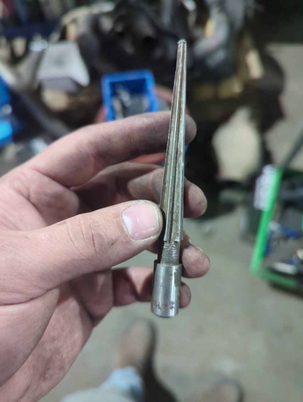

    @12TRDTacoma I have a friend here who is very experienced at extracting annoying broken bolts - his recommendation was use some heat and penetrating lube first, then drill a hole and pound a stud remover into it. If that doesn't work, then keep enlarging the hole until you can fold the threads in on themselves. Hope that helps a bit.
  14. Apr 14, 2023 at 12:05 PM
    12TRDTacoma
    12TRDTacoma [OP] Powered by Ford, GM, VW, and Mercedes
    Aug 20, 2012
    #85133
    16,671
    Rob
    Concordia
    12 TRD Sport DCLB 4x4 Supercharged
    Boosted
    I actually got it taken care of yesterday thank God. I was given this very same advice by the person who took care of it for me. They said to shock the bolt and spray some lube in there even if the threads are not rusted or corroded as it can greatly aid with the extraction process. Problem was the threads were so deep into the block that I had no tool that would reach that far and I really didn't want to touch it for that reason out of the fear of making it worse.

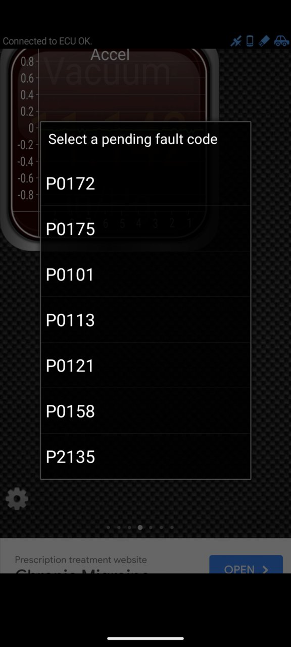

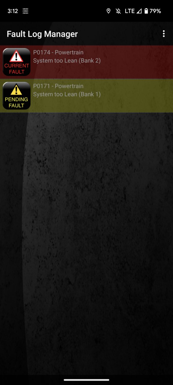

    Just got these after driving on the highway for a bit..

    How much is a bit? I have received the same codes as you trying to accelerate in D/5th. I feel like yours is manual though. I tend to get a plethora when I don't warm up properly.

    It's Auto. But about 30 miles.. popped up after getting off the highway and leaving the first stop light.

    MAF/intake related. Those are due to fuel trims being too far out. Could also be an exhaust leak pre-primary O2.
