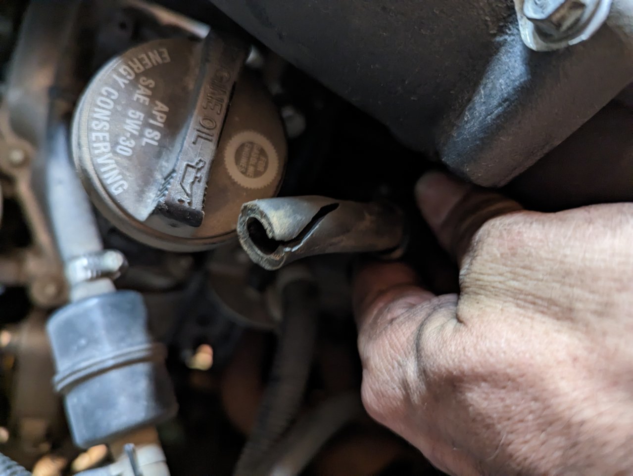

    Found the issue. This vacuum line blew. Cut it back about 1.5" and all good now.

    Leigh
    Edmonton
    2011 SR5 Manual TRD SC 1.87" pulley
    A flux retro-capacitance encabulator
    Where did that connect to?

    Fuel vapor hose to the VSV.

    That is a primary line too so that'll definitely do you in if it's jacked up. Good find!

    It must have just finally burst on that drive. It was pretty dry rotted and brittle at the end where I cut off. I could hear it clear as day too with the hood popped open and engine running.

    Toyota's and their EVAP and their primary vacuum hoses have a thing for dry rotting relatively quickly for some reason. I have noticed it brand wide throughout the generations, it doesn't affect just one model more than the other. It's sort of annoying but luckily they make their stuff pretty easy to access.

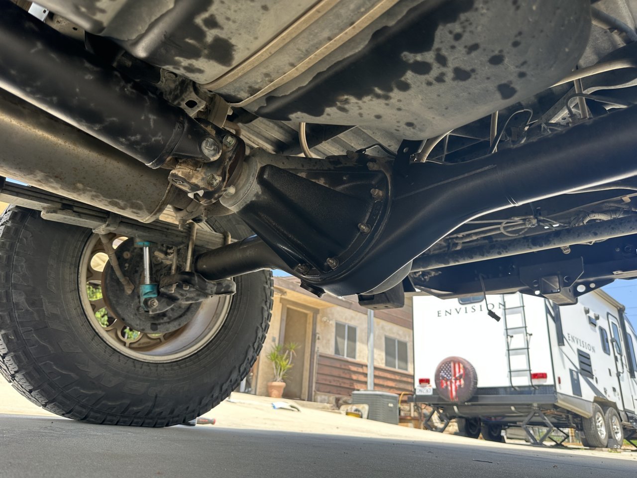

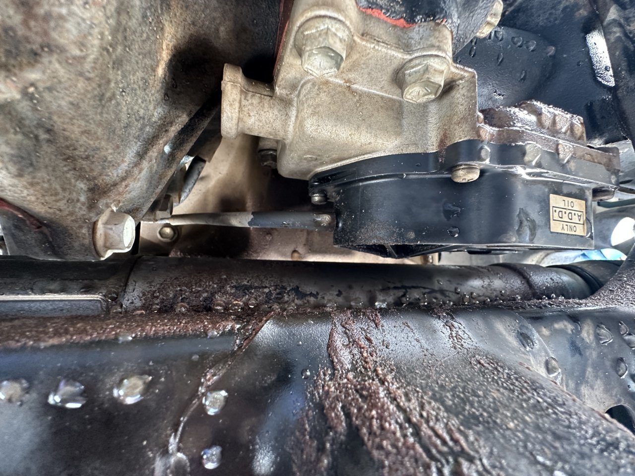

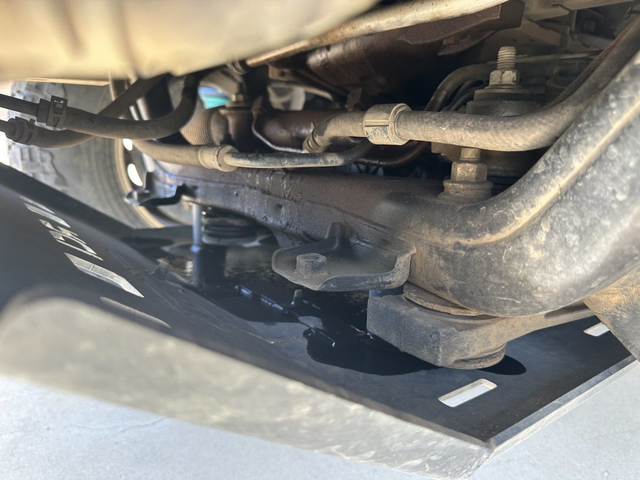

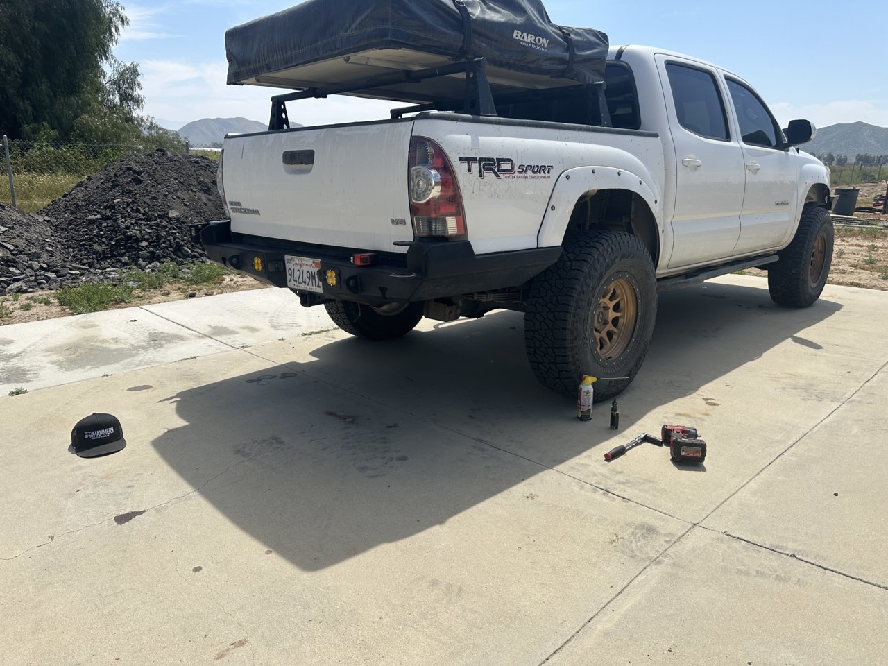

    Well if it’s not one thing it’s another right guys? I was installing this bumper
    Which made me notice… hmm why is my truck covered in oil
    B2F99267-701E-403F-A771-B73E44C41C4A.jpg 13D0C0FC-9E41-41A6-A095-B5F1DB1DE347.jpg
    Still not 100% sure where it’s coming from. My primary guess is crank seal. I noticed it was wet when I swapped my supercharger bearings. But literally everything was covered down there.. if anyone has gone through this before let me know what you think

  12. Apr 16, 2023 at 12:49 PM
    12TRDTacoma
    12TRDTacoma [OP] Powered by Ford, GM, VW, and Mercedes
    Aug 20, 2012
    #85133
    16,670
    Rob
    Concordia
    12 TRD Sport DCLB 4x4 Supercharged
    Boosted
    The crank seals on these engines are pretty shit honestly. You'd have to snap a better photo for me to be able to tell you yay or nay but I had something similar some time ago when mine was failing at like 50K.

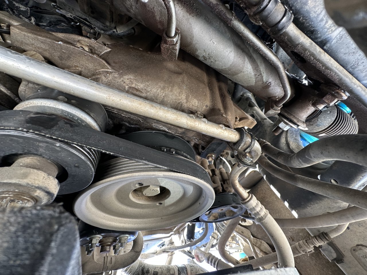

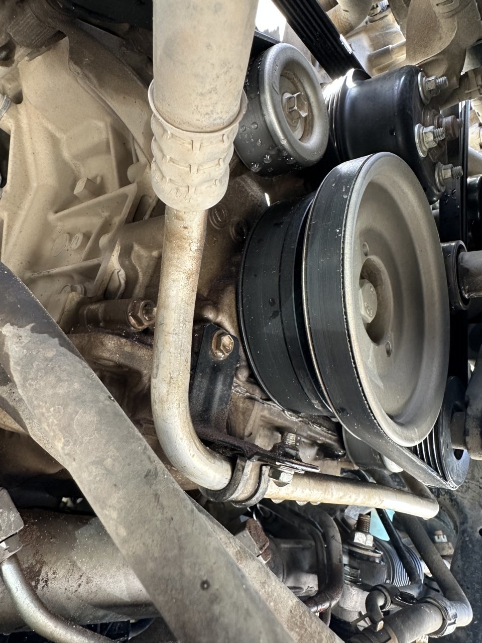

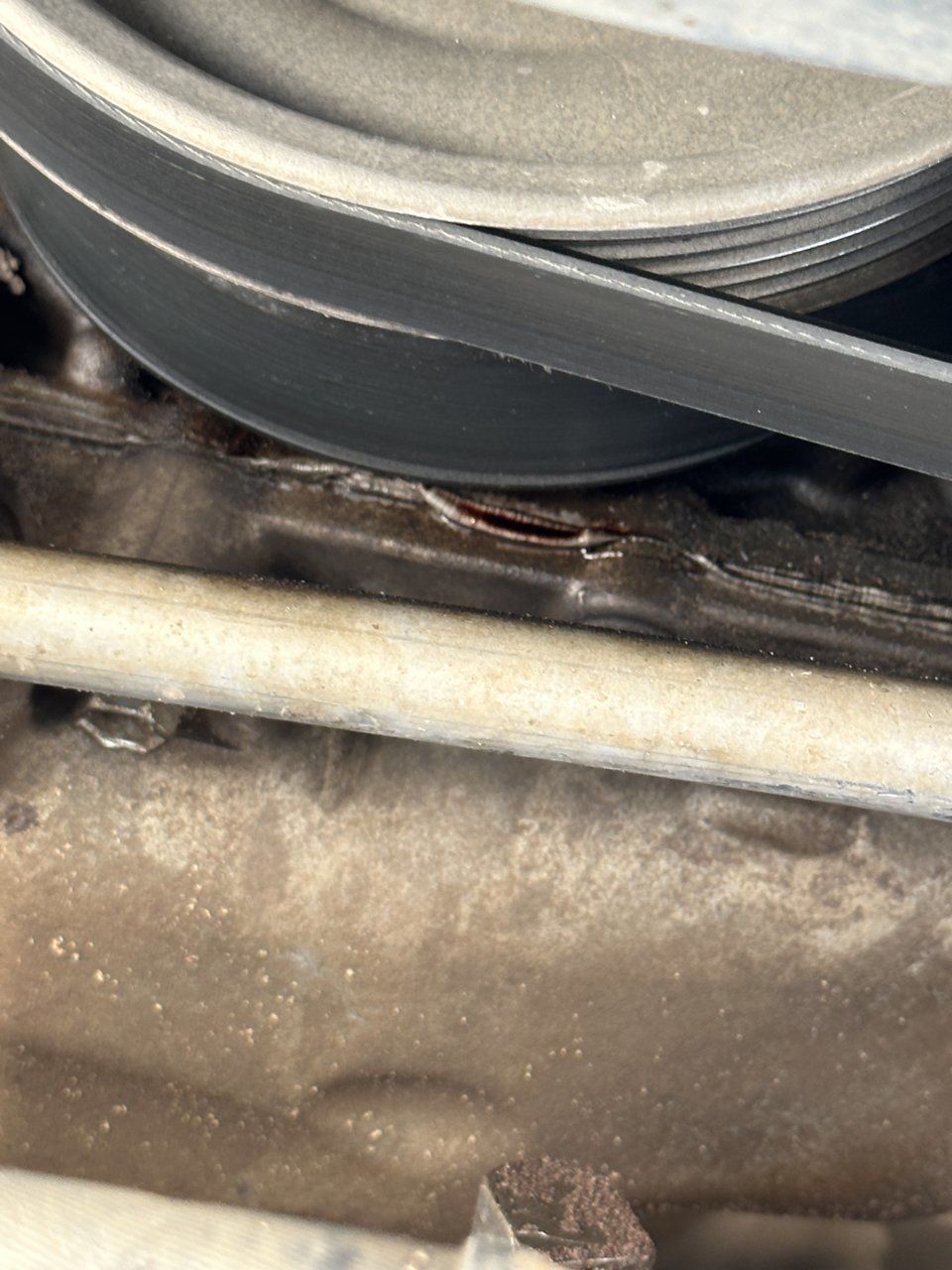

  13. Apr 16, 2023 at 1:00 PM
    Murphinator
    Murphinator Well-Known Member
    Mar 1, 2015
    #149903
    3,335
    Anthony
    SoCal
    14 DCSB 4x4
    Well these photos are not much better, but I am pretty certain it’s the crank pulley judging by the residue around it. Cleaning everything with all purpose cleaner and the water makes it a little harder to tell where it’s coming from, I might let it sit and run for a few minutes to see if it will start dripping.
    E3CED9D7-8DDB-4A91-97BD-81F6C4BCC391.jpg 5453B4CF-9725-4565-89CA-71F69D36C370.jpg 00F58C07-C04B-4DB3-8A04-DE44EBF48672.jpg

  15. Apr 16, 2023 at 1:23 PM
    jamesepoop
    jamesepoop Well-Known Member
    Feb 22, 2017
    #211394
    1,116
    California
    2007 Fj Cruiser
    This is why I did my timing cover and head gasket. All sorts of stuff wants to pop off. I'm going to shut it down and let these b*tches know, "I'm not the one."
  16. Apr 16, 2023 at 1:24 PM
    XPOTRPR
    XPOTRPR CNC Programmer/Machinist
    May 29, 2011
    #57449
    31,155
    Josh
    Chandler, AZ
    > BUILD LINKS >
    That's how my day went yesterday too @Murphinator .. drove out to swap LCAs with another member and ended blowing that hose.
    As far as your leak.. I had a similar drip/mist when the OEM crank pulley was cracked, back when I was taking it off and on. Replacing it with the NST set solved that. Another time was when I cracked my upper oil pan.. but yours looks more like the pulley/seal.

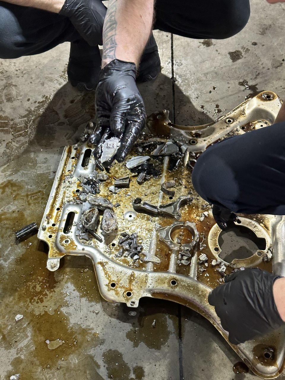

    TacoJova
    TacoJova Well-Known Member
    Feb 11, 2016
    #177914
    1,662
    Central Oregon
    21 Ram TRX Sold 2015 White DCSB Offroad
    Supercharger Hybrid audio stage 3 and stage 2 rear with 2 image Dynamics IDQ10's and alpine amps Bilstein 5100 with OME 887 Dakars and Icon 2.0 in the rear URD SPEC U Headers URD Y Pipe Borla muffler 18" Magnaflow Resonator Morimoto fogs
    Well I learned the limits on the 4.4 TT V8 :anonymous:
  18. Apr 16, 2023 at 3:05 PM
    Murphinator
    Mar 1, 2015
    #149903
    3,335
    Anthony
    SoCal
    14 DCSB 4x4
    Holy mother of God
    Norton likes this.
  19. Apr 16, 2023 at 3:06 PM
    Murphinator
    Mar 1, 2015
    #149903
    3,335
    Anthony
    SoCal
    14 DCSB 4x4
    After letting it run for about 20 min, no leaks. I parked it so the rear of the truck is higher, and let it sit. I see this small amount of residue so I’m thinking its probably crank seal. No other residues anywhere else
  20. Apr 16, 2023 at 3:43 PM
    henryp
    henryp Well-Known Member
    Jan 6, 2012
    #70080
    2,440
    Henry
    Montana
    '17 GX 460 and '09 Boosted Taco
    Form follows function
    Timing chain failure?
