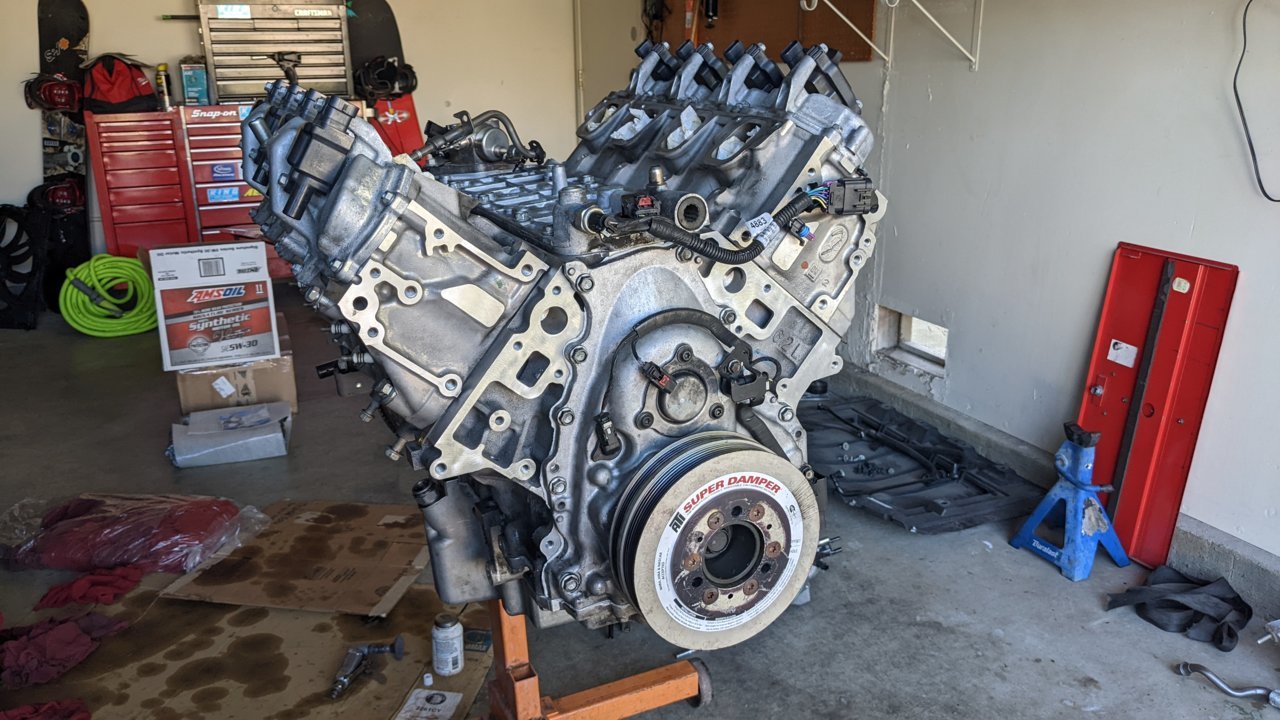

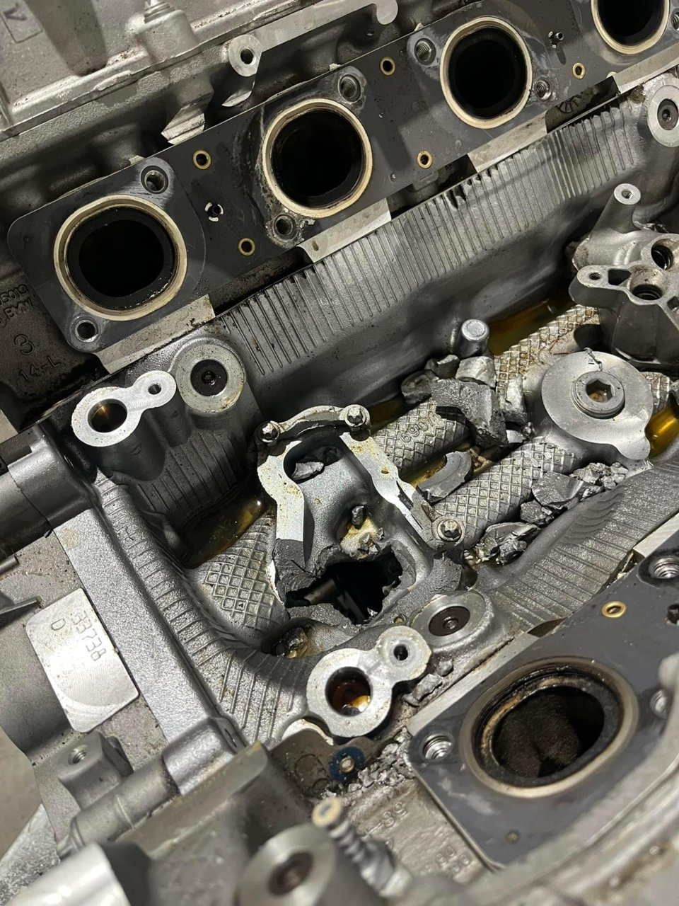

    IMG_9240.jpg IMG_9242.jpg Well for anyones entertainment

    What a beautiful disaster.
    I see you broke the hose for the vacuum pump. :boink:
    Were you running the 0W-30 oil or did you switch to a thicker weight?

    0w-40 If I remember correctly

    That tensioner bolt is a non issue as it doesn't experience the same severe duty that the main studs do, handling the entire load of the engine AND supercharger drive pulleys all on it plus the inertial load that it regularly sees from the main supercharger pulley.

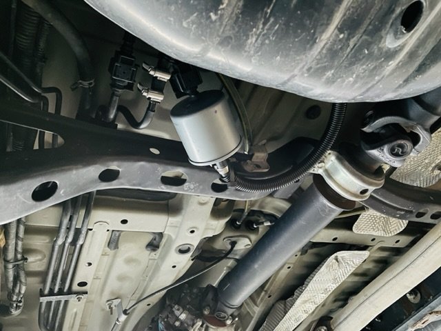

    Got the AEM 320 E85 pump in today.
    Those who have done the URD filter relocation, is this right about where you put it too?

    That makes a lot more sense, I'll swap it. Thanks @scootter82

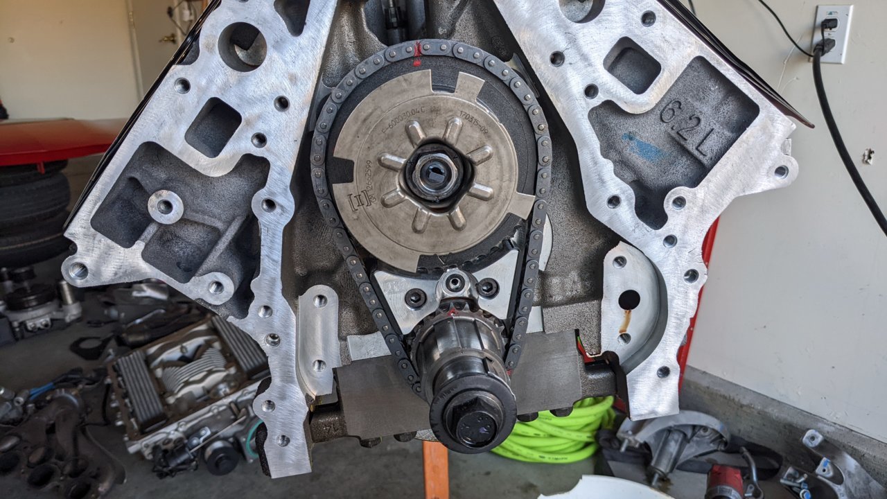

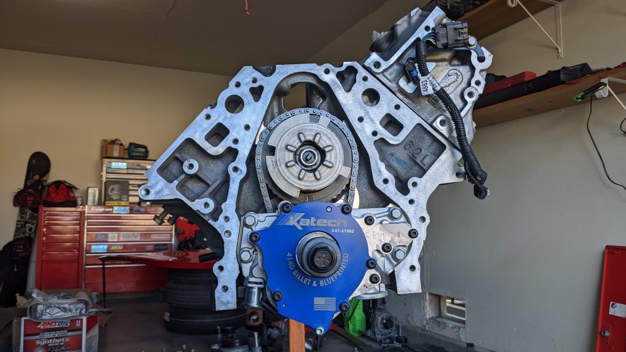

    The build finally comes to an end today. It's almost time to put this giant back into it's home!

    I agree, the LS/ LT engines look ugly as hell in factory form compared to the 1GR without a doubt. Why that is, is beyond me, but here we are. All I know is I got some new shiny billet internals and within the time of my ownership of this beast, I'll never have an issue with internal components failure again AND I won't need to ever touch the HPFP now for additional fueling.
