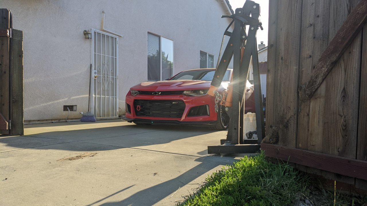

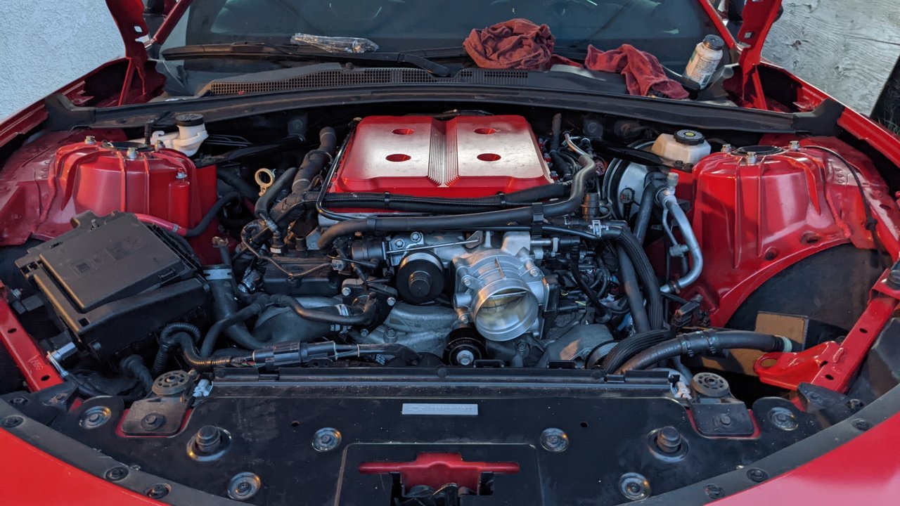

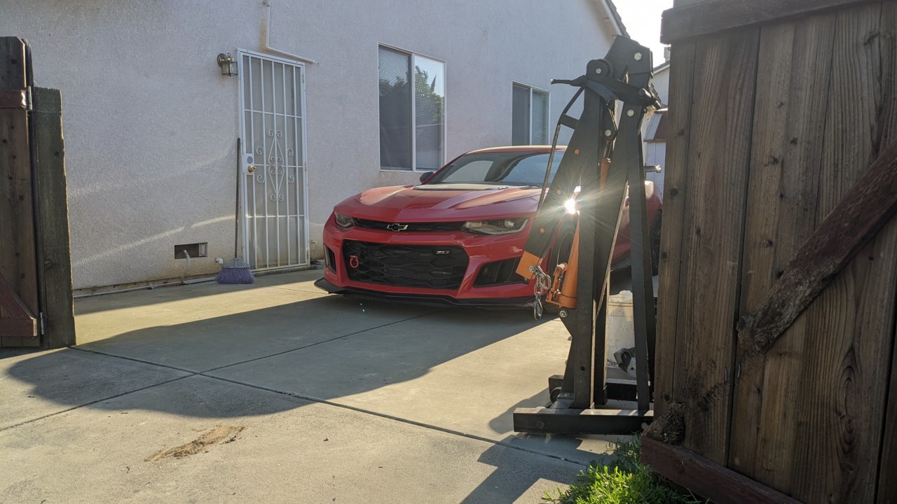

    She's all done my brothers. I fired her up yesterday and got everything all the levels correct and done up top and finished final assembly on the bottom of the car today. Sounds good, runs good, and runs STRONG already after flashing in my initial revisions to the prior tune file. The great part about it all is that we did such a clean job on the build that if you were to peek into the engine bay you wouldn't be able to tell that a full build was done on it either. :D

    I wish you were Gen V LT because damn it man I'm scratching my head over here trying to figure out how to dial in SOI on the setup. Freaking DI man.
    I wanted to do a PD cam, but after mulling it over I decided against it because of the fact I live where I do and this setup is a happy medium where it's equal to or slightly better than stock by running LT5 over LT4 cam. It has a 32% fuel lobe and is made for DOD delete. Good for if I ever need to revert to the stock tune flash file where it'll get me by for inspections and then I can reflash the juicy file.
