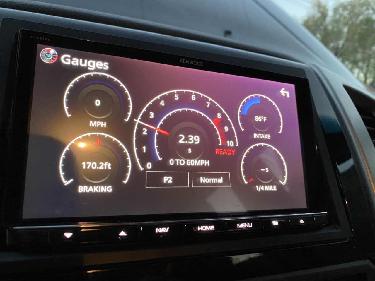

    Well obviously your flux capacitor is working tip top.
