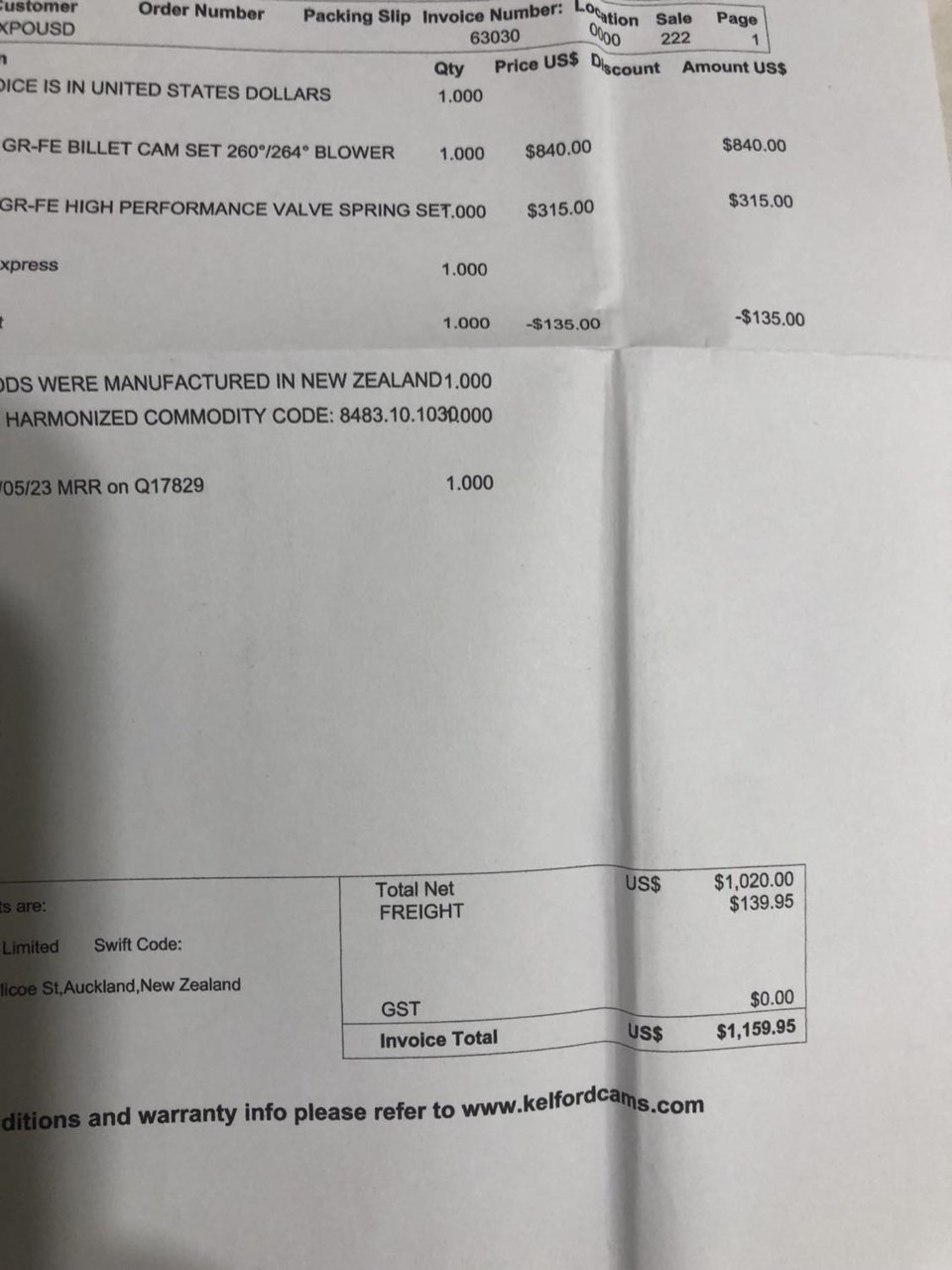

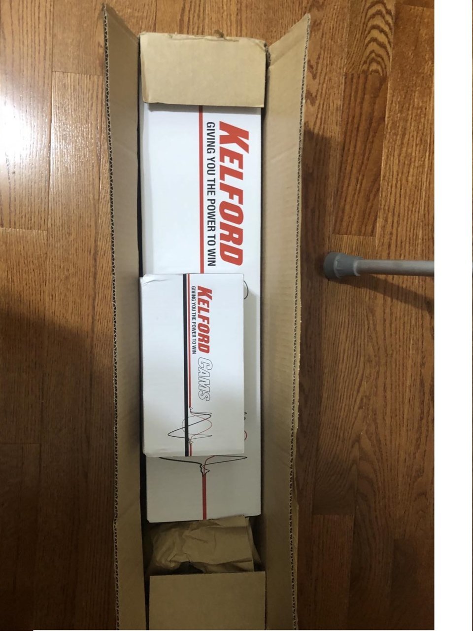

    So I bought a 1GR motor to very slowly build up into something cool. Still have to look into where I can get wet sleeves installed in Canada. Any drawbacks to a stroker crank? Any tips for what to go with @Torspd, @mightytacoman, @Lucario Runner, @12TRDTacoma, @rheath08, @o0opackersfano0o, @JustDSM and anyone else?
    Have Kelford cams and springs FIC injectors kicking around already.
    Would increased valve size be a good idea and what would be an ideal size? What's the verdict on titanium vs inconel?
