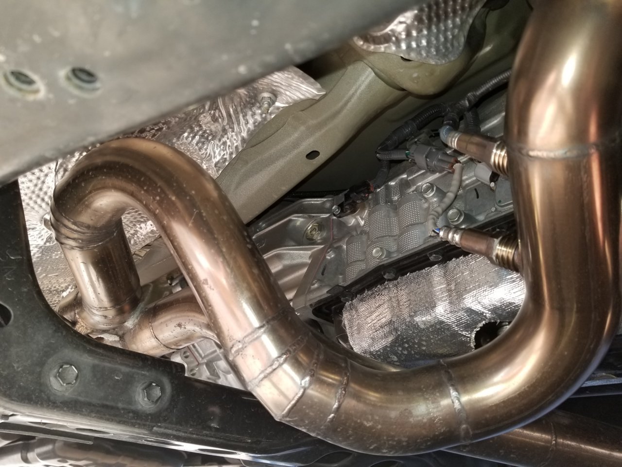

    @JuanitoBunito he has equal length headers but you cant get an equal length y-pipe.....you have to fabricate it like I did for myself and @loginfailed
    It makes the header and y-pipe act like one tuned unit. A 6 into 2 into 1 header.

    Just curious....what does that shiny ass thing cost to produce? It is nice. :thumbsup:

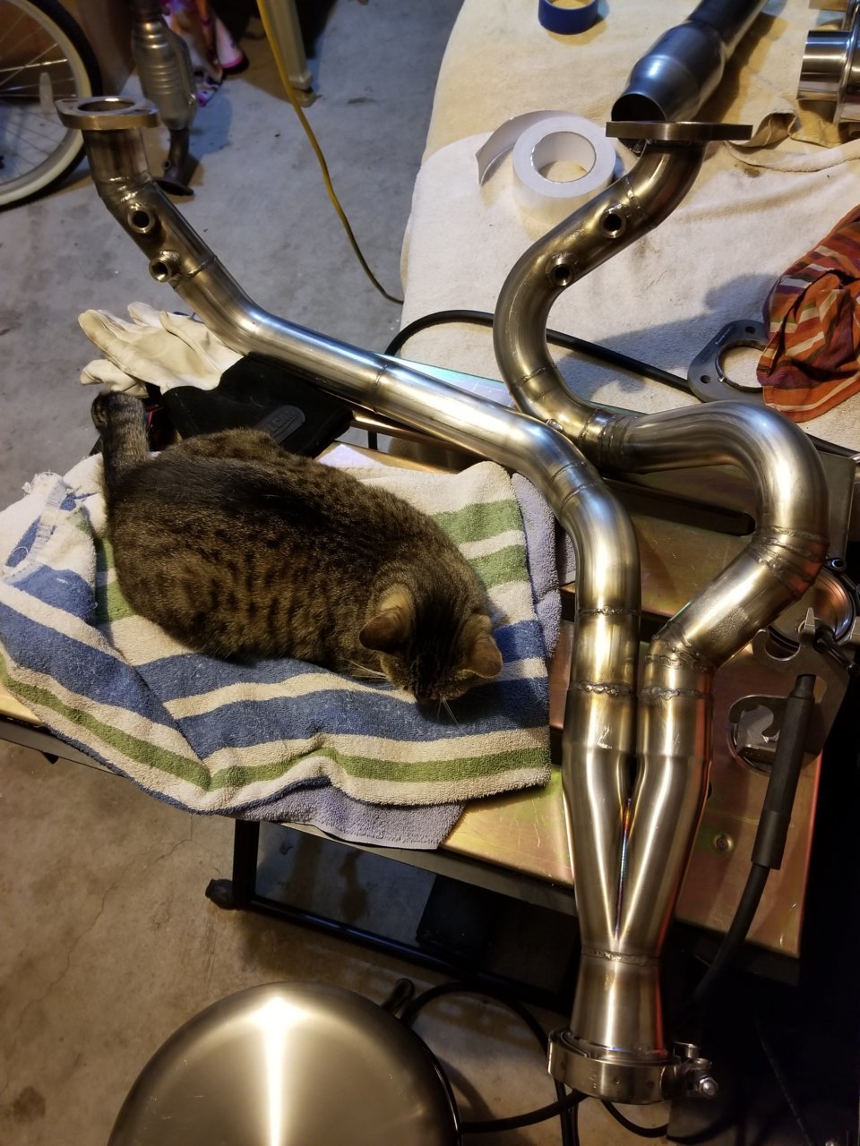

    Hard to say really. This one started as a URD y-pipe $450, that's the dark colored tubes and flanges. Just the rest of the mandrel bends probably $150 and another $85 for the merge collector.
    BUT you also have to figure welding supplies, 2 days labor, brisket, a lot of beer! The total cost gets really confusing.

    I hate quoting tig welded stainless exhaust systems. You gotta start factoring in gas for back purging, stainless flanges (hopefully of the v-band type), time spent fitting everything to perfection, and all kinds of little things. The one good thing is most people don’t go that route once they get the quote, don’t even get me started on the pie cut kids.

    I figure if I'm lucky enough to find a local guy to do it it will probably be 1200-1600. Just a guess.

    For the guys doing it for a living it goes much faster because they have all the expensive equipment, mandrel benders for the larger pieces, jigs to fit and weld it all up, etc.
    I have to do it all by hand and use the truck as I fit each bend, mark and tack it in place, then fit it back on the truck, fit next piece, etc. Then when finished both pipes have to be the same length!
    Here is the one on my truck. It was my first attempt. The second one went much smoother (and my welding is much better) as I had the shape of mine to go off of.
    As you can see, it's not a simple s bend in the pipe but continually changing angle to provide clearance and proper length. The end of each piece has to be cut and sanded flat for fitment. If there are any gaps the weld will be crap.
